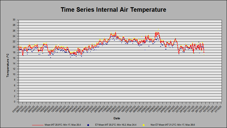

Over the last 11 months, the daily mean internal temperature has been 20.9°C (the secondary glazing fitted last year has raised my temperature about 1°C compared to previous years), the minimum has been 17°C (Jan 8 when I was away) and the maximum 25.4°C (was that heat wave, on June 24, I grew up in the tropics so don't find it excessive).
This is shown, by the red line, in the chart below.

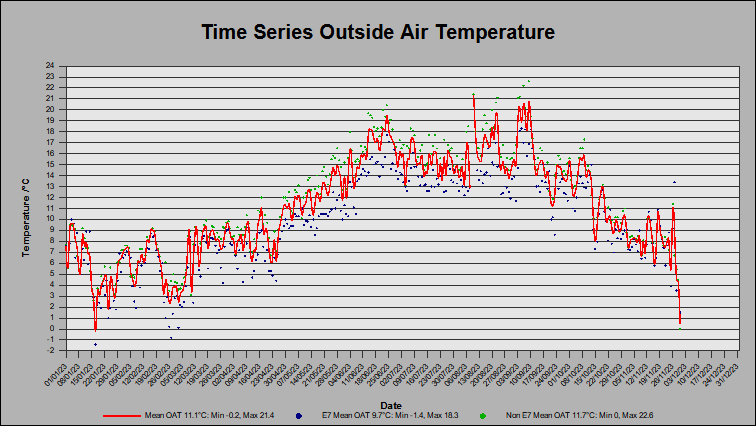

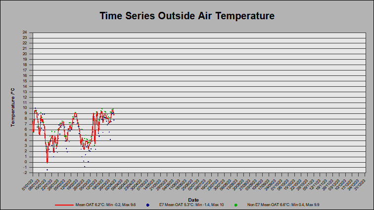

The chart below shows the outside air temperature.

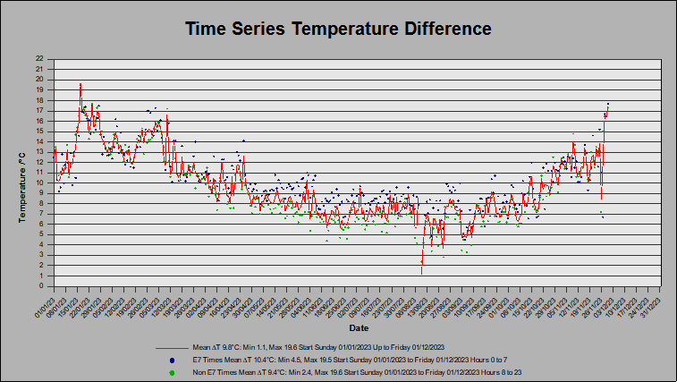

Another way to look at this is temperature differences between the internal temperature and the external temperature, again it is the red line.
You may have noticed that there are two other series on these charts.  These show the temperatures between midnight (0 hour) up to 8 AM and 8 AM to midnight.
Over the year the mean temperature difference has been 9.8°C, with a minimum difference of 1.1°C and a maximum difference of 19.6°C.
The 0 hour up to 8 AM (near enough my E7 window) mean difference is 10.4°C, minimum of 4.5°C and maximum of 19.5°C.
The non E7 times the mean temperature difference is 9.4°C, minimum of 2.4°C and maximum of 19.6°C.
Now I do not know how much of a difference the coefficient of performance is affected by, at worse, a 2.1°C difference when the mean temperature is 9.4°C (E7 window), compared to 10.4°C (non E7 window).

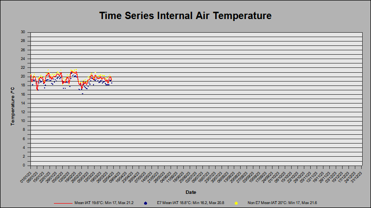

Now this year, I turned my heating off on the 1st April.  Thought that would be a laugh.

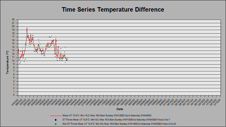

So below are the same charts adjusted to just my heating times.
Taking just the numbers from the temperature differences, which are the important ones as they show how hard a heating system needs to work.
The mean temperature difference is 13.4°C, minimum 10.2°C and maximum difference 19.6°C.
During the E7 window, the mean difference is 13.5°C, minimum 9.2°C and maximum difference 19.5°C.
Outside the E7 window, the mean difference is 13.4°C, minimum 9.5°C and maximum difference 19.6°C.
With those differences I don't believe there is anything to worry about regarding the CoP of an ASHP.

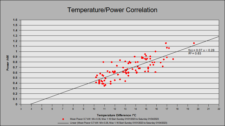

One way to try and make a universal model is to look at the energy usage over the heating period (1,463 kWh) and adjust that to floor area and see how it compares.
For my house (~50m2), for 90 days heating (and DHW/Cooking/Laundry/Lighting/etc) it works out at 0.325 kWh/m2, which is 13.5 W/m2.  I am not sure of that is good or bad to be honest.  It seems quit low to me for resistance heating.
If the above is plotted, then the correlation between temperature difference and energy usage shows that for every 1°C increase (in difference), and extra 70W of power is needed.  That is an extra 1.4 W/m2 or over the 90 days, 3 kWh/°C.

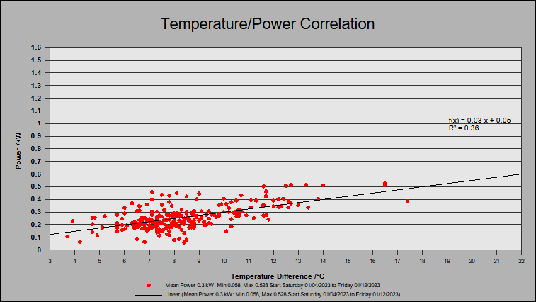

Looking at the rest of the year, to 01/12/2023 (non heating), shows that for every extra 30 W, the temperature difference increases by 1°C.
This is nonsense as it is the non heating season and the house is ventilated a lot more (windows open).  What is actually happening is that the house is at a relatively stable temperature and the OAT is varying.
What needs to be done here it the 36 W/°C (from the trend line function calculation) needs to be subtracted from the 70 W/°C trend line in the above chart.
This leaves 34 W/°C needed to heat the house.  As a power per square meter number that is 0.7 W/°C, which is very little.
The important point there is that my house is thermally stable, even though it is a timber frame.  It can 'store' enough thermal energy for short term OAT variations (just as well as Cornwall has extremely variable weather).

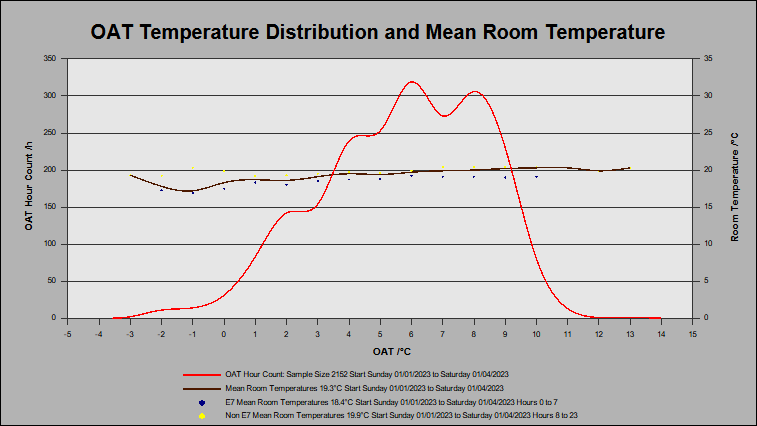

Out of the 2152 hours I have had my heating on, only 676 hours were 4°C or less (31.4%).
325 hours and I did not need heating as it was over 9°C (my mean switch on temperature) that is 15% of the time.
Of course, having storage heaters I don't have the luxury of stopping output fully, so the room temperature just rises a bit for a few hours.
Most of those few hours, the excess heating is during the day, when it is most useful and does not cause excessive heating,
My mean room temperature, when it is 4°C or below, it is 18.6°C, when it is 5°C and above, it is 20°C (which is my target temperature).

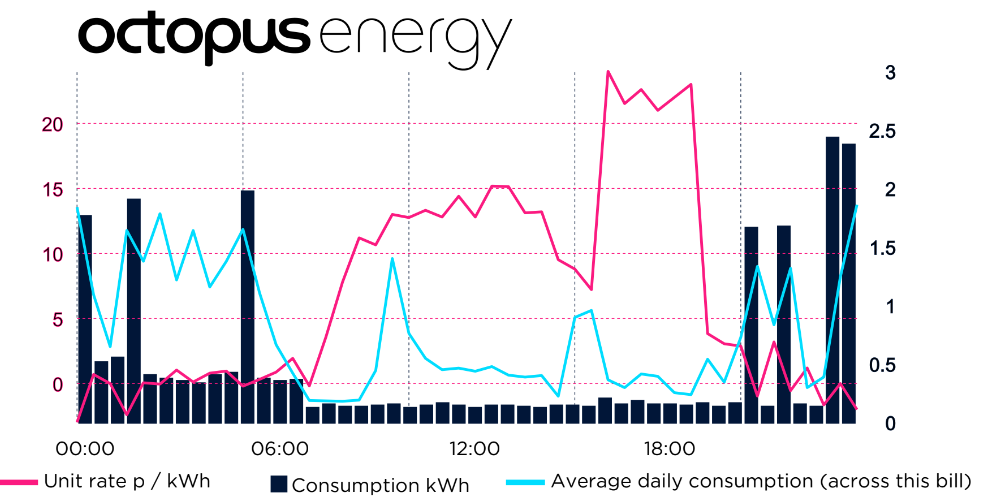

I do this type of modelling automatically at 11PM each night and then use the Octopus Agile tariff for the next 24 hours to allocate an optimum heating plan for the coming day.  So here was my Agile cost for Christmas Day.  OK, we were visiting my daughter and family  so this was a "sustain day" where the system was only maintaining the house and HW temperatures, but the 23 kWh the system used only cost me 37p.
