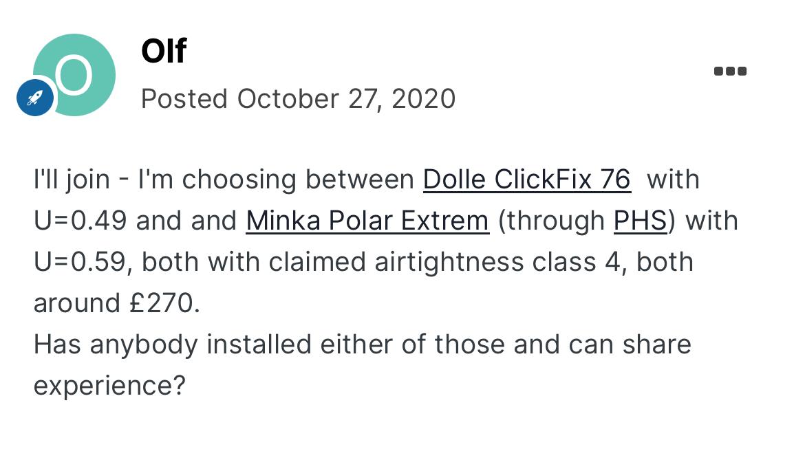

richo106 Posted December 4, 2023 Author Share Posted December 4, 2023 https://www.dolle-uk.co.uk/shop/loft-ladders-clickfix-76g Still debating just to go for this, I read on another BH post (couple of years ago) that it was tested for air tightness up to class 4) Link to comment Share on other sites More sharing options...
