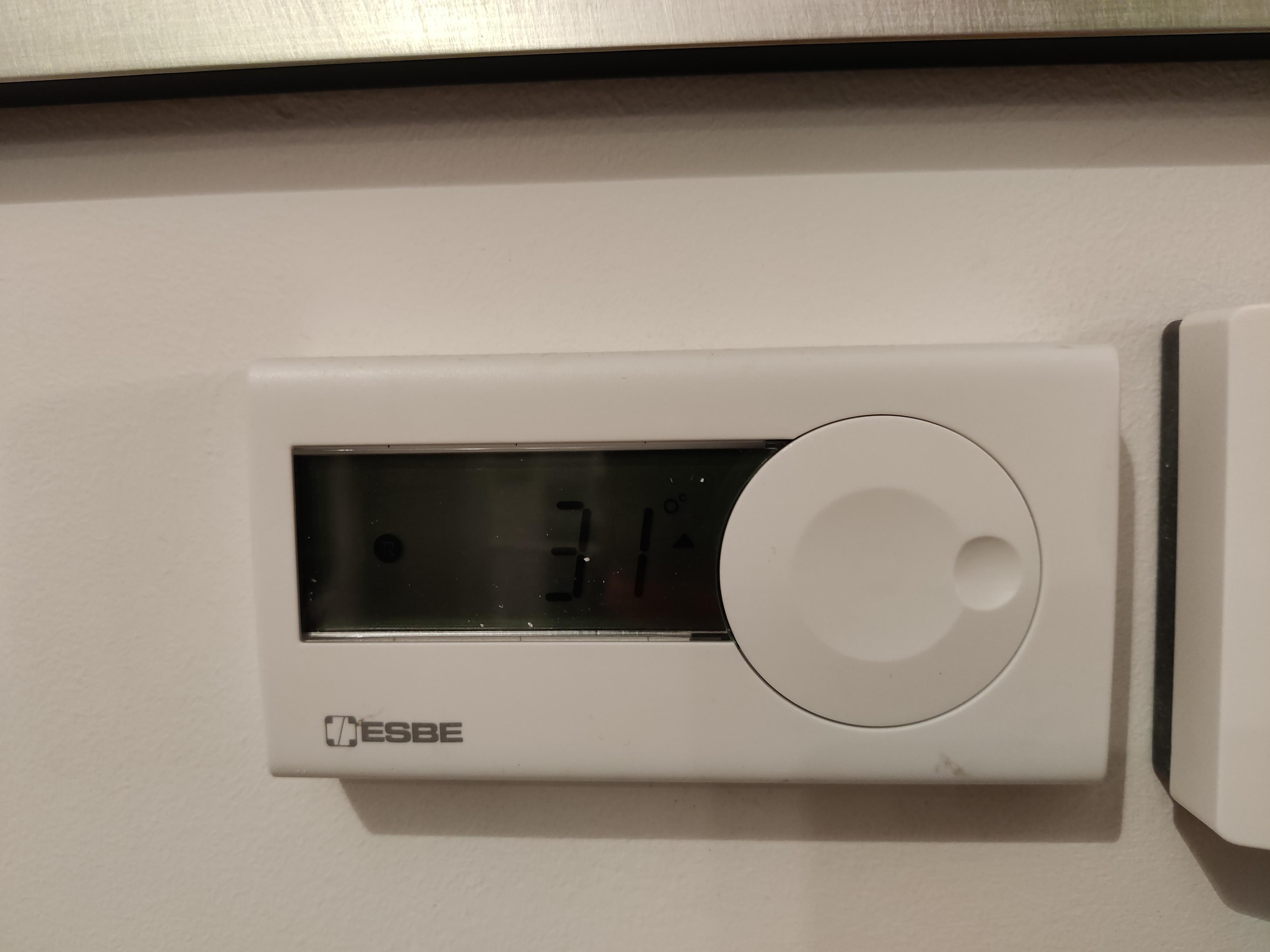

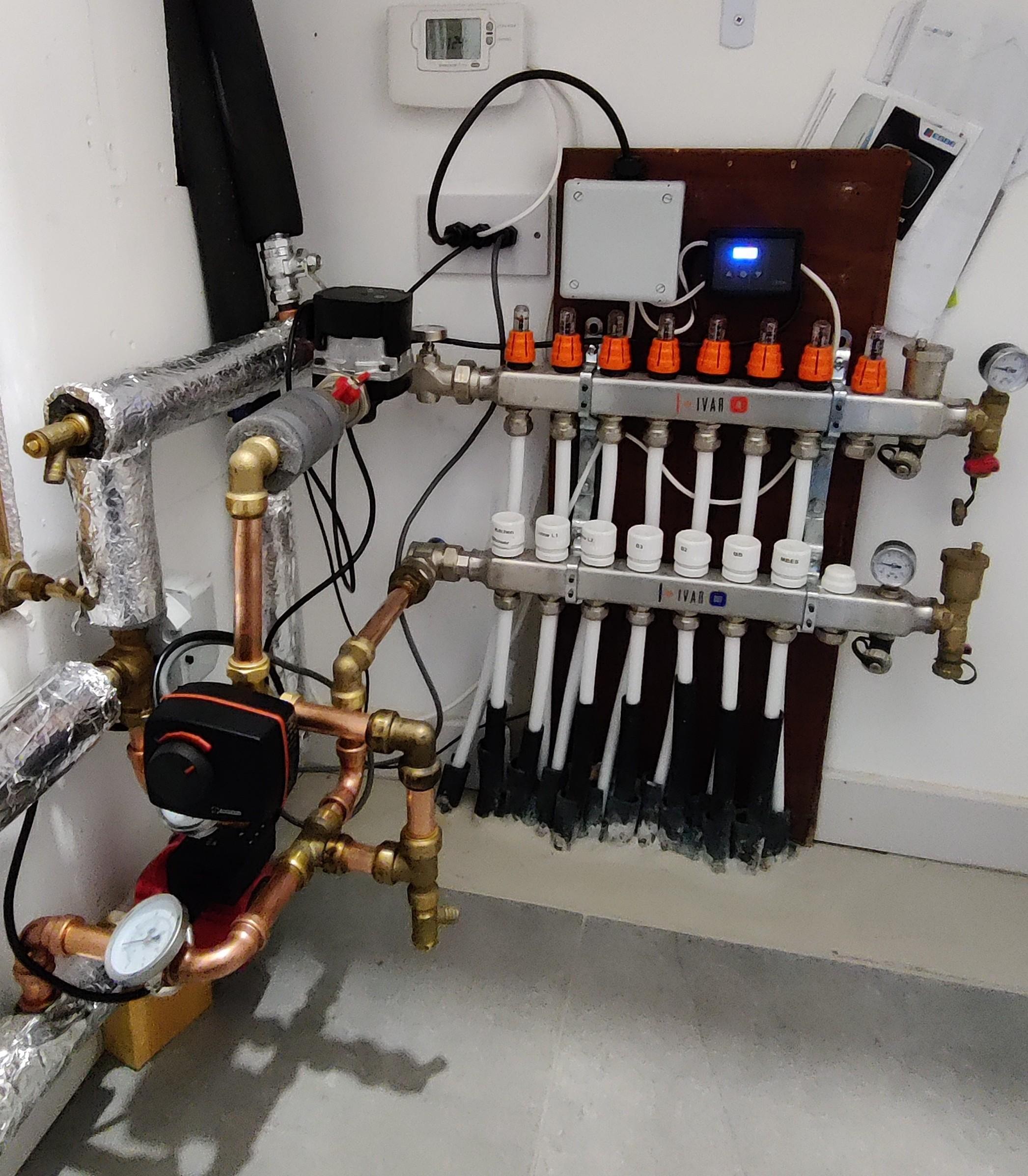

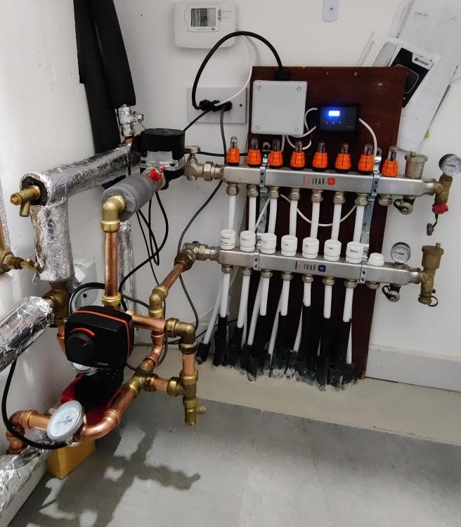

ESBE do a range of controllers that go with their 3 port valves and actuators, not cheap, I bought all mine for peanuts off eBay. Mine is set up to run on pipe flow temp mode. It has two set points (T and T2) I trigger the two different temperatures via thermostat. On a call for heat (T2) I allow it flow up to 36 degs, once thermostat senses house up to temp (T) is set to 22, it moves the 3 port to full recycle and switches off the pump.
Early image without insulation.
Interesting. So when the house is up to temp, you keep the pump running but switch off the mixer valve...? Is that something allowed by your ESBE controller or did you wire something custom to get this particular setup to work?
Basically what happens the mixer closes (goes in to full recycle mode) and a microswitch in the actuator switches the pump off. All wired as ESBE recommend. If there is a heating demand the mixer moves to allow hot water into the system, the microswitch switches on the pump.
This is the remote controller, they either come as wired or wireless. You can change settings and see what the water temp is downstream of the mixer.
ESBE do lots of variation, with subtle differences.

Nice setup John, I also have an esbe mixer wired directly into my Vaillant wiring centre working on weather compensation. Best way to control UFH
