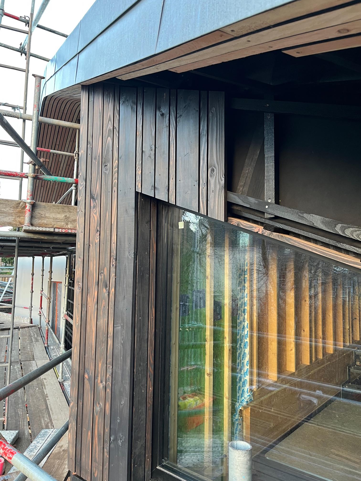

markharro Posted December 2, 2023 Posted December 2, 2023 This is just what we are doing at the moment. Not sure we are going the cheapest route mind you but pleased with how its turning out....... Top tip - you need the correct membrane at the back designed for open cladding. In the pro clima range its this one - https://www.ecologicalbuildingsystems.com/product/solitex-fronta-quattro 2
ToughButterCup Posted December 2, 2023 Posted December 2, 2023 That @markharro looks a treat ... and you've bothered to paint the battens black. Please take a photo when its finished eh?
markharro Posted December 2, 2023 Posted December 2, 2023 Thanks - yes black stained vertical battens; then planed the horizontal batten top to give a fall for rain to drip off; then those stained black; then Douglas Fir cladding stained, measured, cut and fitted. The mitre saw is paying for itself. Its taking a huge amount of time but the end result is now emerging.
ToughButterCup Posted December 3, 2023 Posted December 3, 2023 Bloody hell, much more attention to detail than me....
markharro Posted December 3, 2023 Posted December 3, 2023 Ive not finished the list yet......compound cuts with the mitre saw; special SS screws with black heads; oh and my partner's sub mm tolerances - well she has started to relent a little now thankfully!

ColdOutside Posted December 12, 2023 Author Posted December 12, 2023 On 03/12/2023 at 09:12, markharro said: Ive not finished the list yet......compound cuts with the mitre saw; special SS screws with black heads; oh and my partner's sub mm tolerances - well she has started to relent a little now thankfully! Looking at black heads too, but liking the look of this too— hidden fixings; https://www.russwood.co.uk/fixings/products/fassadenclip/ Although looks like I have to have the special cut clad to make it work.
markharro Posted December 13, 2023 Posted December 13, 2023 23 hours ago, Alan Ambrose said: Goodness I thought I was ocd... Dont blame me - it was the timber supplier's recommendation! But actually in a way it is less OCD as we have ended up not bothering too much about getting the screws level because of the camouflage
