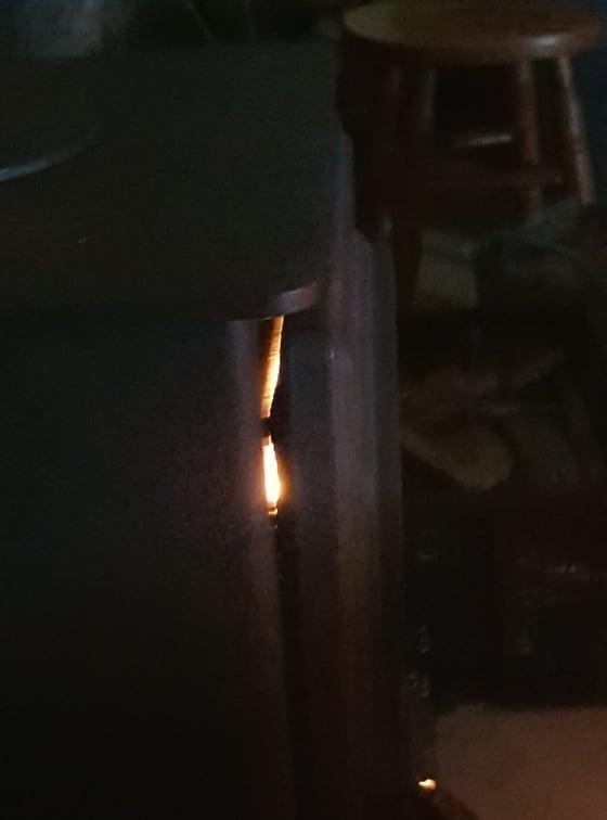

iMac23 Posted November 29, 2023 Share Posted November 29, 2023 Hi, I have replaced the rope on my stovax door but there is a gap on the top left hand side corner above handle. It should have closed it with 14mms new rope but it's a fair leak? I tightened the hinges a turn of two but didn't help. Am I doing something wrong or is it warped? It doesn't look warped. Link to comment Share on other sites More sharing options...
markc Posted November 30, 2023 Share Posted November 30, 2023 Is that the hinge or latch side? Difficult to see in the dark pic Link to comment Share on other sites More sharing options...
ProDave Posted November 30, 2023 Share Posted November 30, 2023 It looks like the rope is either not in the right place or too thin? Link to comment Share on other sites More sharing options...
ToughButterCup Posted November 30, 2023 Share Posted November 30, 2023 While you are at it may I suggest you consider getting a Carbon Monoxide sensor ? Link to comment Share on other sites More sharing options...
AndrewW Posted January 7, 2024 Share Posted January 7, 2024 Hi, I have exactly this issue too with my Stovax Stockton 5. Have you made any progress with yours? I replaced the rope yesterday (14mm, the appropriate size) and there’s a little bit of play when the door is closed, with the least tightly fitting region being the top left corner, over the handle. The handle feels loose, it doesn’t take effort to lock it like it used to. When investigating whether it was possible to adjust the handle, I noticed that replacement handle kits for sale have a spring, but I can’t see a spring on mine. Not sure if that’s relevant or not. The stove worked well enough, no smokey smells and the CO monitor remained silent. Link to comment Share on other sites More sharing options...
