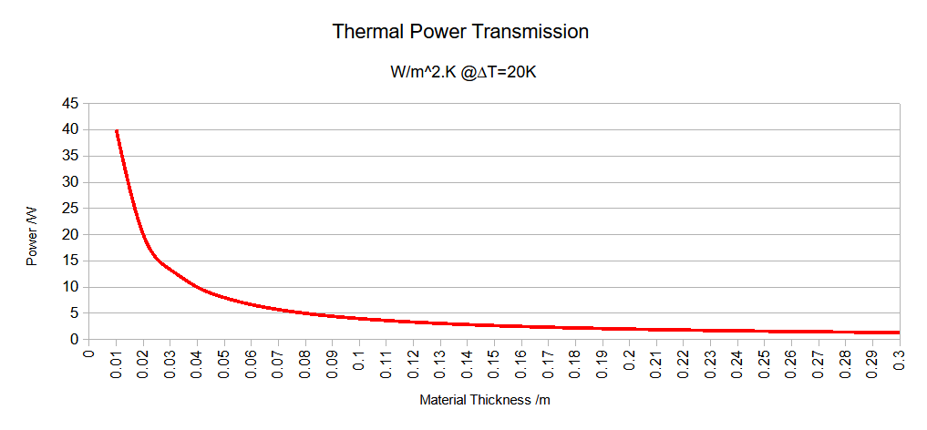

SteamyTea Posted November 28, 2023 Share Posted November 28, 2023 8 hours ago, rkrv said: They claim U value of 5 So about a tenth of the refurbishment U-Values. As the 'money' is in the fitting and finishing, consider finding a better way to do it. Phenolic sheet has a thermal conductivity of 0.02 W/m.K 8mm of that would be half the U-Value. 50mm would be 0.4 W/m2.K It is easy to misunderstand the below chart that shows the first few millimetres 'doing all the work'. You are still loosing a huge amount of energy every heating season. At a delta temperature of 20K, and a 10 m2 of wall area, the losses are, with 10mm of insulation with a U-Value of 2.5 W/m2.K, are 400 W. If your heating is on for 1000 hours (42 days) then the energy loss though the insulation is 400 kWh. Put in 50mm and that same calculation comes out at 80 kWh. A fifth of the losses. Link to comment Share on other sites More sharing options...
