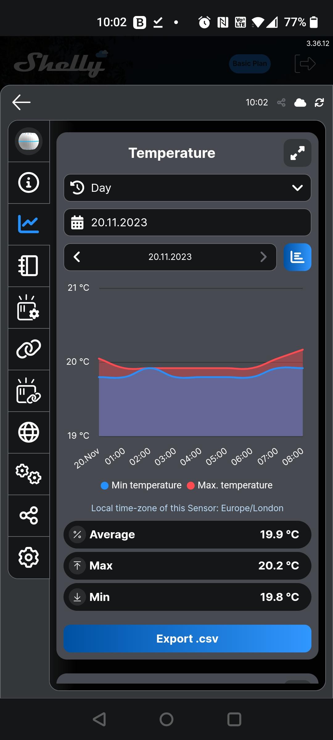

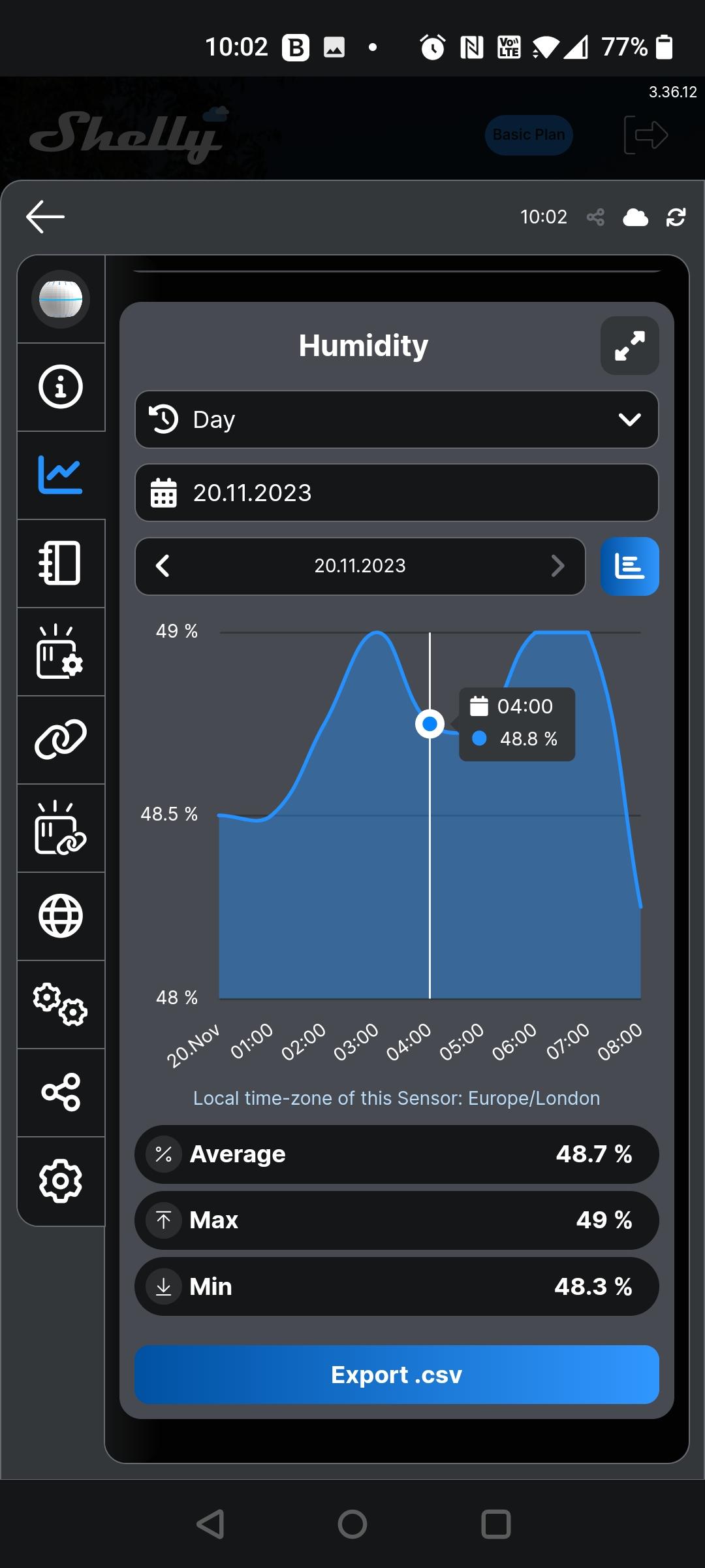

JohnMo Posted November 20, 2023 Share Posted November 20, 2023 32 minutes ago, ToughButterCup said: invested in four or five SensorPush data loggers Or Shelly H&T, currently 40% off, at Shelly store, similar output. Not sure how you get data to excel though. 1 Link to comment Share on other sites More sharing options...
Onoff Posted November 20, 2023 Share Posted November 20, 2023 https://www.builditsolar.com/Experimental/DIYHRV/DIYHRV.htm 1 Link to comment Share on other sites More sharing options...
