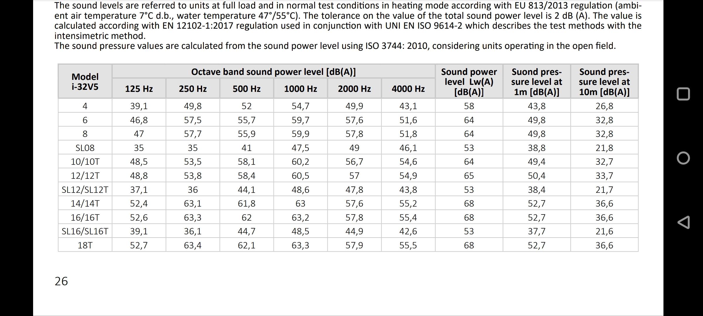

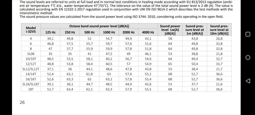

JohnMo Posted November 19, 2023 Share Posted November 19, 2023 7 minutes ago, Archer said: also because we want the option of cooling in extreme weather In another statement you made earlier you stated it was for heat only, but obviously it heat and cool like you expect from an A2A. So are you applying for full planning permission? I have attached the noise data for my A2W and it can be seen distance is your friend. A2A piping isn't that much of an issue for long distances. Link to comment Share on other sites More sharing options...
