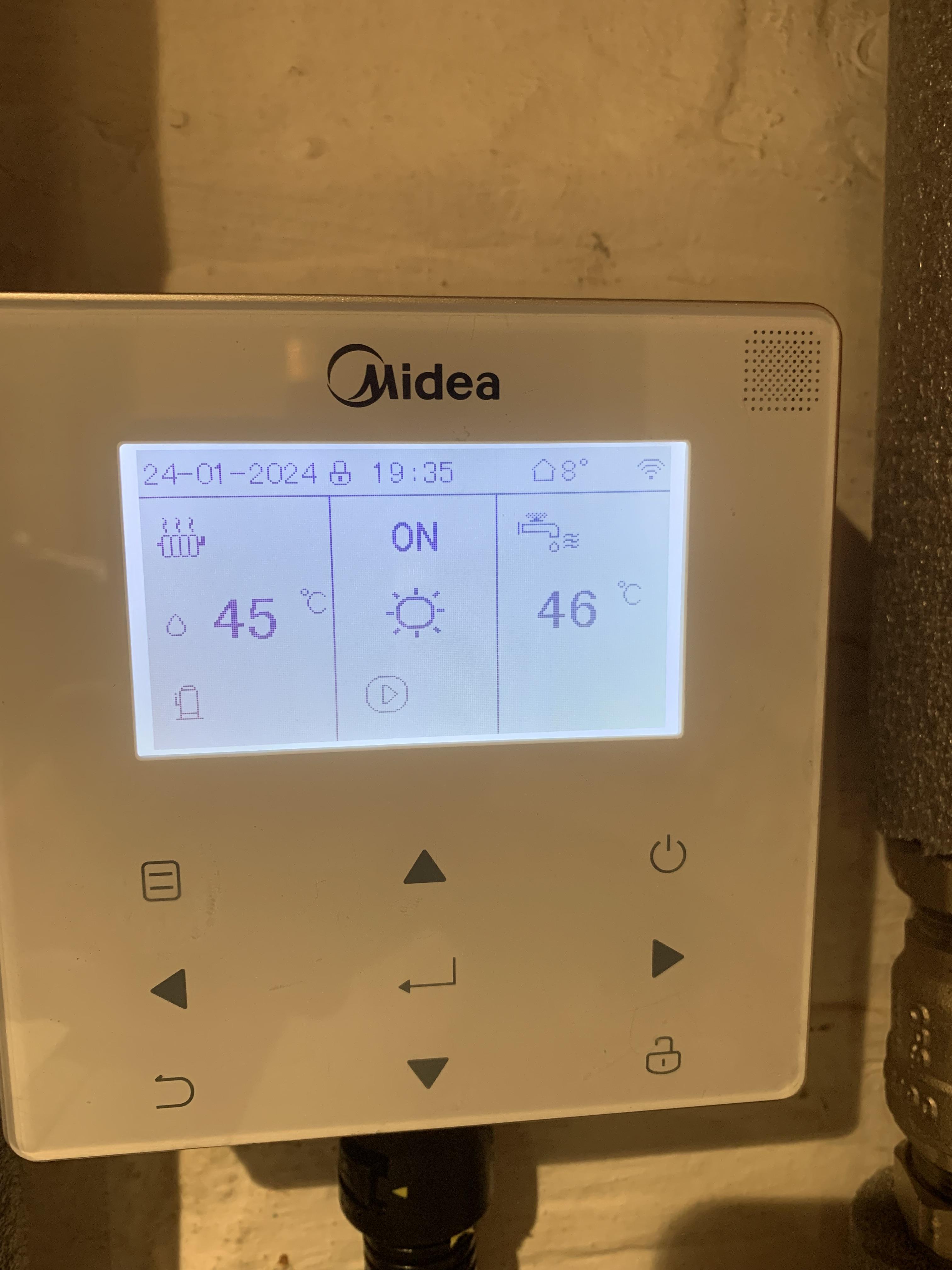

DCD83 Posted January 24, 2024 Share Posted January 24, 2024 Hi, how can I tell if the pump is working on the heating or the hot water? I was told that the hot water will stay hot in the tank and when I use it, cold water will flow in and when it drops to a certain temp (don’t know what temp) it’ll kick in and heat the water up. If I have the 3 lines on, my system seems to be heating the water 24/7 and it’s costing a fortune. If I turn off the 3 lines then the water will drop endlessly and was 8 degrees yesterday. I want it to run when it only heats up once it drops to a certain temp but I can’t figure out how to set that as it’s either heating 24/7 or not heating at all. Any help please? TIA. Link to comment Share on other sites More sharing options...

PhilT Posted January 25, 2024 Share Posted January 25, 2024 16 hours ago, DCD83 said: Hi, how can I tell if the pump is working on the heating or the hot water? I want it to run when it only heats up once it drops to a certain temp but I can’t figure out how to set that as it’s either heating 24/7 or not heating at all. Any help please? TIA. Your photo shows that your heat pump is currently heating your radiators (heat pump symbol bottom left). Hot water is "on" but in standby mode. There are several YouTube videos showing how to use this controller. There is one about the hot water timer - you could use that instead of leaving it on 24/7, that's what I believe most people do. Link to comment Share on other sites More sharing options...
JohnMo Posted January 25, 2024 Share Posted January 25, 2024 Are you sure you don't have a mid point valve/actuator instead of a diverter? Link to comment Share on other sites More sharing options...
DCD83 Posted January 25, 2024 Share Posted January 25, 2024 Okay, but why does my hot water either stay at the temp I set it to ie 46 degrees if I leave the hot water on, and then if I turn it off then it just continues to drop endlessly to 0. To get the hot water to kick in and heat back up if it drops a bit, do I need to leave the hot water on or turn it off? Sorry if that’s not clear but basically my water either stays at the set temp all the time or the only other setting I’ve found is to turn the water off but then it never heats up and will drop to 0. What I want is a middle ground where it heats up to say 46 and then drops as the tank gets cooler over several hours and then when it gets to say 26 I want it to kick in a heat back up to 46. I can’t figure out how to set this or whether I need to leave the DHW powered on in the app or switch it off in the app? Either way that never happens. Link to comment Share on other sites More sharing options...
sharpener Posted January 25, 2024 Share Posted January 25, 2024 Perhaps as a result of some misconnection the tank is losing heat to the central heating circuit(s)? Maybe that's what @JohnMo was implying. Link to comment Share on other sites More sharing options...
Beelbeebub Posted January 26, 2024 Share Posted January 26, 2024 As pointed out before, if there is a fault with the diverter valve setup so that there is flow through the tank coil during heating mode, the hotter water in the tank will be cooled by the water passing through that coil at the cooler heating flow temp. Symptoms would be Your tank swiftly loses temp only when the heating flow is on. The return flow out of the tank coil (usually the lower pipe) is warmer than the feed flow in (usually the upper pipe) If your controller is set to hot water priority it will start heating the house, then notice the tank has cooled, switch to heating the tank, then go back to heating the house, then notice the tank had cooled.... And so on. Try setting your hot water to timed. At this point the above won't happen outside of the hot water times but you would quickly see the tank temp drop to the heating flow temp and then stay there. If there is not a diverter fault then another possibility is the tank is losing temp naturally. Because the prove is at the bottom it can only "see" the temp there. As the tank loses temp naturally the cooler water sinks to the bottom. Your probe will "see" cool water but be unable to know the water above is still hot. My tank can be half full of 65C water and the bottom be at 20C (I have multiple sensors). Again, if your hot water us set 24/7 it wouldn't take much demand or cooling to trigger another heating cycle even though there is ample hot water left Link to comment Share on other sites More sharing options...
HughF Posted January 27, 2024 Share Posted January 27, 2024 The midea will say ‘on dhw’ in the middle when it is doing hot water reheat. I can’t find what the setpoint is for a dhw reheat in any of GH’s videos, but suspect it to be 10-12 degrees. When it’s heating radiators it will just say ‘on’ in the middle…. Link to comment Share on other sites More sharing options...
