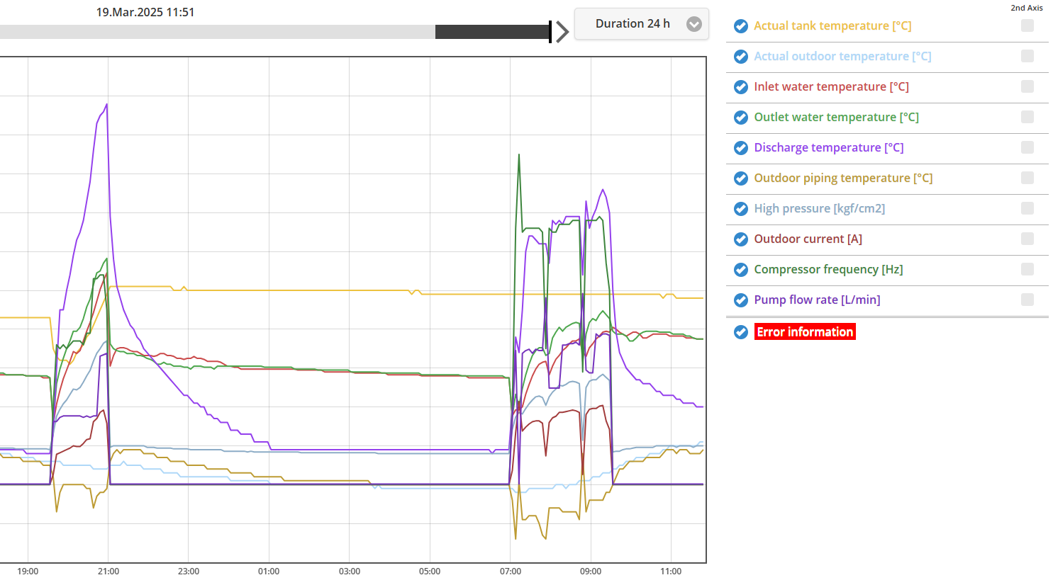

gmarshall Posted November 8, 2023 Share Posted November 8, 2023 The service cloud is what you want- more data than you could ever wish for in there! Just follow the sign up link from this page https://aquarea-service.panasonic.com/ 1 Link to comment Share on other sites More sharing options...
Triassic Posted November 10, 2023 Author Share Posted November 10, 2023 On 08/11/2023 at 22:16, gmarshall said: The service cloud is what you want- more data than you could ever wish for in there! Just follow the sign up link from this page https://aquarea-service.panasonic.com/ His there an App for do I have to log onto the Cloud every time I want to look at the data? Link to comment Share on other sites More sharing options...
gmarshall Posted November 11, 2023 Share Posted November 11, 2023 I don't think there is an app- I usually acces it via my laptop as the graphs are so detailed they are hard to read on a phone Link to comment Share on other sites More sharing options...

gmarshall Posted September 30 Share Posted September 30 Yes, the installer service cloud (which anyone can register for) is what gives you COP (and lots of other) data. The user login is basic controls only with no data- although it does integrate with home assistant relatively nicely. 1 Link to comment Share on other sites More sharing options...
