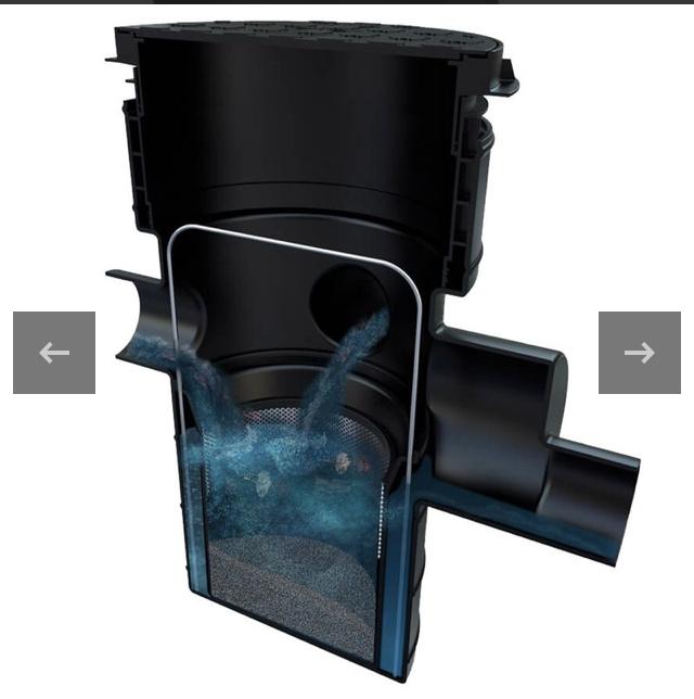

Russdl Posted November 6, 2023 Share Posted November 6, 2023 (edited) We fitted a silt trap in the pipe run to the soakaway. Works well, I empty the silt trap every quarter or so. I’ll find a link… https://www.drainagesuperstore.co.uk/product/silt-sentinel-300-series-1000mm-deep-catchpit-vertical-silt-trap.html Edited November 6, 2023 by Russdl Link to comment Share on other sites More sharing options...

saveasteading Posted November 6, 2023 Share Posted November 6, 2023 I can't comment on that product without seeing it working. Generally foreign stuff doesn't work for UK rain, especially in the old days when we had drizzle. Absolutely right, that leaves should not reach a soakaway, or it will become a compost heap, and block. Neither should they go into storm drains, simply as good practice. I've experimented and my opinion is this: Don't fit gutter guards whether hedgehog fillers or wire mesh over. They do keep leaves out of the gutter but then they break down and become a stinking mass and thd gutters don't work. Don't fit gutter outlet guards for much the same reason, unless it is very easy and safe to access and clear regularly. Do fit a gully with grating at ground level, with the dp stopping a hands width above to allow easy clearing. An oversized grating helps. OR take the dp down to the grating bug cut out a mouse hole for getting leaves out. A silt trap works well too. But it needs a stilling chamber. I use a biggish chamber and put a bulkhead across the middle. I asked our worst bricklayer to build a brick wall and then the poor joints let water through with no leaves. More formally, make the bulkhead from expanded metal. Sticks and leaves float to the top, silt and so on sinks. Inlet and outlet at half depth. 1 Link to comment Share on other sites More sharing options...
