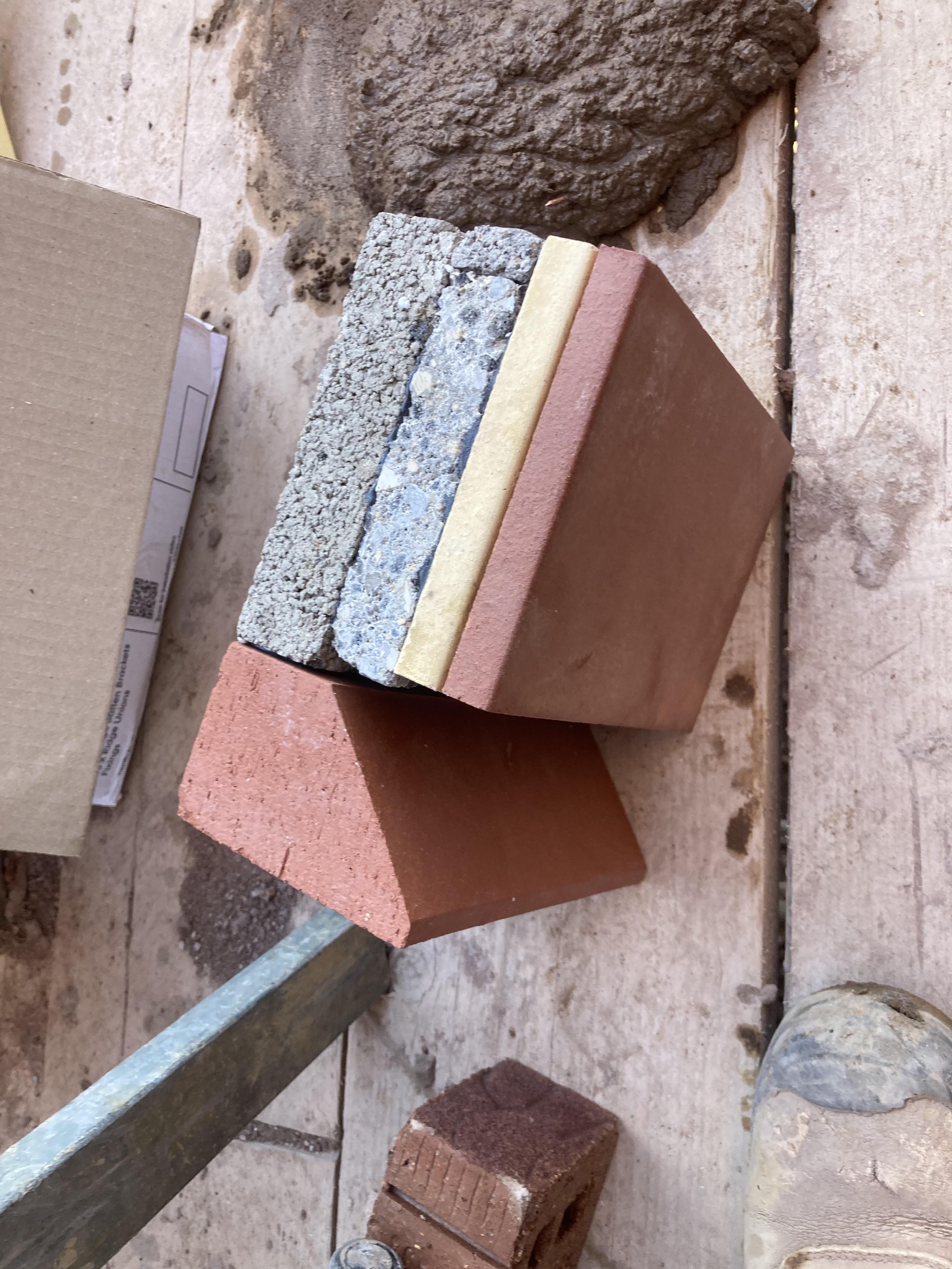

Ohhh grrrrrr if I wasn't already riled at the cost of Alutrix 600 my bat boxes arrived today. I am in the wrong game for sure. 1 x Plinth brick £2.20 a tile £1.20 2 shitty bits of concrete £0.50 and some glue. Add that all together and it comes to £160  The world has gone bat shit crazy.
I agree, luckily my ecologist was very reasonable and allowed me to build bat boxes myself into my garage to their basic design (left over ply etc), also when I won the planning appeal the  officer told the planners they were not qualified to overrule the ecologist and insist bat boxes were also installed in the house 👍.
