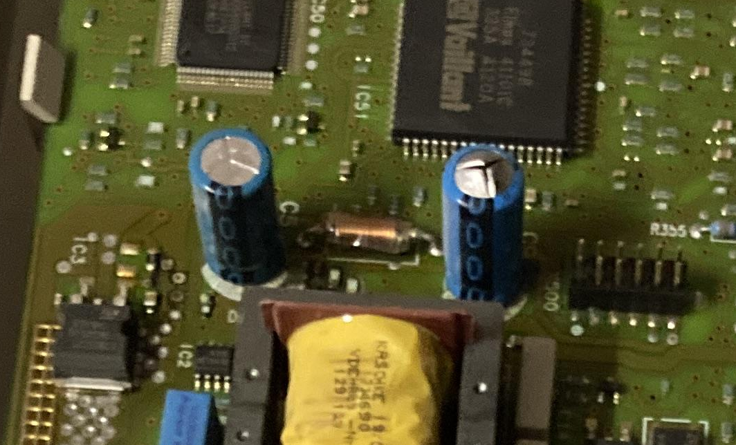

jfb Posted November 2, 2023 Share Posted November 2, 2023 (edited) My Vailant ecomax 828/2 E boiler has decided to not turn on any more. turn the on switch and no display and no firing up. Switch appears to do something as the voltage detector lights up in the picture when the switch is on but not when it is off. What would next step be? just replace the whole board? bit confused most replacement boards seem to cost £250ish but this here appears to be £35! https://www.heatingandcateringparts.com/product/vaillant-ecomax-824-828-835-e-pcb-711949-711950-734678-genuine/?gclid=CjwKCAjwkY2qBhBDEiwAoQXK5RpdtYwRR67RgXrRoexafdtI698Wf4yDEJrTipeVSzXC-3ZNJ93H3hoCe_QQAvD_BwE Edited November 2, 2023 by jfb Link to comment Share on other sites More sharing options...
Temp Posted November 3, 2023 Share Posted November 3, 2023 New vs used? Link to comment Share on other sites More sharing options...
Temp Posted November 3, 2023 Share Posted November 3, 2023 You have at least one blown capacitor on your PCB. Link to comment Share on other sites More sharing options...
ProDave Posted November 3, 2023 Share Posted November 3, 2023 That looks to be a capacitor in the output circuit of a switching power supply. By the time it gets that bad, it has usually blown something else, but if you have a soldering iron and feel lucky you could try replacing the light blue one with the top split open. That £35 one is a "refurbished" used one. It has a 12 month warranty, but if I bought that I would look at the soldering of the electrolytic capacitors and any that had not been replaced already I would replace with good quality replacements. 1 Link to comment Share on other sites More sharing options...
Temp Posted November 3, 2023 Share Posted November 3, 2023 Quite nicely popped. The ones I've had fail on other kit usually just bulge up a bit. Link to comment Share on other sites More sharing options...
jfb Posted November 5, 2023 Author Share Posted November 5, 2023 Blimey - didn’t see all the replies before ordering a reconditioned board. Arrived last night and fitted this morning and all seems to work! let’s hope it continues for a while! thanks for the replies Link to comment Share on other sites More sharing options...
