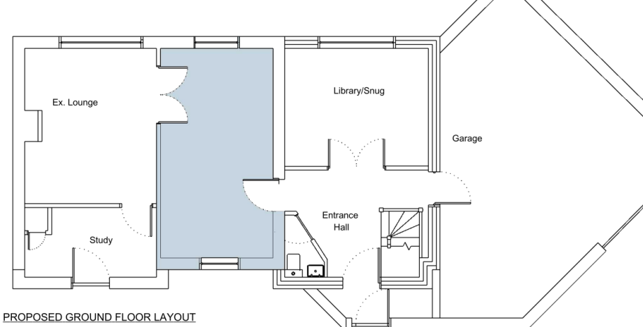

The library/Entrance  -4mx6m-  is going to have 200mm insulation with a 150mm concrete slab.
The existing lounge and kitchen (shaded blue) will be dug out and UFH put in later, so I want to prepare for that now.
1. How deep into the concrete below ffl should the ufh be set?    I was thinking 50mm

    (internal garage door is not being built in, internal wc not being built either)

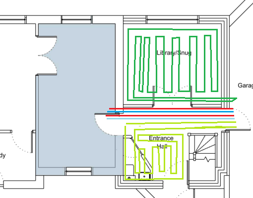

5. Will it be okay run 6 pipes for the future existing house ufh and just cap them off in the kitchen like red/blue lines below?
     even though it's going to be approx. 15mths before the rest of the ufh is built in.
6. what method should I use when passing ufh pipe under walls?

Have you any UFH pipework down across the ground floor? If so, then why not follow what already has been done?
If not, then perhaps try to secure an UFH plan ahead of the screed being poured because surely, once that is poured your oppurtinty to have UFH has been missed, unless you go for an electric system. By securing such a plan, a lot of your questions should be answered therein.

A little confused, why is the UFH manifold looking like it's in the garage?
Assuming the 150mm slab is reinforced, if so attach the UFH heating pipes to the reinforcing mesh. Do the pipe in 16mm pert-al-pert pipe. Centres really depend on the overall W/m2 you need to generate, do you know?

Can you not take pipe through doorways?

Im building an extension, the green loops are very rough examples of  what/where i need to put ufh in the slab.

 The manifold is in the garage,as that's where the ashp/cylinder "plant room" will be.
