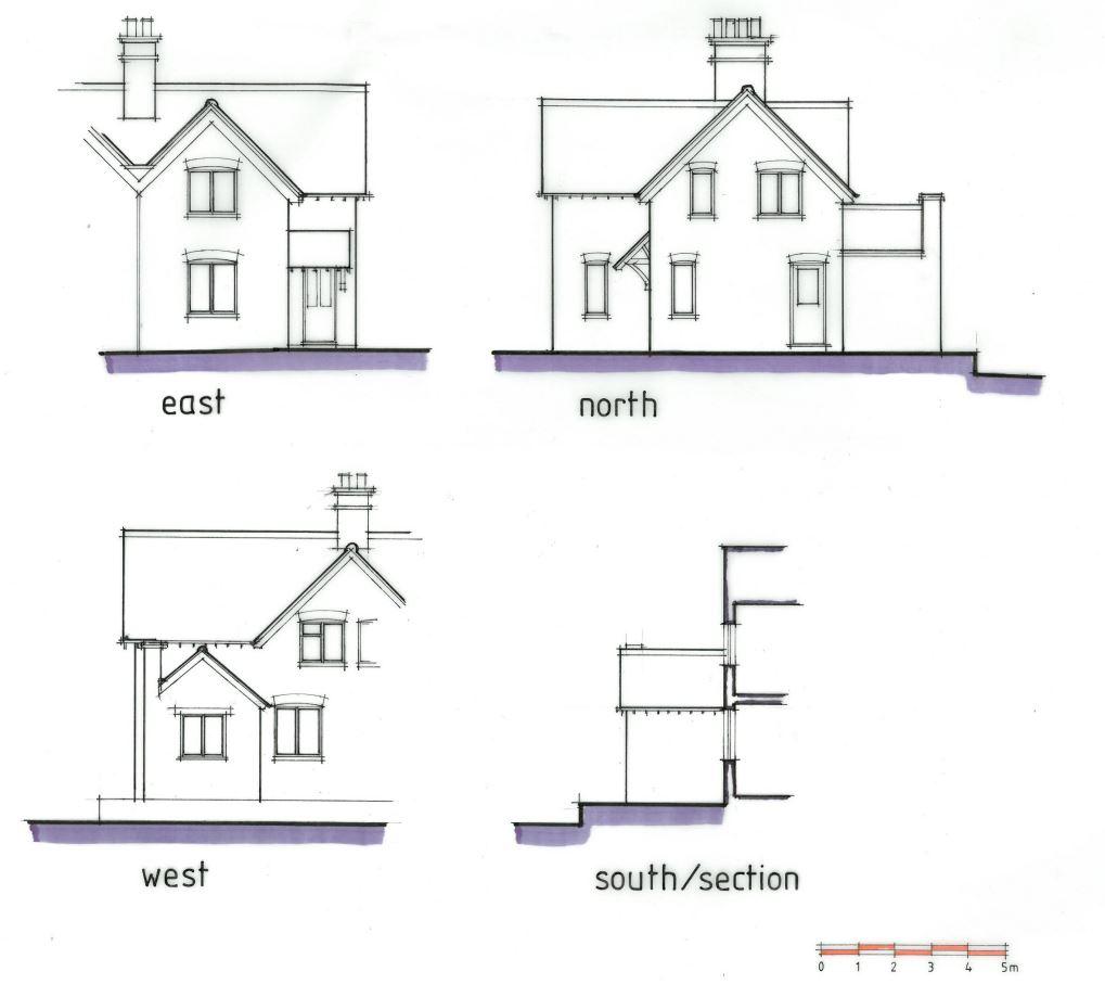

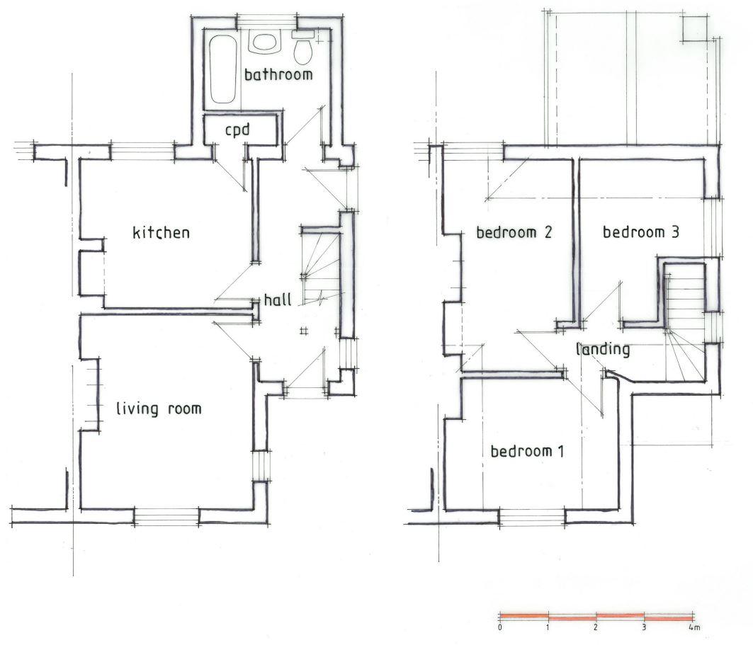

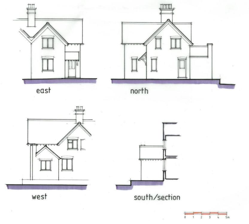

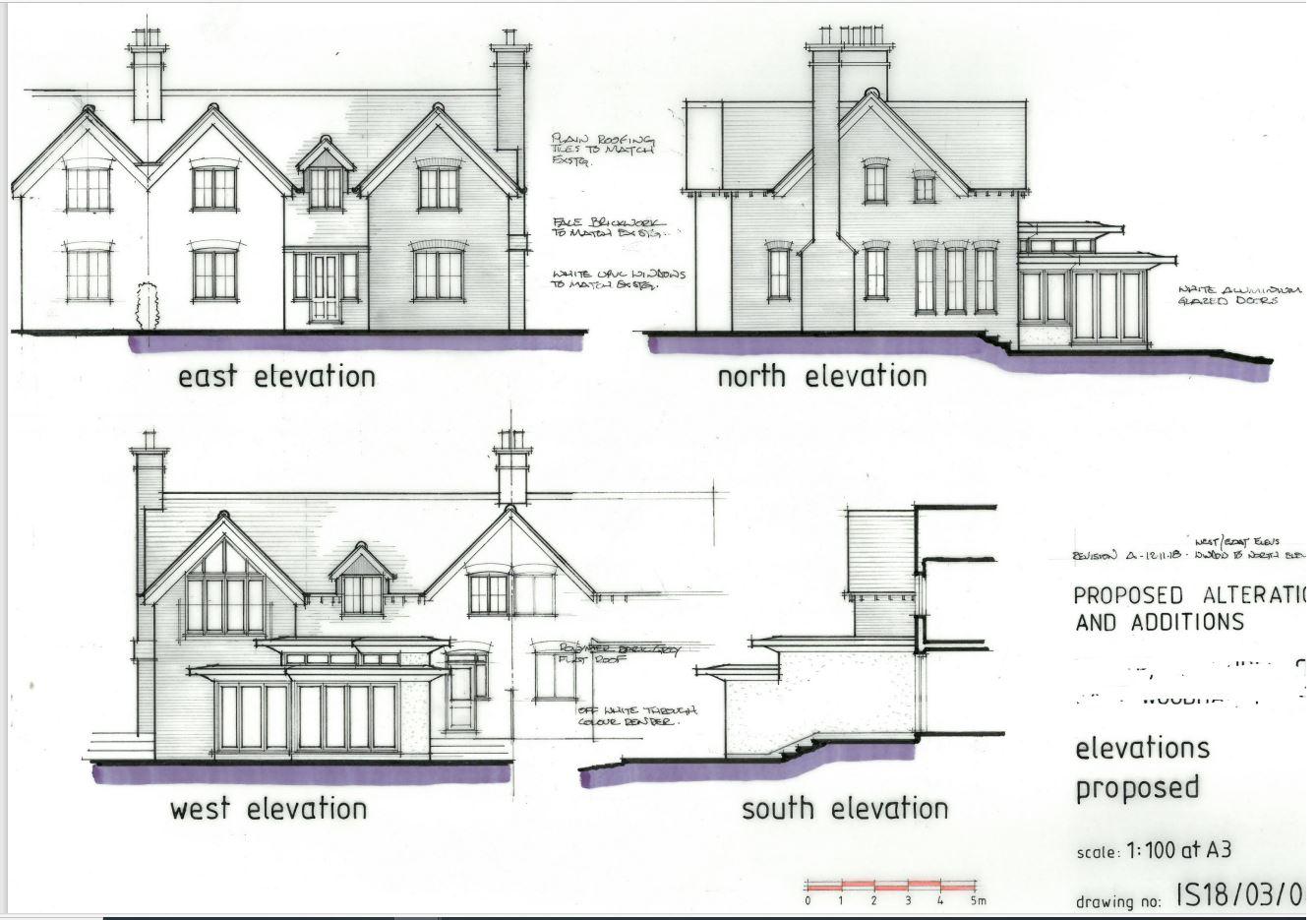

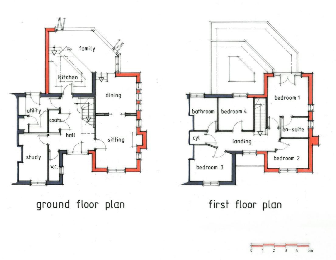

flanagaj Posted October 25, 2023 Share Posted October 25, 2023 (edited) We are looking to do the same as the below on the property next door. Existing property will also require total refurb and is basically a shell. I will do all aspects of the second fix myself, but not sure I have the time or want to risk the delays of doing first fix jobs. I was hoping that we could achieve it for 200k, but I am getting nervous now, as I actually have no idea. If anyone can provide any guide or know where I could potentially pay a few quid to get a good idea, then please let me know. image 1 - existing floor plan image 2 - existing elevations image 3 - proposed floor plan image 4 - proposed elevations It's about 100m2 Thanks Edited October 25, 2023 by flanagaj Link to comment Share on other sites More sharing options...

flanagaj Posted October 28, 2023 Author Share Posted October 28, 2023 11 hours ago, Buzz said: How many m2 is the ground floor and how many m2 the top? Two storey extension is total 96m2 (48m2 lower + 48m2 upper) and there is a 24m2 section of just single storey which adjoins to the side of the main extension. It's basically a 12m * 4m two storey and a 6m * 4m side. Link to comment Share on other sites More sharing options...
Conor Posted October 28, 2023 Share Posted October 28, 2023 3 minutes ago, flanagaj said: Two storey extension is total 96m2 (48m2 lower + 48m2 upper) and there is a 24m2 section of just single storey which adjoins to the side of the main extension. It's basically a 12m * 4m two storey and a 6m * 4m side. Id allow £2k/m² for the new bits plus £1k for the rest of the house. Think you're looking in the £300k ballpark. Budget kitchens and bathrooms etc will go someway to keep this lower, but hard to reduce the core construction costs. 1 Link to comment Share on other sites More sharing options...
Buzz Posted October 28, 2023 Share Posted October 28, 2023 50 minutes ago, flanagaj said: Two storey extension is total 96m2 (48m2 lower + 48m2 upper) and there is a 24m2 section of just single storey which adjoins to the side of the main extension. It's basically a 12m * 4m two storey and a 6m * 4m side. @flanagajat fist glance it appears that the architect has been very sensible in not removing any of the exterior walls which will save £££ . You have already said you only want a shell so and you want to keep the costs down so I would be getting quotes for the groundwork, bricks and blocks from a general builder including knocking through and making good,the roof and window quotes. This will give you a ballpark number to work off and see if it's feasible financially for you. You already have some numbers above what others think it will cost but the only way to know for sure is to get the numbers for your project in front of you . The numbers for our build come with a big false hope alarm attached to them, our shell which sits on a 300m2 foundation and has 120m2 room in roof space ,including the roof tiles and roof lights all the glass and doors and both drainage systems came in at less than 200k . 1 Link to comment Share on other sites More sharing options...
