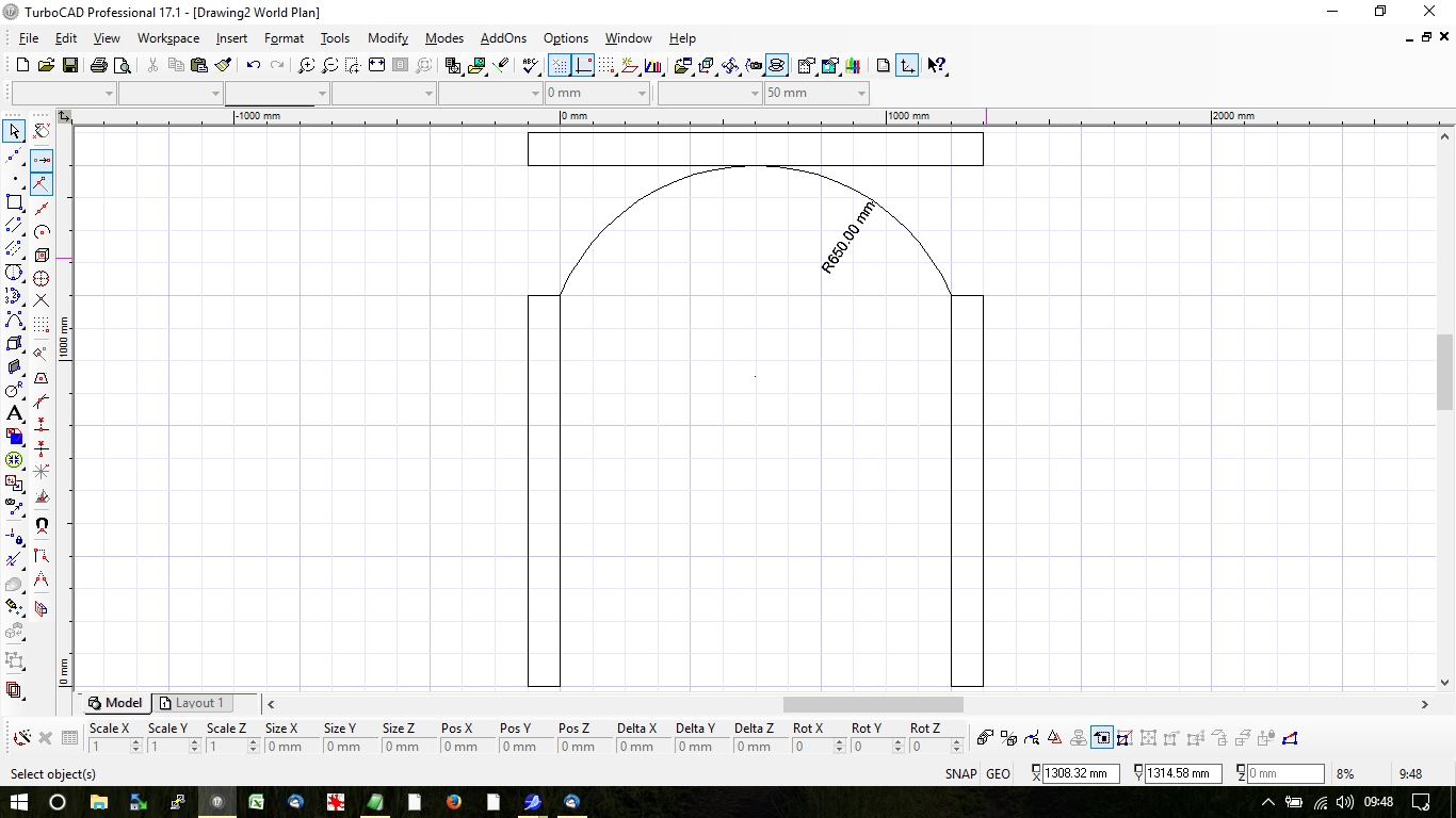

Does anyone happen to know the formula for calculating the radius of an arch armed with just the span & the rise?
I know I learned it at college but damned if I can remember!
The arch former forms a segment,I suppose?
I have an online calculator,just wondered if anyone knew in case I ever need to do it where there's no mobile signal!
The link i gave above has the formula.
I couldn't get that to work but the equation seems ok for the trivial case of H = 1, W = 2
