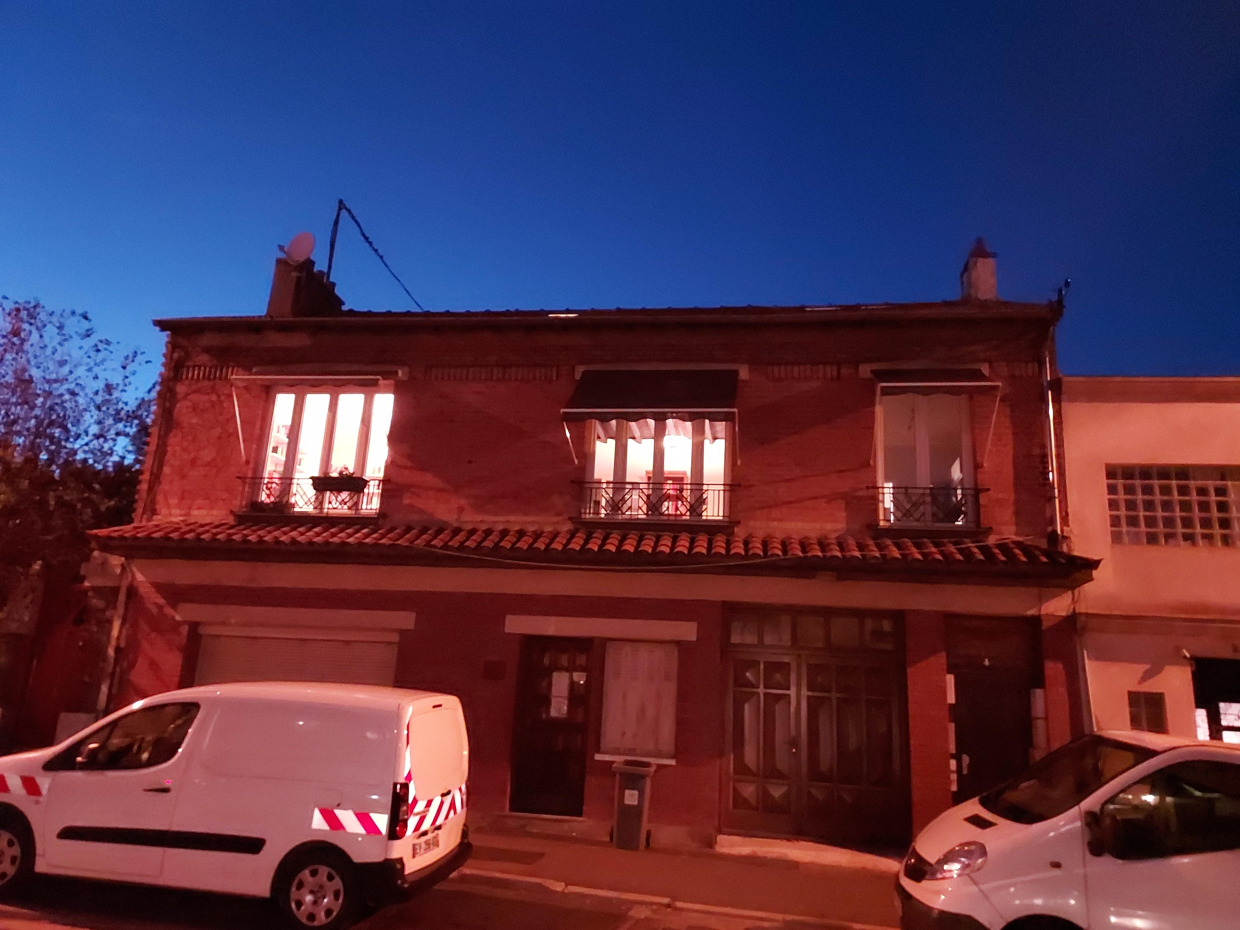

Garald Posted October 18, 2023 Share Posted October 18, 2023 The shutters I thought I'd get for the street-side windows haven't arrived - it turns out the contractor took forever to order them, and now the factory says it's out of parts. The contractor is proposing roller shutters, adducing that they provide heat and sound insulation, and other kinds of shutters would provide virtually none. I can easily believe that most shutters of a traditional kind provide little heat and sound insulation - I mean, there are spaces between the rails in a shutter panel. But are there shutters that provide about as much sound and heat insulation without being a roller shutter? Sound insulation is a priority - and I simply do not like what roller shutters look like. Link to comment Share on other sites More sharing options...

Garald Posted October 19, 2023 Author Share Posted October 19, 2023 (edited) 16 minutes ago, Marvin said: Hi @Garald I assume you own little land between your window and the source of the noise. If it's vehicular noise is it airborne or impact or both? Uh... I own flowerpots? And there is a sidewalk? The noise is airborne - at least the noise that bothers me. There's a little bit of rumble when a bus or truck passes, but that's barely noticeable - it's the motorbikes that really bother me, particularly at night. It's a two-lane street, not a highway. See picture. (The first floor and the attic are mine; thankfully, the ground floor isn't, not on this side (except for the bike garage). The vans you see here are parked on this street.) Edited October 19, 2023 by Garald Link to comment Share on other sites More sharing options...

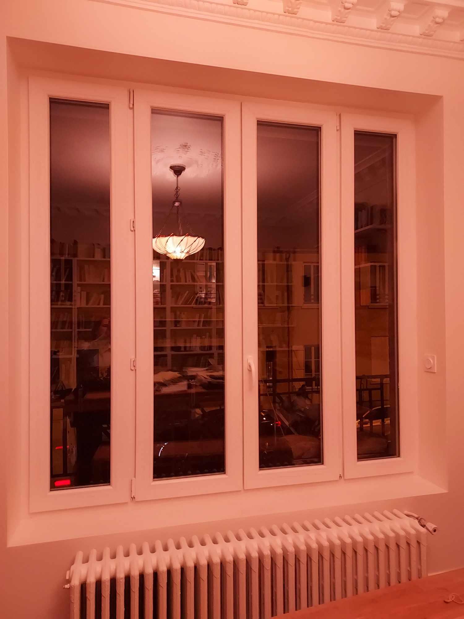

Garald Posted October 19, 2023 Author Share Posted October 19, 2023 (edited) 4 hours ago, SteamyTea said: I made my own from clear styrene sheet and a bit of moulded timber. Less than £10 a pane. They made a huge difference to the sound coming in. Here are some pictures of my windows. Where would the secondary (tertiary?) glazing go? I don't see where it would fit, but then I don't know anything about this. If I've got the specs right, this window offers a sound reduction of 38dB. Edited October 19, 2023 by Garald Link to comment Share on other sites More sharing options...
S2D2 Posted October 19, 2023 Share Posted October 19, 2023 Big help for noise in hotels, but motorbikes may be a step too far as there seems to be no interest in limiting their noise levels. Link to comment Share on other sites More sharing options...
SteamyTea Posted October 19, 2023 Share Posted October 19, 2023 (edited) Bit tricky, especially as that switch is on the wall. You would need to make a thin, timber frame that fits around the whole of the windows, but comes into the room enough to miss the handle, then two panels that fit to the new frame. May need a bit of an overlap in the middle, but that is easy enough. It is the kind of thing that is easier to just make than actually design. This is what I knocked up last year. Edited October 19, 2023 by SteamyTea Link to comment Share on other sites More sharing options...
S2D2 Posted October 19, 2023 Share Posted October 19, 2023 Looking again there seems to be almost no clearance on the inward opening windows, so it may be a non-starter. Link to comment Share on other sites More sharing options...
Garald Posted October 19, 2023 Author Share Posted October 19, 2023 16 minutes ago, SteamyTea said: Bit tricky, especially as that switch is on the wall. That's the switch for the motorized awnings (which should help during the summer). 16 minutes ago, SteamyTea said: You would need to make a thin, timber frame that fits around the whole of the windows, but comes into the room enough to miss the handle, then two panels that fit to the new frame. May need a bit of an overlap in the middle, but that is easy enough. It is the kind of thing that is easier to just make than actually design. Right - I'm having a hard time picturing how that would ever work: while only the middle windows move (the outer panels are stationary), they open both in the "normal" way and in the "German" way (they tilt). Basically, I would need to install another set of windows, set on the other side of the windowsill (some 20cm in), with the middle panels opening (in the "normal" way, at least). That is certainly not an inexpensive hack - and I do not know how well a 20cm-deep parallelopiped (as opposed to a 2cm-deep layer of air, say) would provide sound insulation. Or is this really much simpler than I think? Link to comment Share on other sites More sharing options...
Garald Posted October 19, 2023 Author Share Posted October 19, 2023 If it were possible to install secondary glazing with four panes, with the central two planes sliding onto the two side panes, then that would do it (given the right dimensions). The distance between the primary double glazing and the secondary glazing would be large (22cm, or at any rate at least 16cm, if the secondary glazing is recessed), but that's not necessarily a bad thing (I'd need to ask an applied-math friend). Is this what people have in mind? Is it likely to be affordable? Link to comment Share on other sites More sharing options...

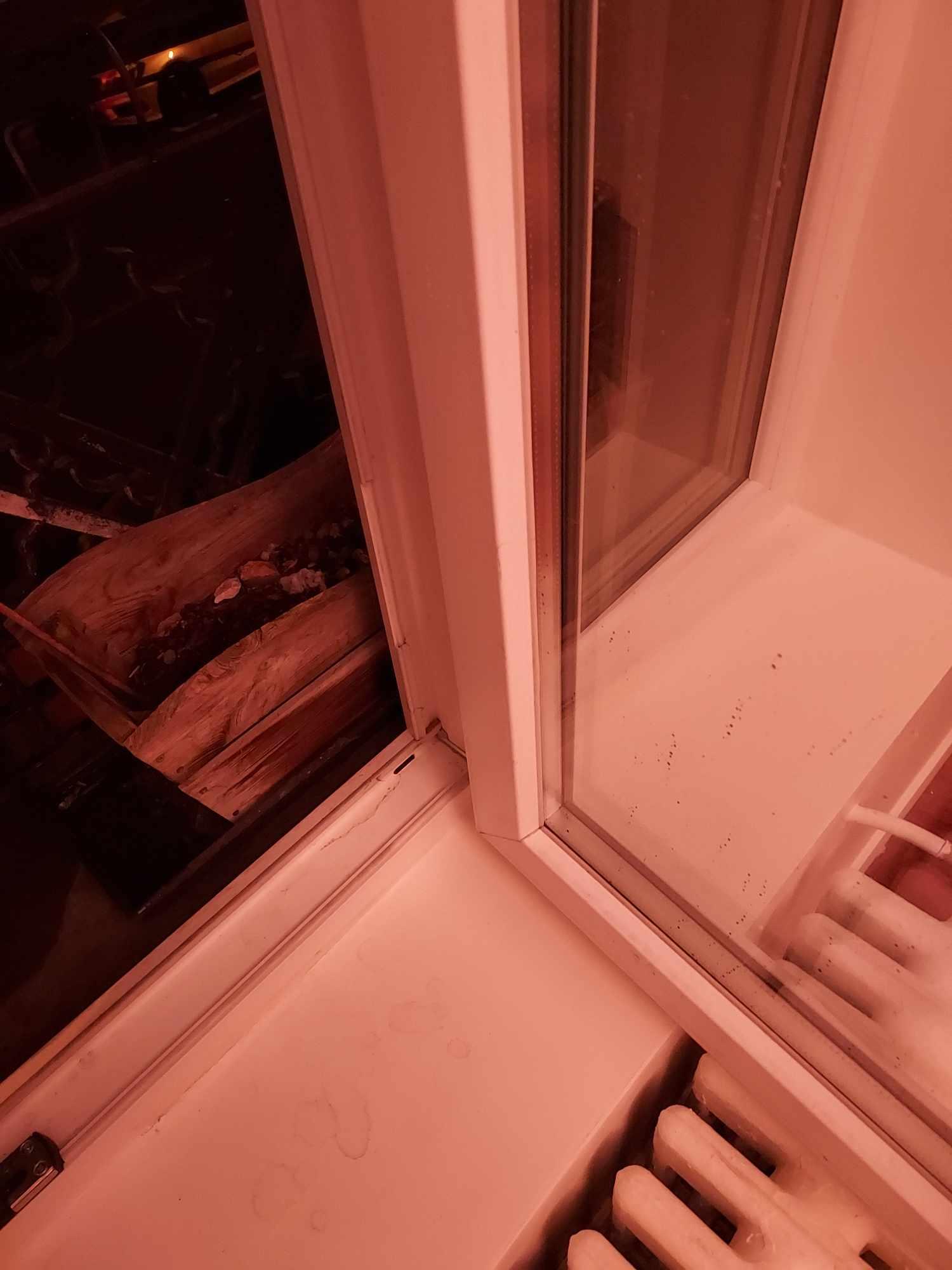

S2D2 Posted October 20, 2023 Share Posted October 20, 2023 57 minutes ago, Garald said: Explain? It's hard to tell but looks to be <1cm from the bottom of the open window to the sill? Fine if you only ever want to tilt the window but if you wanted to fully open it you might struggle to get a frame slim enough to avoid fouling it when opening the window. Link to comment Share on other sites More sharing options...
Garald Posted October 20, 2023 Author Share Posted October 20, 2023 37 minutes ago, S2D2 said: It's hard to tell but looks to be <1cm from the bottom of the open window to the sill? Fine if you only ever want to tilt the window but if you wanted to fully open it you might struggle to get a frame slim enough to avoid fouling it when opening the window. There's 3.3cm - just measured it. The current windows open just fine. Link to comment Share on other sites More sharing options...
S2D2 Posted October 20, 2023 Share Posted October 20, 2023 4 minutes ago, Garald said: There's 3.3cm - just measured it. The current windows open just fine. Ah much bigger than it looked, you just need a secondary glazing frame smaller than that then. Link to comment Share on other sites More sharing options...
SteamyTea Posted October 20, 2023 Share Posted October 20, 2023 10 minutes ago, S2D2 said: Ah much bigger than it looked, you just need a secondary glazing frame smaller than that then. And sticking out further than the handle. Then just about anything can be attached to that. Link to comment Share on other sites More sharing options...
