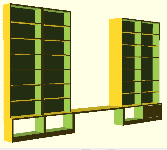

I have low, broad cast-iron radiators under my living room/library windows. I've been thinking of creating reading nooks covering the windowsills (which exist now because of insulation), extending above the radiators. Is this a good idea, or would it drastically decrease the radiators' effectiveness? Also, how do I keep the radiators from overheating/warping the wood in the long term? (Is there a minimal distance?)
Here is what I have in mind:
Wouldn’t think it would make a difference,  as long as there is a gap all the way around you get bench’s radiator Indeed  I have one in my son’s room, just make sure it has the required output for the heat loss of the room.
Not a problem, the heat will hit the bench seat and be forced out into the room. Just like a rad box without a front.

Sure, I made that calculation at the beginning. The power of the radiator won't get cut?
The contractor was very critical of a drawing made by somebody who is not me, showing a border under the bench seat which would have boxed the radiator in to some extent. According to him, that would get in the way of function. Is that right?

What do you mean? As said above as long as air can move around the radiator it will function fine.

Well, air would move around the radiator eventually, but if the bench top is very close to the radiator (1cm, say) and the bench has an apron (that's the term), then the contribution of the two can slow air flow, no? That's at least what the contractor thought.
