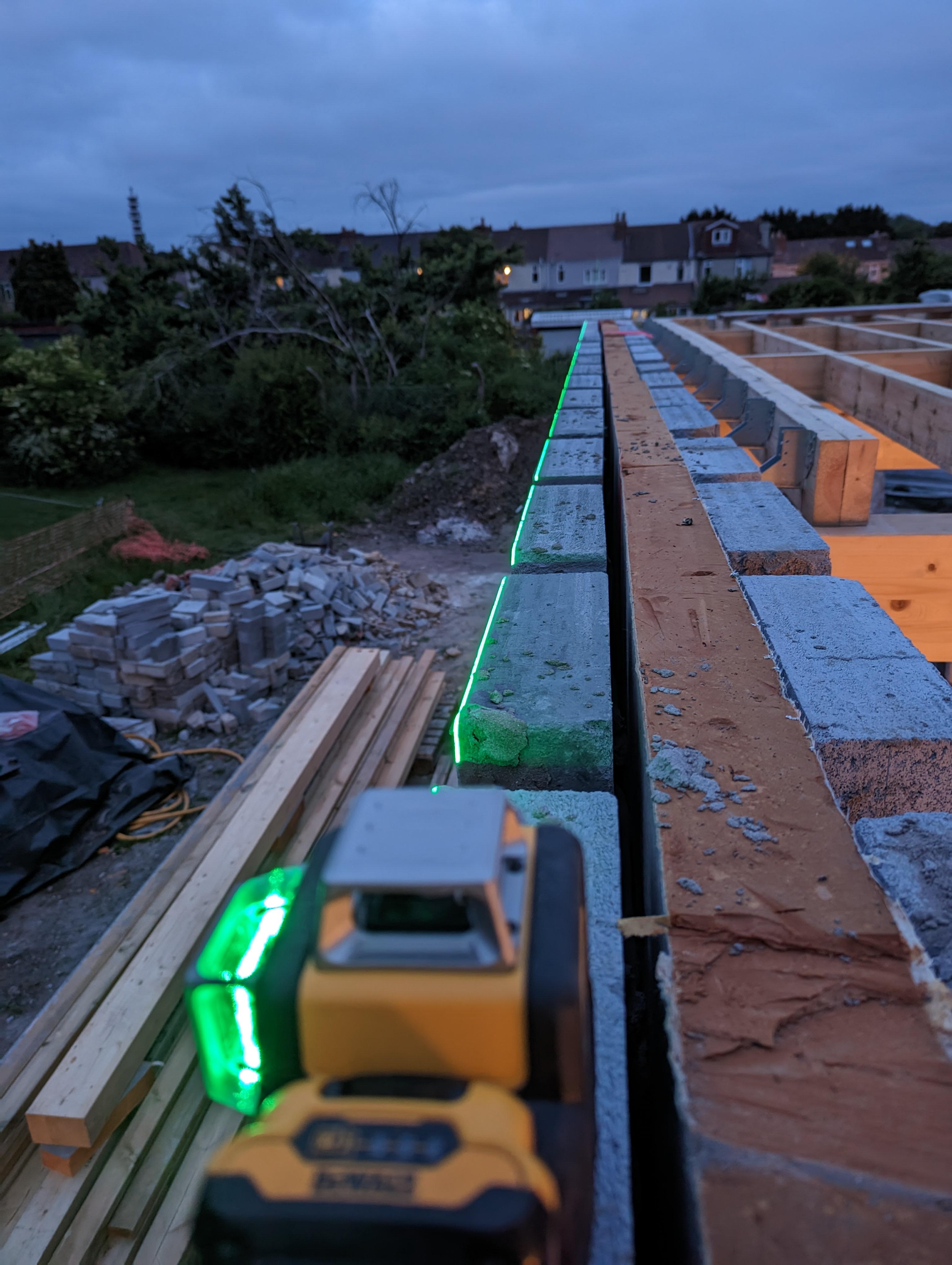

Canski Posted October 5, 2023 Posted October 5, 2023 I’ll have a look tomorrow. All of my calcs were done by the SAP company. If it helps the Ytong blocks are 100 mm standard I think. Deffo 3.6Kn and supplied by Zella through MKM ( not many others stock them) they are a great block to work with. True / square and solid. I used the 100 mm 610 mm long x 215 high version and they are far more stable than thermalites or Celcon. Also NO WASTE ! After building 2 houses to joist I have less than a quarter of a pallet of offcuts that WILL be used. We cut them in seconds with a circular saw. A true clean cut which equals no waste if you can drum that in to the minds of brickies. Or ask them to contribute to a) £ 1.75 for each block wasted and a contribution to the costs of skip and acceptance of the disruption to them due to lack of turning space for the telehandler. I don’t know what others have experienced down the line though. I’d like to hear of anything to watch out for.
goodbyegti Posted October 30, 2023 Posted October 30, 2023 (edited) We used 90mm k106 with a 100mm cavity. The builder had no issue keeping the cavity clean. I think he hosed it on the odd occasion. The negative was the breathable tape for the joints. It cost loads and didn't always stick. Edited October 30, 2023 by goodbyegti
