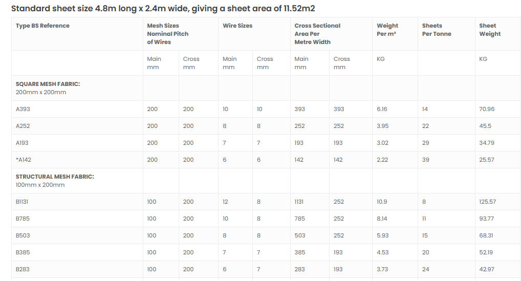

An A type mesh has a bar spacing of 200mm each way. The table below is a good start to look at.
"A" type meshes are usually used to control cracking in slabs, particularly the A142 and A193. These are "non structural mesh applications" which means that if your floor tiles crack then the building / floor will not fall down.. that keeps SE's awake at night if things could fall.. loss of life. Often we use A142 and A193 for small ground bearing slabs and slabs on insulation, sometimes these ground bearing slabs that have less (further apart) movement joints in them... the concrete shrinkage stresses are higher so we use a heavier mesh to give us more space between the crack control joints.
Now often we can use say A252 and A393 meshes for say ICF floor slabs, walls and suspended floors. Here the mesh suddenly becomes part of a reinforced concrete member... it no longer is there to just control cracking but forms an integral part of a main structural component.. which is a structurally reinforced concrete member.. like a reinforced concrete beam over a big bifold door opening.  Now the design codes require a minimum percentage area of steel reinforcement based on the cross section area of the concrete as this is now critical to safety.. won't fall down as opposed to cracking your floor tiles. This minimum percentage requirement often results is a big jump in the amount of reinforcement you need to use.
Often you'll see on BH folk (the ICF world is a case in point) wondering why they have lots of steel mesh and bars specified for what looks like an innocuous slab that others seem to get away with. I hope the above explains that the two different animals.
The B meshes are intended for reinforced concrete (structural members) so have closer and heavier bars in the span direction if spanning in one direction, the cross and smaller diameter bars work as crack control and to tie it all together.. so they are thinner and at larger (200mm )spacing. In the right application they are cost effective.. they would not make them if they were not.
For all and on BH we want to keep things simple stupid and get stuff off the shelf. Most SE's designing self builds will / should take into account that we don't want to complicate concrete design and rebar as the more complicated the more it will cost on site.. introduce risk that things may not get built quite the way we hope. We will often design the reinforced concrete members simply.. technically over design but in the round most economic for you folks on BH once you take into account labour and material availability.
Now if we were designing say a car park or multi story building with multiple continuous spanning reinforced concrete beams we use a technique called "moment re distribution" which means we appreciate the steel will stretch and when it does it sheds load to other parts that have spare capacity so we get more bang for our buck. Now an intrinsic difference between an A and B mesh is that the steel has a different amount of "stretchyness" called ductility.
On 03/10/2023 at 17:06, LSB said:
hey have agreed to A393 for part of the build (we are building in sections), but the part we are doing must be B785, he did tell me why
The above may have the info you did not hear which is why they don't want to swap out the more ductile B mesh for an A mesh. I suspect they may not have gone into that much detail.. so keep pushing and posting if you want some feedback.
