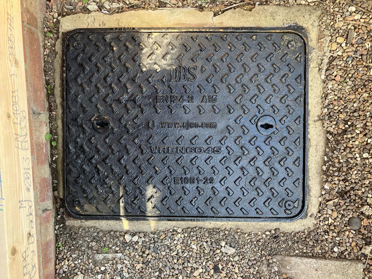

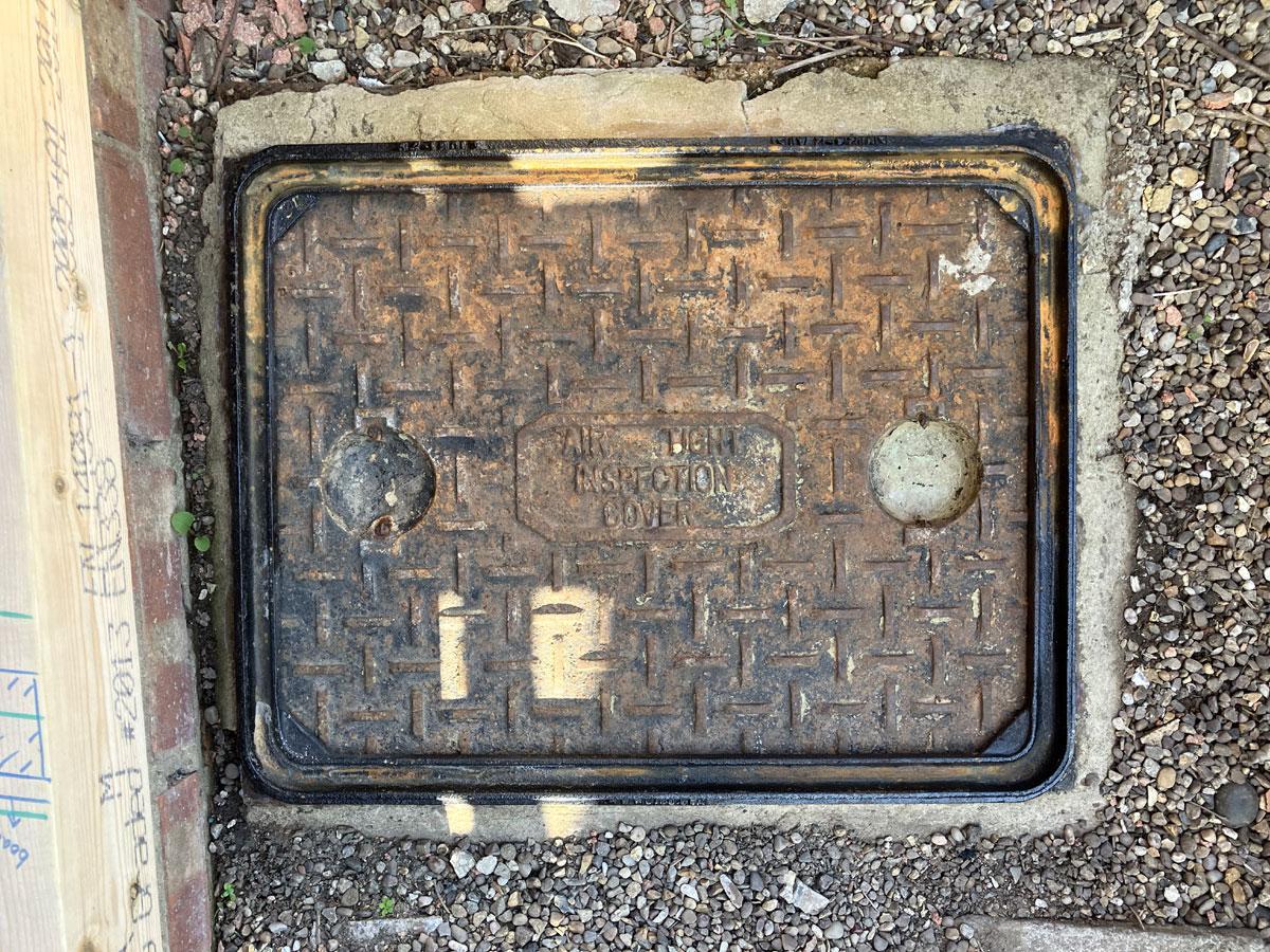

Almost Aviation Posted September 26, 2023 Author Share Posted September 26, 2023 51 minutes ago, saveasteading said: I'm guessing they were cash merchants and you've paid. I paid on a credit card, so I have the option of making a section 75 claim against the CC company and the contractor. I am trying to establish (a) whether people think it would be a legitimate claim, and (b) on what grounds to claim. (Also (c), whether to claim the entire fee or part of it.) My current feeling is to claim the whole fee, on three different grounds: It's not a like-for-like replacement. The installation wasn't done with 'reasonable care and skill'. It's not even approximately airtight. On point 3, restoring it to airtight condition was something I mentioned in an email exchange with them (including pictures) as information for them to offer a quote. (You will also see that the original lid is embossed with 'air tight inspection cover', which they would have been aware of before quoting.) Link to comment Share on other sites More sharing options...

Kelvin Posted September 26, 2023 Share Posted September 26, 2023 That manhole cover isn’t great when installed like this. I know this because I have exactly the same one only a bit bigger for my headwork chamber for my borehole. The frame is too flimsy for the heavy lid so any cement they batter around the frame to secure will always break. The frame needs to be secured in place then cemented. In my case I had a cover and frame made and resorted to doing it myself. Link to comment Share on other sites More sharing options...

Almost Aviation Posted September 26, 2023 Author Share Posted September 26, 2023 1 hour ago, Kelvin said: That manhole cover isn’t great when installed like this. I know this because I have exactly the same one only a bit bigger for my headwork chamber for my borehole. The frame is too flimsy for the heavy lid so any cement they batter around the frame to secure will always break. The frame needs to be secured in place then cemented. In my case I had a cover and frame made and resorted to doing it myself. Yeah, this is what they should have used. This took me literally 10 minutes web surfing to find and order. It just turned up this afternoon. (This is the other end of the garden, BTW!) 1 Link to comment Share on other sites More sharing options...
Almost Aviation Posted August 13 Author Share Posted August 13 Update for the interested: I claimed 50% through my CC company, which was successful. So in the end I paid only (!) £481 for this job. A good result, though debatable whether the effort that needs to go into formulating a detailed complaint would be worth it for a lesser amount 1 Link to comment Share on other sites More sharing options...
