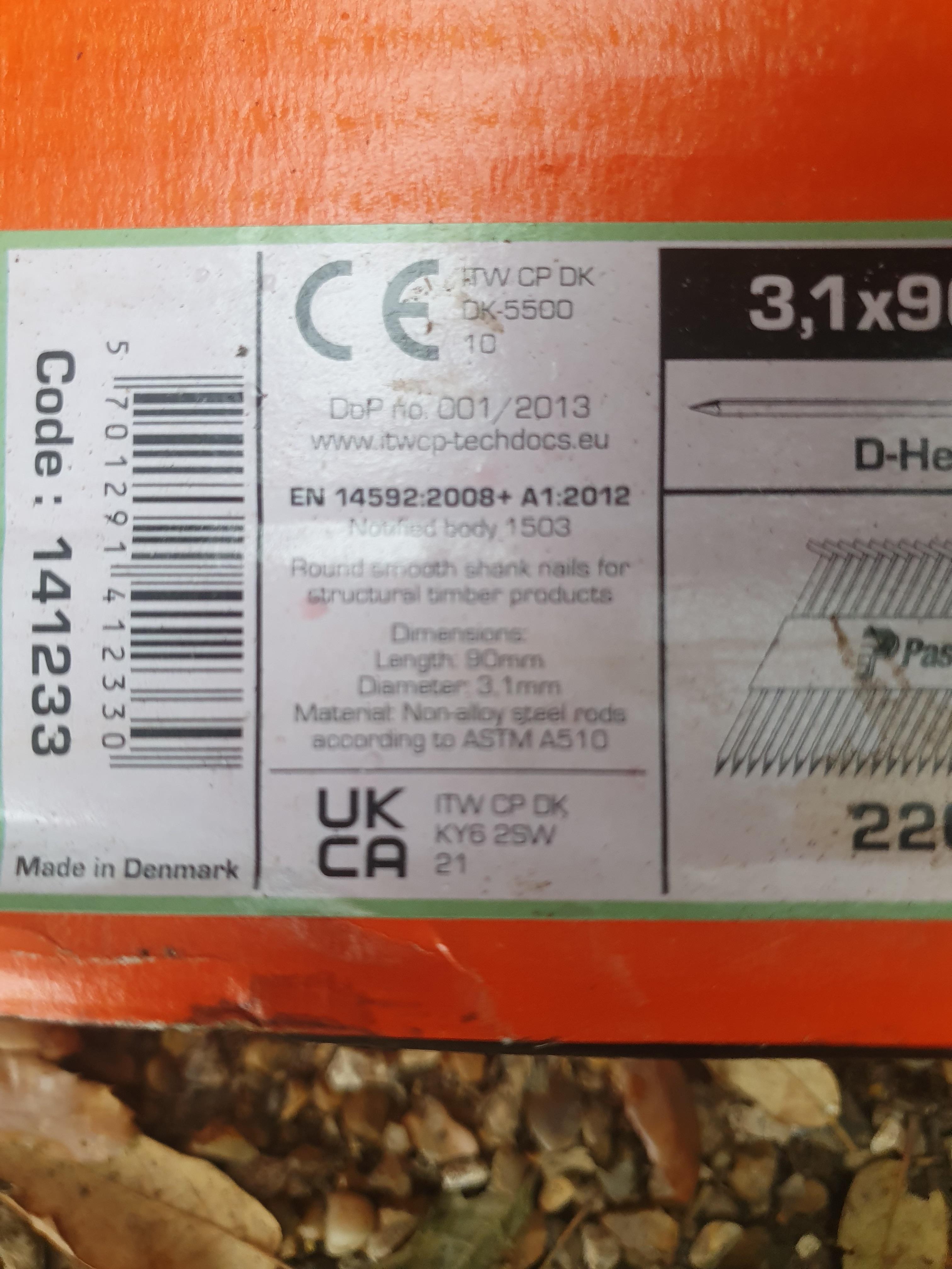

I've just realised I have used interior grade paslode nails on the subfloor and one wall of a timber framed garden room.  the wall frame will be clad with osb and the osb will also skirt the sub-floor.  Is this sufficient or should I double nail with galvplus nails as well?  wood putty over the nail holes?

how serious is this (yes of course I will go forward with the right type of nails and will renail where I can).
Unless these are in direct rain etc you really don’t need to worry.
Bright nails would be the worst to have used, but that’s more because they’re not ring-shank (so they don’t grip the wood very well) vs whether they would rot out.
FWIW, I used regular light galv 51’s on my feather edge and no signs of trouble to date, and they’re completely exposed to all elements.

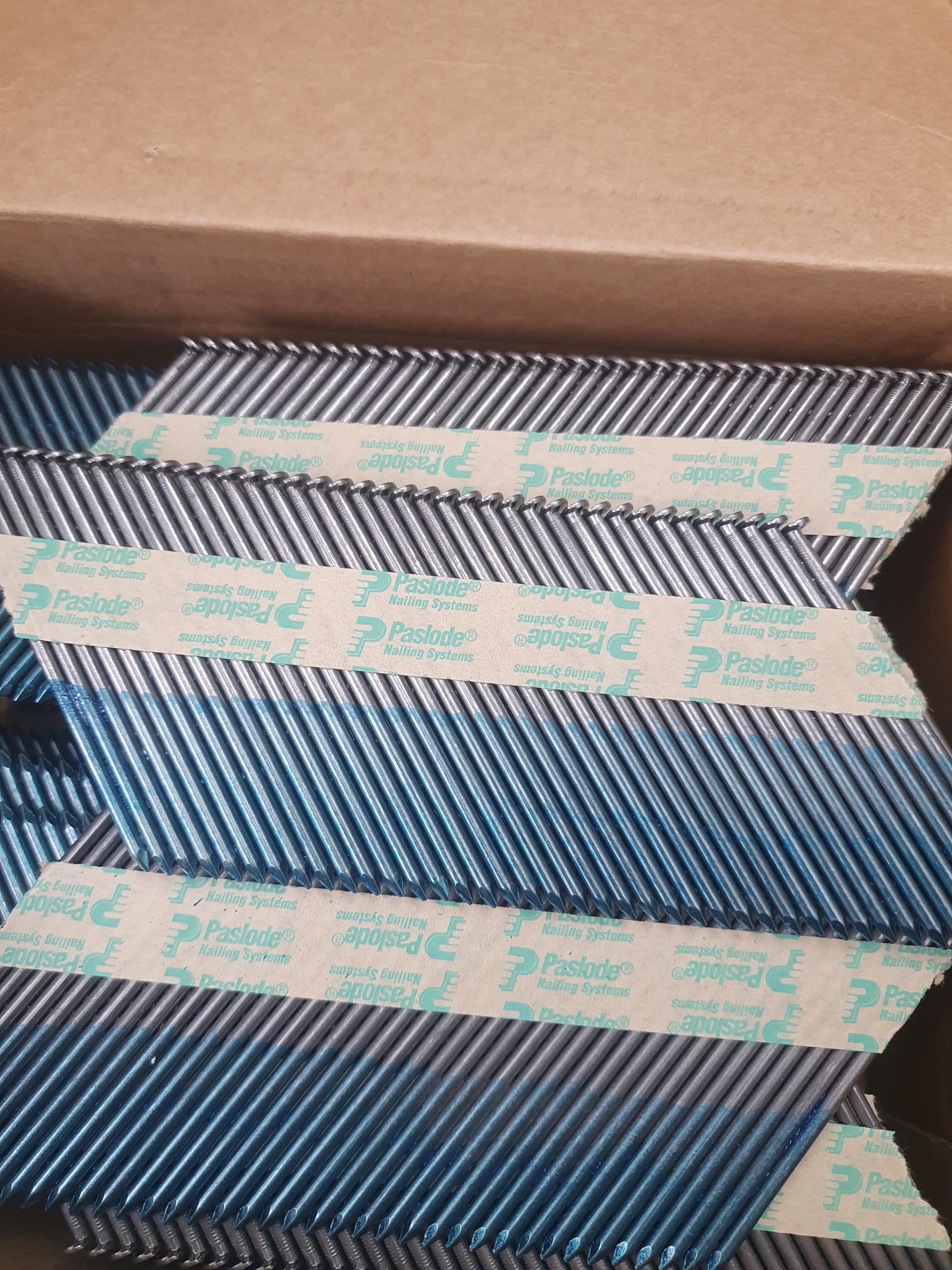

Do you have a pic of the nails used?
they are the bright nails ... 20230924_112224.thumb.jpg.c1aa5b4fe72384af4f46a27fa0aca9c2.jpg
I don't think paslode do ring nails in 90mm unfortunately

As Nick says, if not out in the rain I don’t think it will be a problem and I have used non galv in the past.
Defo have 90’s in RS, but the ones you show are also glue coated (the blue) which heats up and cures from the heat from the friction of firing the nail in. Try smacking a misfired nail in and you’ll see how well (and quickly) the glue holds!
Stand down red alert, and just pop some extra 90’s in if you want to. I doubt you’ll have a moments trouble here tbf, even if simply left alone.

huge thanks for the reassurance!  none of the nails are directly exposed to the environment and are protected from water ingress from above so fingers-crossed!
