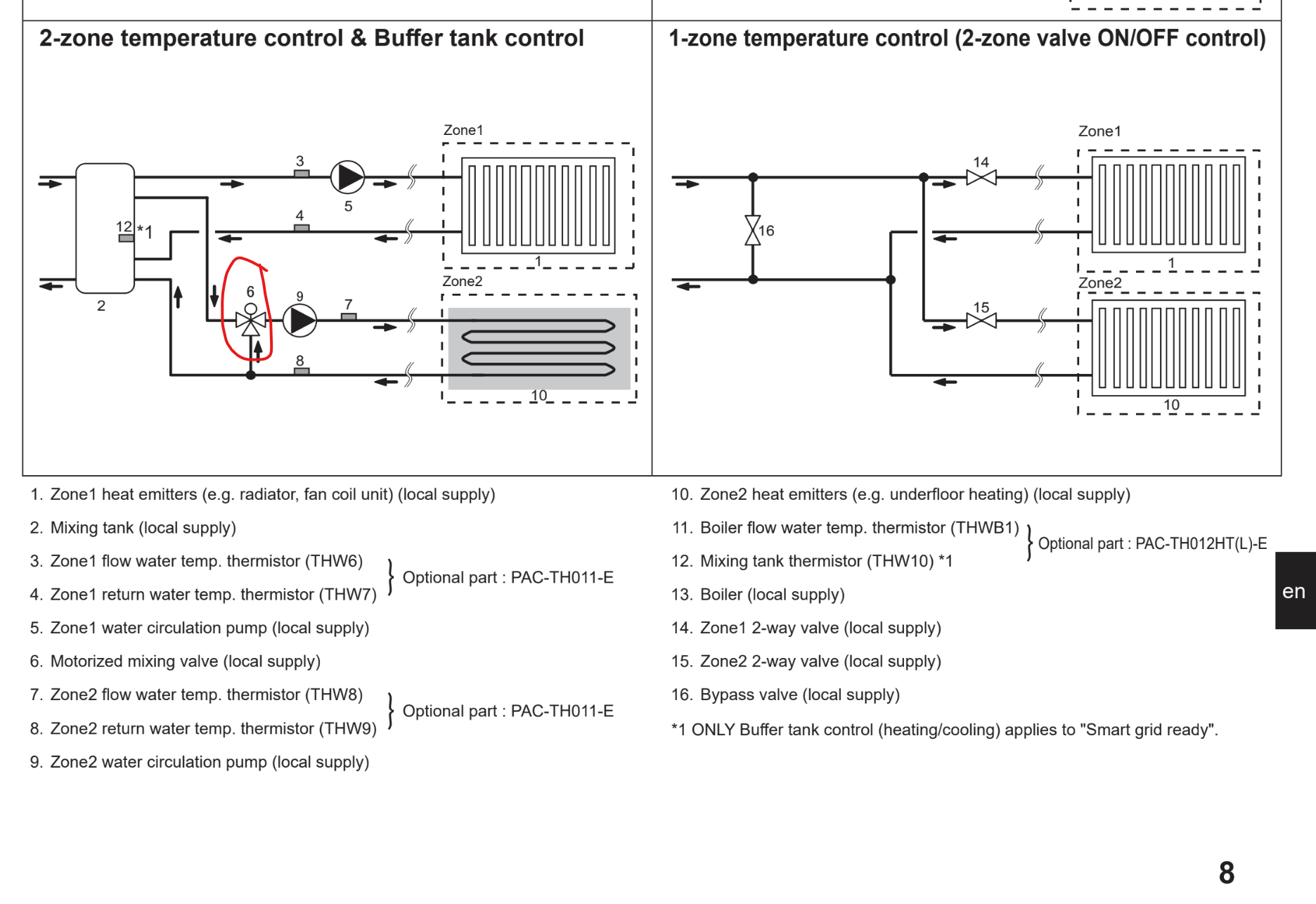

joth Posted September 19, 2023 Share Posted September 19, 2023 Without reviewing the math, my setup is similar and my gut feeling is to agree with your logic. Main questions: What floor finish? Somethings like wood are rated only to about 30°C so you need more caution Will you put sensor probe in the screed? With logging you can use it to empirically verify your design, and/or hook it to thermostat to emergency switch off the pump in case of overheating. Will you be running ashp in cooling at all? And at what temp. This is the main reason you may want an electric mixing valve, to stop water below dew point creating condensation risk inside the slab. (Unlike heating, with cooling if you use a screed temp probe to shut it off if too cold you're probably already too late) Fwiw I do get an annoying slug of hot water in the FCU when switching out of DHW reheat, but my schematic is weird with the buffer in series after the FCU (acting as a volumizer) so doesn't temper the impact like yours will HTH Link to comment Share on other sites More sharing options...

joth Posted September 20, 2023 Share Posted September 20, 2023 1 hour ago, TimothyG said: My gut feel is that there will be enough thermal mass in the slab that even with supply water at 8°C, it will be able to run for 30mins+ before the slab gets too cold. I could also turn the pump speed down and thereby raise the average temperature of the cooling fluid (spiral pattern important again to avoid local cold spots). And if I still end up with the floor getting too cold in places, I can always increase the supply temp of the ASHP and let the fans run a bit faster on the FCUs - or install an electric mixing valve as you suggest (didn't know those existed! will have to research..). This would worry me: while the slab itself might not get down to 8°C, the pipework will be at that temp so any air that can get into the slab around the point the pipes enter could easily develop condensation. The pipes will also be 8°C before they enter the slab and the nature of gravity is any condensation on those pipes (hopefully none but hard to be sure every one is perfectly insulated and sealed) is going to run down into the slab. This is why using slab temp to shut off the pump is helpful to avoid heating over shoot, but not so useful for cooling. I agree focusing cooling mode on the FCUs and get them doing an excellent job will likely make the effort on UFH cooling moot. That's what I found. (And vice versa: I don't bother with FCU heating) For the electric mixing valve, what ASHP are you going with? I know the Mitusbishi FTC6 includes a 3-wire output to control a mixing valve, for example, and this is what I use. (I also have a Loxone server which also has mixing valve control block, but I haven't had to take that level of control over it so far) Link to comment Share on other sites More sharing options...
TimothyG Posted September 20, 2023 Author Share Posted September 20, 2023 Thanks @joth that's super helpful. I hadn't thought about air getting into the slab where the pipes enter. I'll definitely be careful about that now and pay attention to construction details there. I was planning to use short runs of flexible conduit to protect the pipes. Perhaps filling any gaps with a closed-cell spray foam would be a good idea? I have an Ecodan ASHP with the FTC6 controller you mention so that's really good to hear that it has built in control for an electric mixer valve! I also just found this old topic which has some really useful real-world experience from @Jeremy Harris who runs underfloor cooling and finds his floor rarely gets as low as 18°C (typically around 19°C) and he's never had condensation. This topic made me think of some other things: It's certainly true that dew points in the UK are typically quite low (below 18°C) but there are quite a few days in the year (typically the hot ones where the cooling duty is highest) where it can go as high as 22°C. This website has some handy data on historical dew points: http://nw3weather.co.uk/wx10.php?humtype=dew If your floor is bonded to the screed (e.g. tile or glued LVT) then probably the worst case is you might notice a little condensation on a particularly warm, humid day and then you'd increase the floor temp setting (assuming you avoid the condensation in the slab problems that @joth highlighted) But... I'm planning to use a floating floor. This is riskier because the temperature of the screed surface will be ~3°C colder than the floor surface - so call it 15°C (assuming a typical heat transfer of ~20 W.m-2.K-1 and a cooling duty of 60W.m-2 engineered wood would have a higher temperature difference since it has heat transfer of only ~10W.m-2.K-1 and a lower cooling duty would reduce the temperature difference). Half the days in August this year had a max dew point at/above 15°C and... I won't see the condensation because it'll be under the floor. and... even if I use a dew point sensor to set a minimum floor temp, there could be local minimums (will try to reduce this by using a spiral pattern but I don't expect that to eliminate local minimums completely) So that gives a few options: Go for glued LVT instead of Impervia (and be sure to use a high temp adhesive like KE66 / Amtico HT / F48plus). Or just be extra cautious about dew point and allow for a bit of a buffer in the minimum floor temp (assuming the control system is sophisticated enough to allow this. Danfoss and Heatmiser both have systems with dew point sensors but don't know how much control they let you have on the settings). Or... bite the bullet and find an electric mixer and wire it up to the FTC6 controller and then get flow temps to the floor up around 12-13°C Or... give up on slab cooling! Link to comment Share on other sites More sharing options...

TimothyG Posted September 20, 2023 Author Share Posted September 20, 2023 Looks like these would be compatible with my Ecodan FTC6: https://www.loco2heat.co.uk/products/valves/rotary-valves/mixing-diverting-valves/esbe-vrg133-mixing-valve-dn25-kvs-10-cpf-28mm https://www.loco2heat.co.uk/products/valves/rotary-valves/actuators/vrg-series-actuators/esbe-series-ara600-3point-actuator-with-auxiliary-switch-ara652-230-v-ac Link to comment Share on other sites More sharing options...
joth Posted September 20, 2023 Share Posted September 20, 2023 3 hours ago, TimothyG said: Looks like these would be compatible with my Ecodan FTC6: https://www.loco2heat.co.uk/products/valves/rotary-valves/mixing-diverting-valves/esbe-vrg133-mixing-valve-dn25-kvs-10-cpf-28mm https://www.loco2heat.co.uk/products/valves/rotary-valves/actuators/vrg-series-actuators/esbe-series-ara600-3point-actuator-with-auxiliary-switch-ara652-230-v-ac Yup that's the one the FTC6 is pretty much designed around, think this is where I was pointed at it: @Jeremy Harris no longer posts on here unfortunately, but his advice and learning (especially around wishing he'd provisioned for FCU upstairs) is very much what guided my design Link to comment Share on other sites More sharing options...
