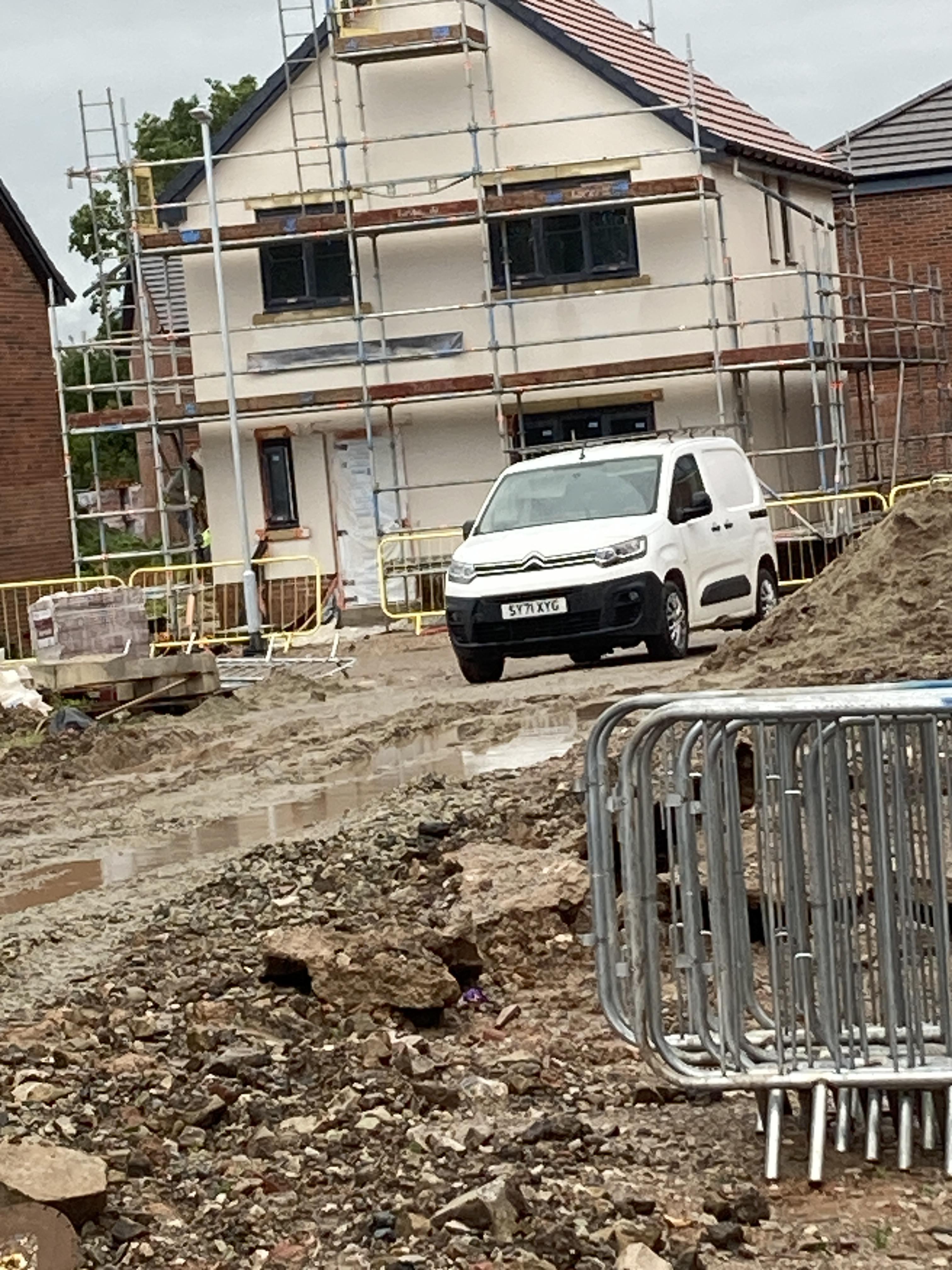

KTB Posted September 19, 2023 Share Posted September 19, 2023 (edited) So, our renderers went ahead today with the K rend application, in light wind and rain. As they finished the first coat on half of the house this evening, the heavy rain started in earnest and is scheduled to keep going all night. So, we are now looking for advice on what to look out for tomorrow morning in terms of potential damage and where to draw the line re: what's acceptable (if any damage is noted) before the job has to be halted please Concerned. Edited September 19, 2023 by KTB Link to comment Share on other sites More sharing options...

nod Posted September 19, 2023 Share Posted September 19, 2023 Once it’s been on a couple of hours it should be fine If the rain is heavy it can wash around the beads We normally add accelerator and rub it up the same day If night conditions are cold or wet 1 Link to comment Share on other sites More sharing options...
SuperJohnG Posted September 19, 2023 Share Posted September 19, 2023 Look for a wash off - also if they are an approved applicator for K rend their work will be warrantied. K rend will also tell you the required conditions if it was OK. 1 Link to comment Share on other sites More sharing options...

nod Posted September 20, 2023 Share Posted September 20, 2023 3 minutes ago, KTB said: So don't apply it in Scotland, then 🤣 We put this on yesterday Hammered it down all day 1 Link to comment Share on other sites More sharing options...
KTB Posted September 20, 2023 Author Share Posted September 20, 2023 4 minutes ago, nod said: We put this on yesterday Hammered it down all day The guys outside today don't seem overly concerned TBH - Here's hoping Link to comment Share on other sites More sharing options...
nod Posted September 20, 2023 Share Posted September 20, 2023 Just now, KTB said: The guys outside today don't seem overly concerned TBH - Here's hoping No I have renderers working full time Summer is more of a problem 1 Link to comment Share on other sites More sharing options...
