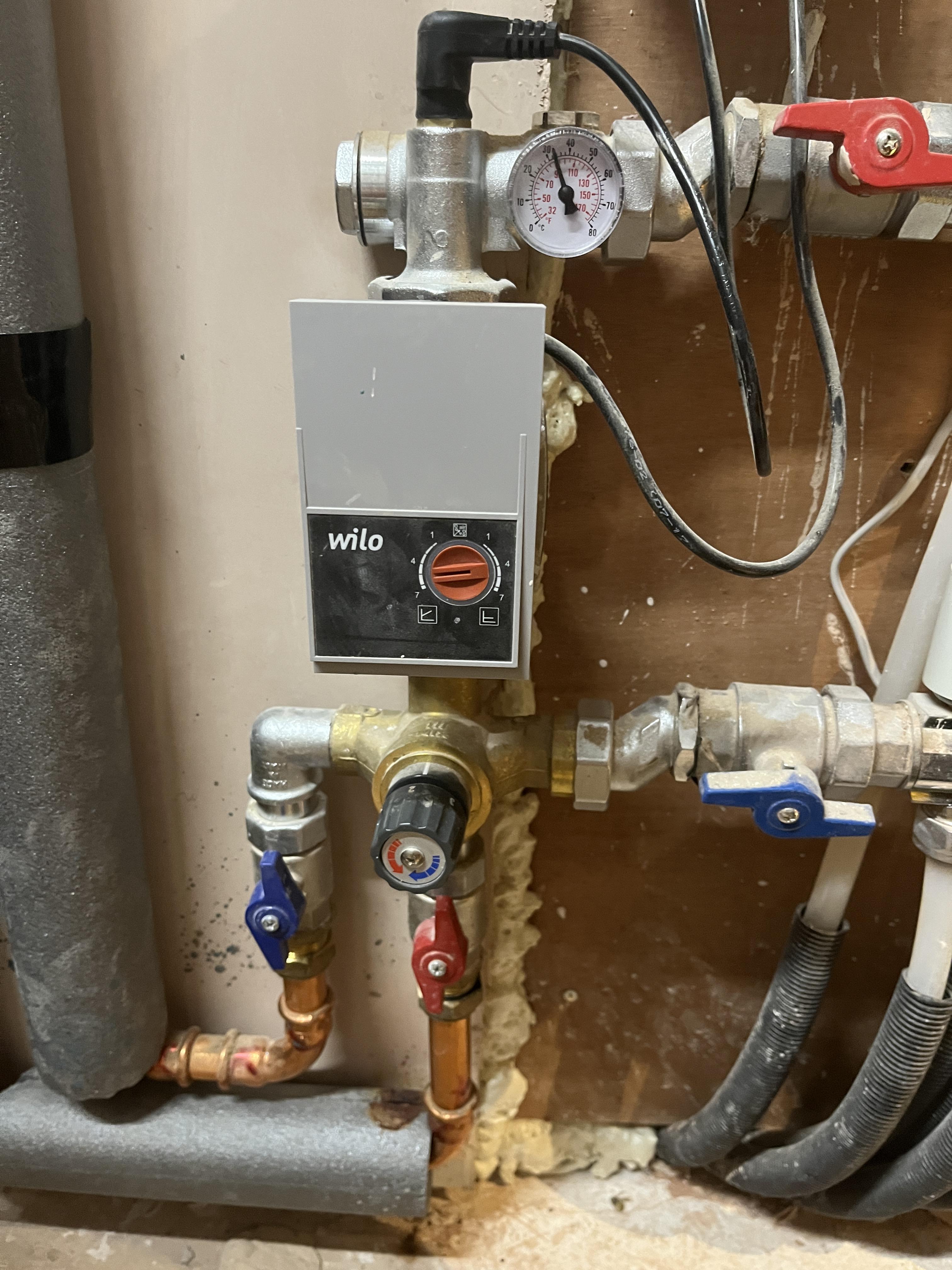

AliG Posted September 18, 2023 Posted September 18, 2023 Hi, I have a mixer valve that "groans". I think this issue has come up before as kind of fluttering in the system. It was fine for three or four years before it started to do this. You can temporarily fix this by adjusting the temperature but then it gets to the new temperature and does it again. I was thinking of getting the boiler serviced and asking them to replace it when they are here. Can you just replace the 4 way mixer or does it only come as a unit with the pump? Looking online i suspect it was all supplied as one with the manifold and I cannot see a make on the actual mixer. Are general heating engineers a bit wary when it comes to messing with UFH?

AliG Posted September 18, 2023 Author Posted September 18, 2023 Thanks Sorry meant to include a picture - I think it says TH MIX on it as well as made in Italy.

AliG Posted September 19, 2023 Author Posted September 19, 2023 Thanks @Nickfromwales I realised last night that there might be something in all the manuals etc I was given. It appears that I have this unit -248TH MCE2014.pdf248TH MCE2014.pdf248TH MCE2014.pdf This has been replaced by the 248N and the technical data for this says that the primary flow should be at least 15C higher than the set temp of the mixer. When I was looking for replacements, some of them said 20C. A while back, trying to optimise boiler efficiency, I turned the boiler down to the high 50s. The flow in that manifold is set I think at 42C, so I have turned the boiler up into the 60s to see if in fact the problem is being caused by the low temperature differential.

JohnMo Posted September 19, 2023 Posted September 19, 2023 The good thing if you do change the mixer for an Ivar, there are plenty of adjustments and fine tuning you can do. You can actually reduce the dT down quite a bit, think I managed to get the dT down to 5 degs across the valve. The mixer may be gummed or scaled up restricting internal parts moving and you are getting under and overshoot or generally worn. I moved to an ASHP and as I only have UFH eliminated the the pump and mixer all together.
AliG Posted September 20, 2023 Author Posted September 20, 2023 So far it seems quieter since I turned up the boiler, but the heating has only been on for a few minutes. 22 hours ago, JohnMo said: I moved to an ASHP and as I only have UFH eliminated the the pump and mixer all together. This now has me thinking. At some point I plant to switch over to an ASHP. I would probably have to take out the mixers as they won't be required and likely won't like the low flow temperature. I have 4 manifolds, so won't be in a hurry to do that!
John Carroll Posted September 29, 2023 Posted September 29, 2023 Can you remove the shuttle, clean it up, apply a bit of silicone grease and see how it goes.
AliG Posted September 29, 2023 Author Posted September 29, 2023 Since turning the boiler up it is still groaning although maybe less than before. I could put Star Wars on as it sounds quite like Chewbacca! @John Carroll you have me there. Is the shuttle the trv?
John Carroll Posted September 30, 2023 Posted September 30, 2023 9 hours ago, AliG said: Since turning the boiler up it is still groaning although maybe less than before. I could put Star Wars on as it sounds quite like Chewbacca! @John Carroll you have me there. Is the shuttle the trv? Yes, it's the thermostatic mixing valve,TMV, generally contains a plastic piston/shuttle which can be removed.
