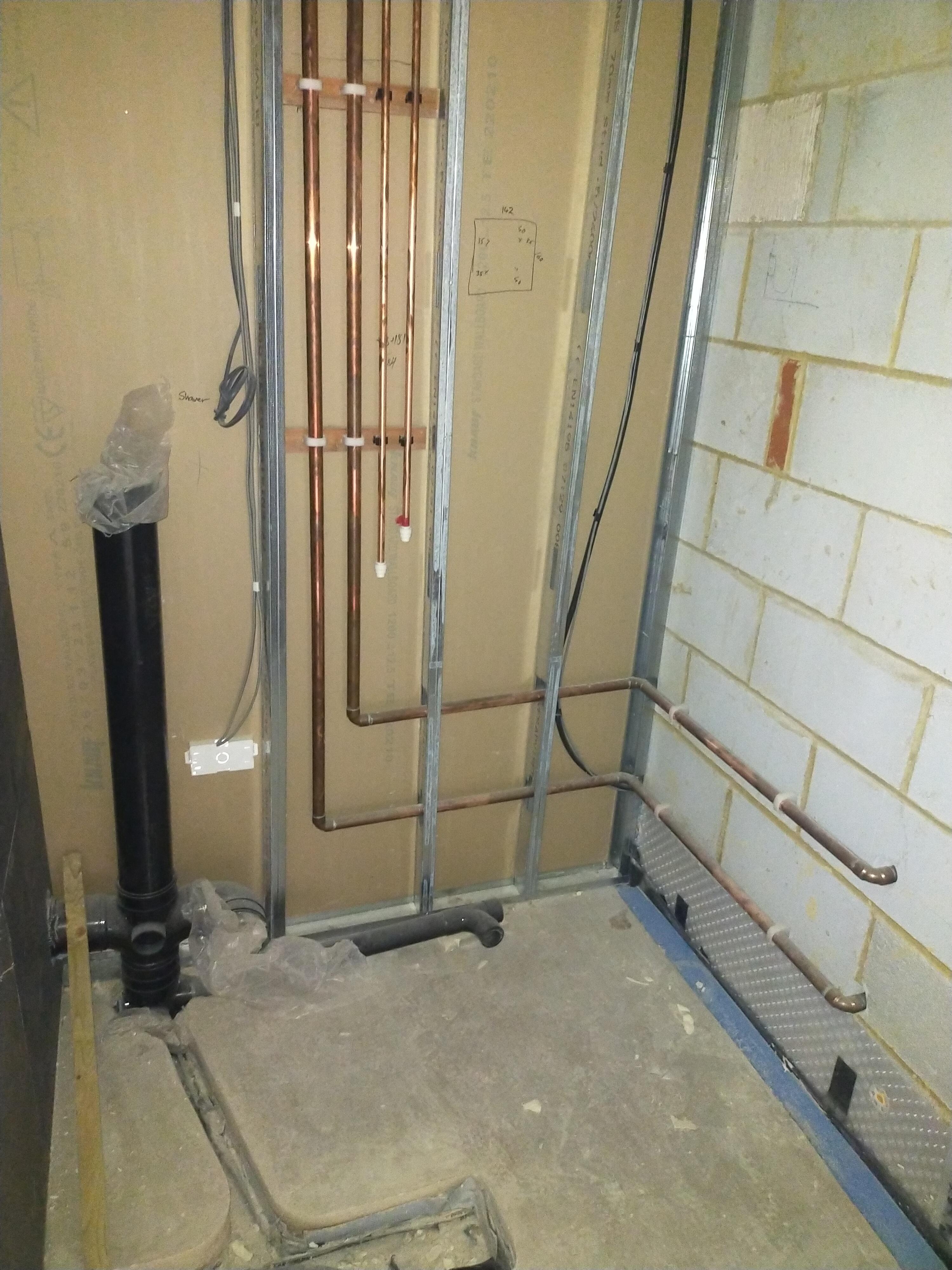

Tony K Posted September 15, 2023 Share Posted September 15, 2023 Hi all. I am thinking of using a wall-hung WC, requiring a 'wall frame with cistern' kit, or a 'concealed cistern and frame' kit, like so: The wall the w/c will hang from is an internal partition wall, made using metal studs and plasterboard (photo attached). Plainly, the cistern frame cannot be attached to the metal studs, but various manufacturers tell me that if I build a reasonable timber frame behind it, the cistern frame unit can be attached to the timber and will then take the weight of the wall-hung w/c. Plus me sitting on it. Which is a fair bit of weight. Has anyone any experience of fitting such a unit to a timber frame, and if so, is that actually sufficient for a wall hung w/c? Thanks Link to comment Share on other sites More sharing options...
markc Posted September 15, 2023 Share Posted September 15, 2023 Wall hung frames put most of the load into the floor, keeping a low pan and high frame attachment points onto the wall also reduces the lateral load imposed. On your wall, if you sit down heavily you may/will see some wall deflection but if is doable. Add a couple of stiff timbers top to bottom where the mountings are and the wall will be fine 1 1 Link to comment Share on other sites More sharing options...
nod Posted September 15, 2023 Share Posted September 15, 2023 Absolutely Very little weight on the top We did four on our last on metal studs and five this time Worth putting a door timber in the studs for metal 1 Link to comment Share on other sites More sharing options...
markocosic Posted September 17, 2023 Share Posted September 17, 2023 I was sceptical. Can confirm is solid as they come if the frame is the depth of the cistern. Drill a bunch of holes through the sides of the metal frame (with cistern out) and screw through into the stud with half a dozen shear screws each side. (the sort used for joist hangars etc) Some adhesive from frame to stud won't hurt. Most load goes into floor. The "peeling of the wall" load is all you're carrying, in pure shear, and can promise it'll go nowhere with a few screws let alone screws/glue. Shear rated screws example: https://www.amazon.co.uk/Angle-Fitting-Screw-Connector-Screws/dp/B09DDC65PX 1 Link to comment Share on other sites More sharing options...
Tony K Posted September 21, 2023 Author Share Posted September 21, 2023 @markocosic In your set up, how does one access the cistern / mechanism etc in future to repair it? Link to comment Share on other sites More sharing options...
markocosic Posted September 21, 2023 Share Posted September 21, 2023 All comes apart from the flush mechanism hole. Cold feed into iso tap at top of cistern. Hose from there to gubbins inside cistern. All gubbins come apart from flush plate hole with sufficient cajoling. 1 Link to comment Share on other sites More sharing options...
