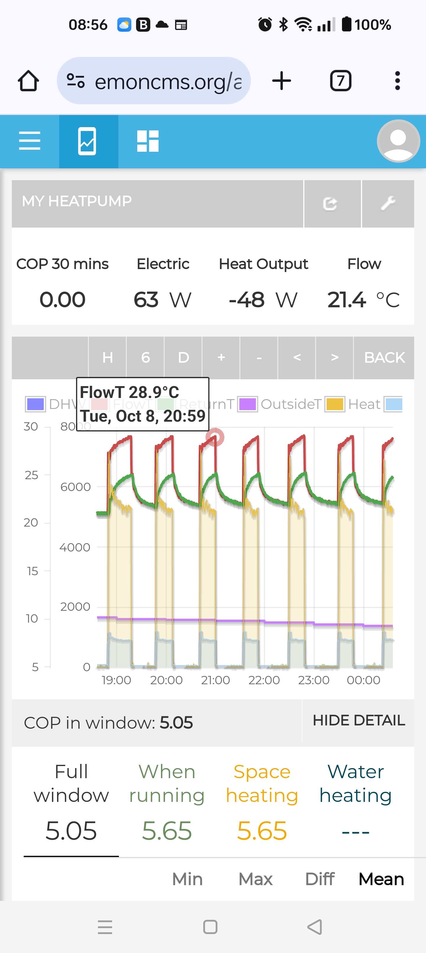

JohnMo Posted October 16, 2024 Share Posted October 16, 2024 10 hours ago, MechanicalBuilder said: John does this help stop cycling? Sorry to revive an old thread but I’m trying out WC over a fixed flow temp and I can’t stop the heat pump from cycling. It’s a daikin altherma 3 and at 10’c OT 30’c flow temp the house is overheating. I try to turn down the flow temp and the compressor is short cycling every 20 mins or so. I’m really trying to use the ‘low and slow’ method of heating but I’m finding the ashp doesn’t really need to do much. Have you a rule of thumb for when your heating season begins? I’d like to try and leave the heat pump on all the time but as I’m off grid I can’t afford the excess power consumption of this I say embrace the cycling, rapid on off as not good, but cycling on a controlled manner is generally good. There is a lot of miss information out there, that heat should not cycle, they do and will when heat demand is below min output, and even if the condition doesn't suit the refrigeration side they will manage by cycling. Mine rarely gets down to 4kW output on a 6kW ASHP. I am back to WC mode but in essence doing exactly the same as you comment you referred to but just leave to do it's own thing over a longer period. Couple of givens, at temp where you just start to heat the house almost every heat pump is way over sized, they cycle to manage heat delivered. The lower the flow temp the more difficult the heat pump finds it to control and run for extended periods. I fiddled with the compressor start stop hysterisis to get a 10 to 15 min run in mild conditions. That was a figure I found some useful heat was being added to the house, any less than that the house temp slowly dropped. Some will implement a control strategy where at higher OAT they use the controller thermostat combined with WC. I would drop your flow temp a couple of degrees and monitor. For reference this is mine at 9.5 Deg OAT. About 12 to 15 mins on and 30 mins off. Max flow temp was 29, min power output 5kW. 1 Link to comment Share on other sites More sharing options...

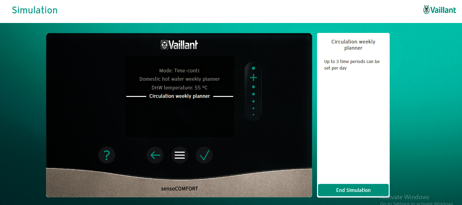

sharpener Posted October 23, 2024 Share Posted October 23, 2024 On 18/10/2024 at 16:59, sharpener said: It may be one of those menu options which appears/disappears depending on what else you have got installed or configured Finally found it while looking for something else @BobBiggar . On the SensoComfort go to Control | DHW Set to Time Controlled Circulation Weekly Planner then appears in the available options: Then you can set up to 3 time periods per day: If you set HW to Off or Manual it disappears again. But the Weekly Plan is stored in the memory so is still there if you enable Time Controlled once more. AFAIK you can then configure the MA2/MO2 output as Circulation Pump and use it for any purpose or indeed as an independent timer. If I had worked this all out earlier I would not have needed to re-use my old Honeywell timer for the Thermal Store! HTH Link to comment Share on other sites More sharing options...
