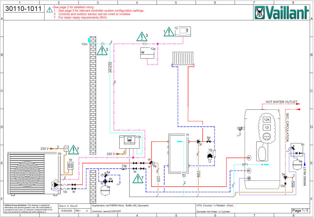

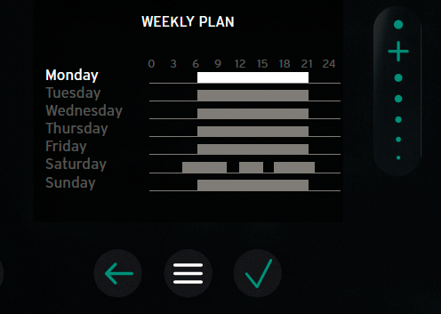

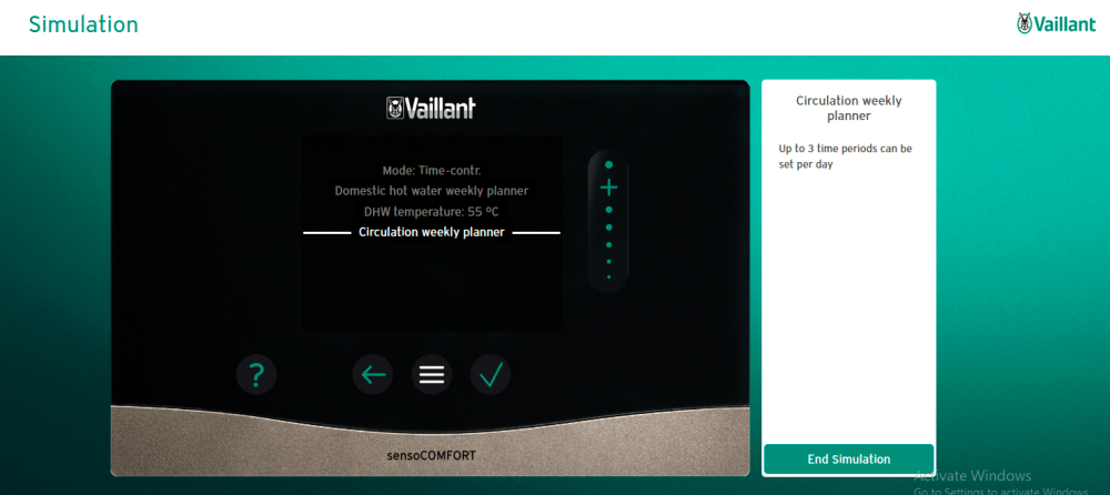

Peter269 Posted September 21, 2023 Author Share Posted September 21, 2023 A week after my first post - thanks for all the useful suggestions, and here's an update. I've been researching, reading manuals, and playing with the sensoCOMFORT simulator. I can now answer some of my own questions and I'm posting the answers here in case anyone else has the same questions. I've taken on board what others have said about the pros and cons of buffers, and I'm now thinking about some hydraulic alternaitves - a) buffer, secondary pump, TRVs on all rads but mainly fully open or fully closed. (my original plan) b) no buffer, TRVs on all rads, but with Automatic Bypass Valve and volumiser c) no buffer, TRVs on all rads bar one (probably the hall) with volumiser d) no buffer, no TRVs, no Evohome. All rads open, fed by ASHP pump open loop. They all have advantages and disadvantages, and I will have to give some thought as to which is the least worst. I might do some modelling. And here's my answers to the other questions - To run the Arotherm open loop, I will need at least a 'heat pump interface' maodule (VWZ AI). The outdoor temp sensor, DHW temp sensor, and (optional?) flow temp sensor connect here. This allows me to set most of the settings I need, including selecting a weather compensation curve (0.4 to 4.0). However it doesn't allow me to specify a heating schedule. I could instead use a 'hydraulic station' (VWZ MEH 97) which has all the same functions but includes integral expansion vessel, back-up heater and diverter valve. I don't have space for that though, so I'll be using discrete hydraulic components. To set a heating schedule, I need a 'system controller' as well, either a VRC 700 or the newer VRC 720 sensoCOMFORT. This allows up to 12 periods a day to be defined, each with its own set temperature. The 'set-back' temperature is used for all times outside of the defined periods. So potentially 13 different target temperatures per day, more than enough! Changing the target temperature modifies the WC curve up or down, so determining how warm the house gets even though there is no room temperature measurement. The sensoCOMFORT also gives a wider range of WC curve (0.1 to 4.0) than the VWZ AI. I haven't got to the bottom of exactly how the ASHP pump behaves. I know that the compressor (and fan?) can modulate and cycle based on degree-minutes, and I know from the spec that the pump can modulate between 9 lpm and 20 lpm for the 7kW model. The VWZ AI allows the pump speed to be set from 50% to 100%, or in Auto, but the only reference I could find to the pump actually switching off is a "summer switch-off temp" which can be set from 10 to 90 degrees. Why does this matter to me? If I retain the Evohome, I expect there will be times when the house doesn't need any heat so I will either have to accept the ASHP pump running 24x7x52 or find some way of switching it off from the Evohome when not required. I've not found the answer, but I'm prepared to suck it and see. So I think I now have enough knowledge to go back to the installer and discuss options with him. Thanks all Link to comment Share on other sites More sharing options...

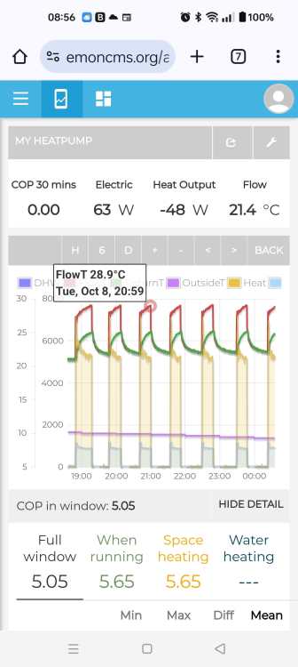

BobBiggar Posted October 7, 2024 Share Posted October 7, 2024 21 hours ago, JohnMo said: You can normally program any heat pump to have either of these properties. But it depends on your system, if one method better than another. I found I got unnecessary frequent starting and short runs with the circulation pump off or in sniffing mode. But makes a big difference if UFH or radiators also. I have UFH and the continued circulation helps the system determine based on return temp when the floor needs more energy adding. thanks @JohnMo First of all, apologies if some of my terminology/jargon isn't quite right. I'm only just getting to understand our system after 6 months living with it and am trying to learn how to optimise it's operation. My observations are all a bit subjective but I haven't yet worked out how to pull data off the system and analyse this objectively. My system has GF UFH and 1st Fl rads, but all designed at 35 deg WC flow temp and configured as a single zone. There is a buffer between HP and emitters which I'm not sure is necessary. It's a modern highly insulated building including a MVHR system. Essentially everything on all the time trying to maintain 21 deg (playing around a little with 20deg or 19deg setback). It doesn't seem to cycle too often. The installer fitted a 12kW Arotherm which I think is overkill. I haven't noticed it running at more than 30-40%. Heating curve is 0.55 and temperature throughout the house is consistent and doesn't decrease too quickly. Sensing temperature every 30 mins or even 60 probably wouldn't see much difference. We have just been through our first summer and the internal circulation pump ran continuously (at 1100 lph according to VWZ AI) when the HP was only active a couple of hours each night for DHW. 6 months of circulating with no heat demand seems like a real waste of energy. I know it's possible to alter this pump behaviour but I have only seen either fixing it to between 50%-100% or "Auto". Its set to Auto but I don't know what that means since it only seems to switch between 1100 lph (compressor off) and 2000 lph (compressor on). Link to comment Share on other sites More sharing options...
