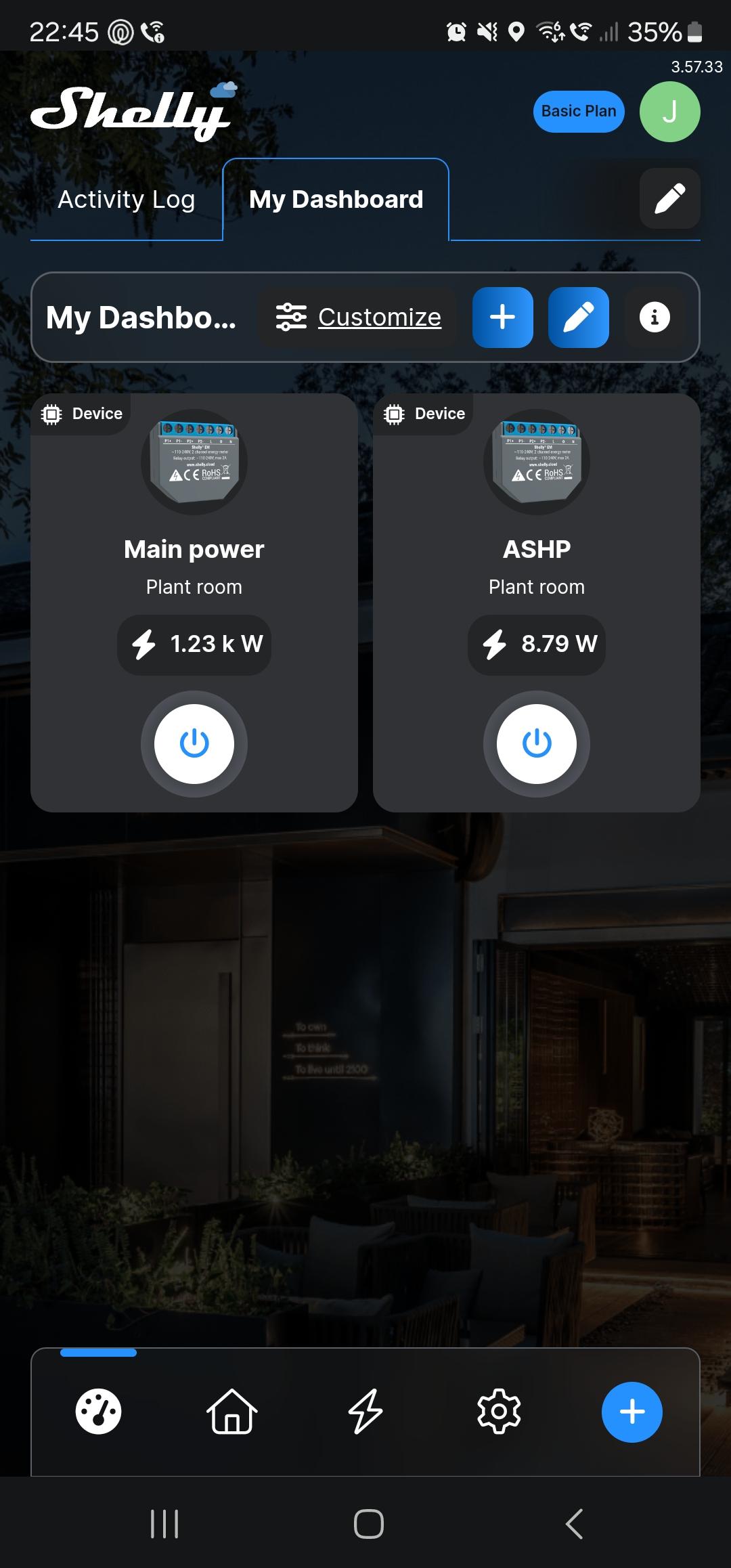

SuperJohnG Posted February 9 Author Share Posted February 9 I think I'm going to order the shelly unit, I love the look of the open energy interface but it's 250 quid vs 80 and in reality I really only want to measure the main incomer and our ASHP. The reason I've picked this up now, as I done a meter reading g the other day and for the 80 days we averaged around 47kWh each day which seems ALOT? the other day we were 70 kWh for a day which seems madness! But my ASHP is a vaillant running a cop of 4.1 for the heating, 3.4 for the DHW so it's not that but I really have to figure out where the energy is going. We do have a borehole but can't imagine it's those pumps as they run for very short periods,there is a UV bulb which runs 24 hrs a day but even at that I can't imagine the bulb is larger than 40W at most. I'll likely now order a PV system and some batteries but that's the next thing on the list. Likely this be a Giv energy unit has anyone used that along with a Shelley? Link to comment Share on other sites More sharing options...

SuperJohnG Posted February 13 Author Share Posted February 13 (edited) Immersor was turned on...but its faulty, sparks were here today and while waiting for my Shelly EM to arrive in the next few days we quickly checked the current draw, the immersor albeit for some reason isn't heating water, has been on for around two weeks, pulling 2.7kW the whole time. An expensive two weeks..but glad we found it quickly. Edited February 13 by SuperJohnG Link to comment Share on other sites More sharing options...

SuperJohnG Posted February 14 Author Share Posted February 14 Got mine tonight, looks good so far. Link to comment Share on other sites More sharing options...
