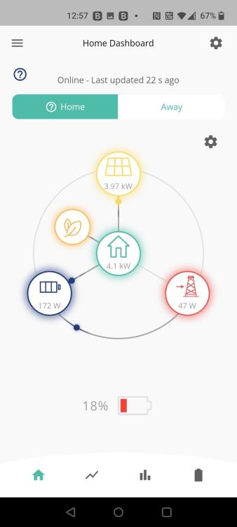

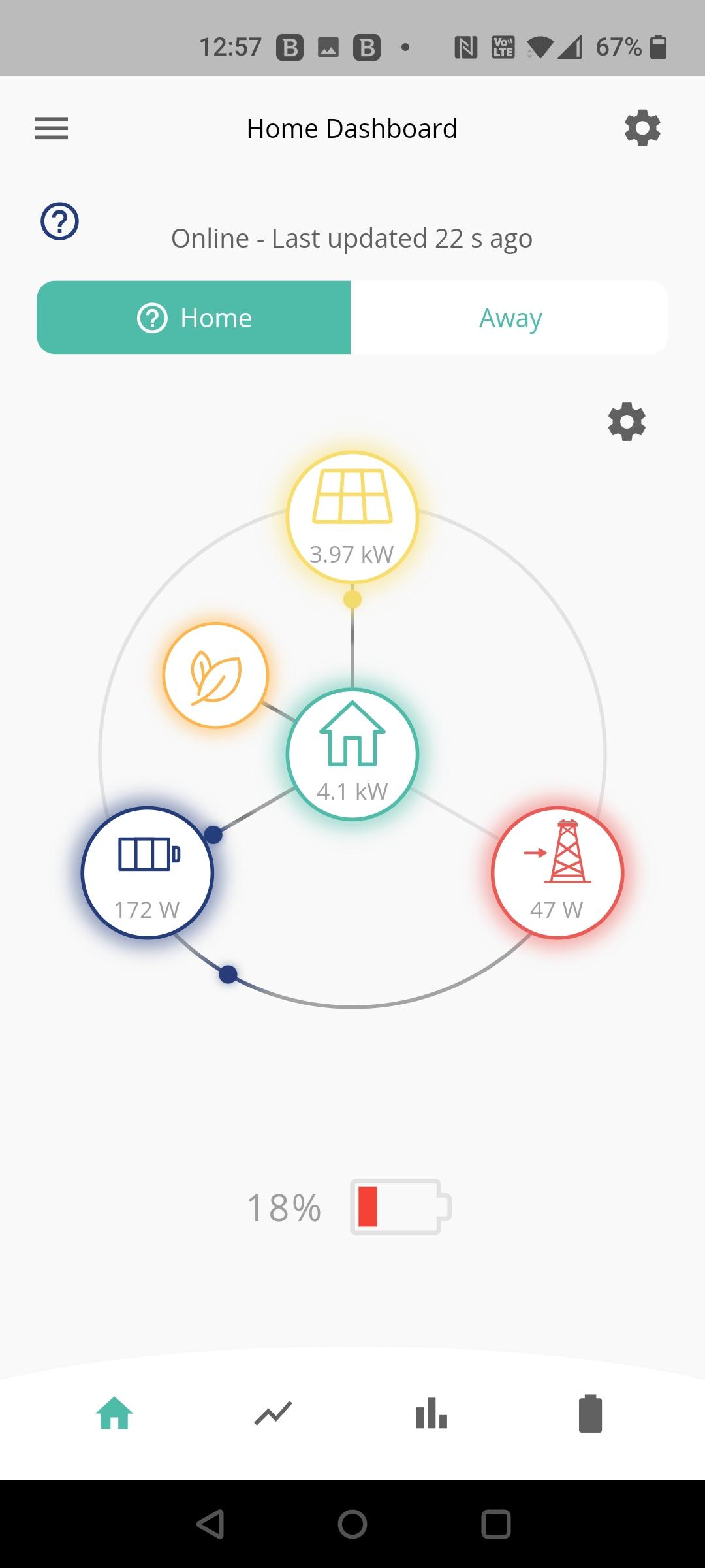

JohnMo Posted September 10, 2023 Author Share Posted September 10, 2023 Then the washing machine went on Link to comment Share on other sites More sharing options...
SteamyTea Posted September 10, 2023 Share Posted September 10, 2023 (edited) 5 hours ago, JohnMo said: washing machine went on Think mine uses 1.3 kWh for a 40⁰C wash. I tend to use a 30°C was now as I spend less time over fryers and more by a chopping board. Why were you exporting at 47W? Edited September 10, 2023 by SteamyTea Link to comment Share on other sites More sharing options...
JohnMo Posted September 10, 2023 Author Share Posted September 10, 2023 41 minutes ago, SteamyTea said: Why were you exporting at 47W I am not sure, it seems to move about from minute to minute sometimes importing others exporting. Not sure if some is to with the conversation from AC to DC and back to AC converter losses. Rather than real export. Or if it's using the grid as small resource to make up for an ever moving PV supply power and the variable of house demand. Link to comment Share on other sites More sharing options...
SteamyTea Posted September 10, 2023 Share Posted September 10, 2023 45 minutes ago, JohnMo said: I am not sure, it seems to move about from minute to minute sometimes importing others exporting. Not sure if some is to with the conversation from AC to DC and back to AC converter losses. Rather than real export. Or if it's using the grid as small resource to make up for an ever moving PV supply power and the variable of house demand. Could be rounding errors. It does need to check the grid is alive, seem to remember that it has to disconnect within 5 seconds, so must sample at least that often. Link to comment Share on other sites More sharing options...

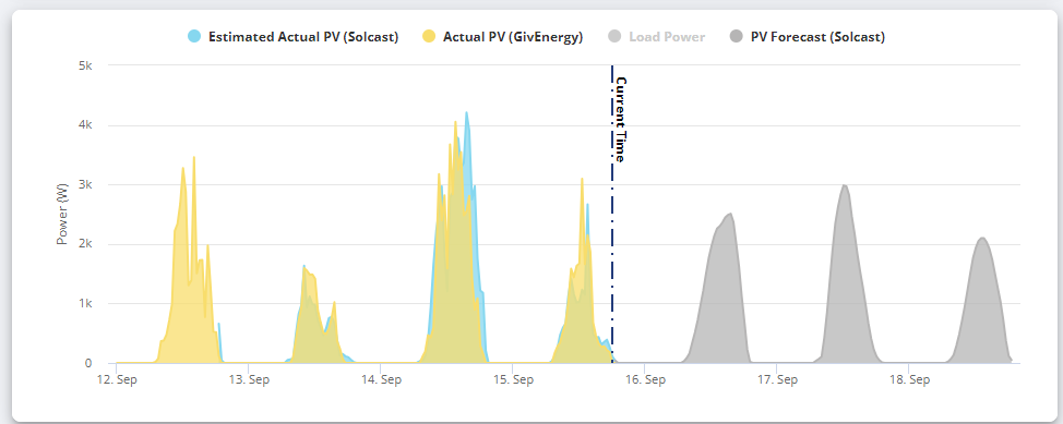

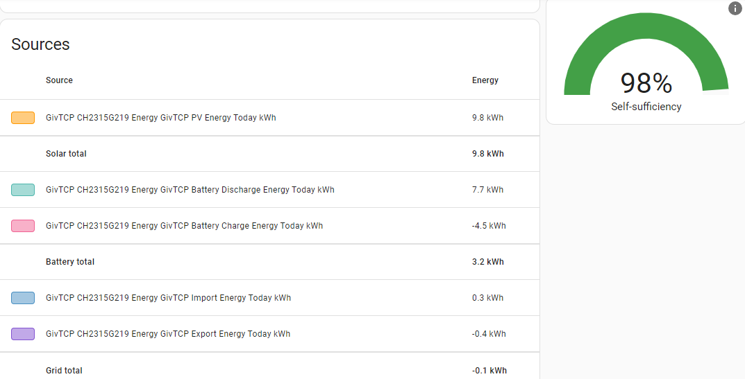

JohnMo Posted September 15, 2023 Author Share Posted September 15, 2023 So a small update and stats Have now added the battery inverter to home assistant. The main reason that I got home assistant was to automate the charging on cheap rate, but only charge by the amount required, based on how much PV generation is likely the next day. GivTCP is the app running on Home Assistant, this connects to GivEnergy Inverter via an API, it also looks up the solar forecast from Solcast - another API. Dont get E7 for a couple of weeks, so running generated solar only. Have updated the Home assistant energy page, which looks like this, this is todays stats On the GivEnergy Cloud, there is the same data, but the forecast data is also represented. Fine tuning the Solcast page for my array you make small changes to angle and direction to fine tune the forecast compared to actual, but its not too bad from the looks of it. 2 1 Link to comment Share on other sites More sharing options...

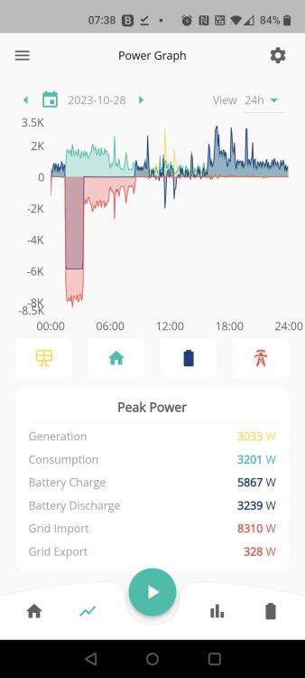

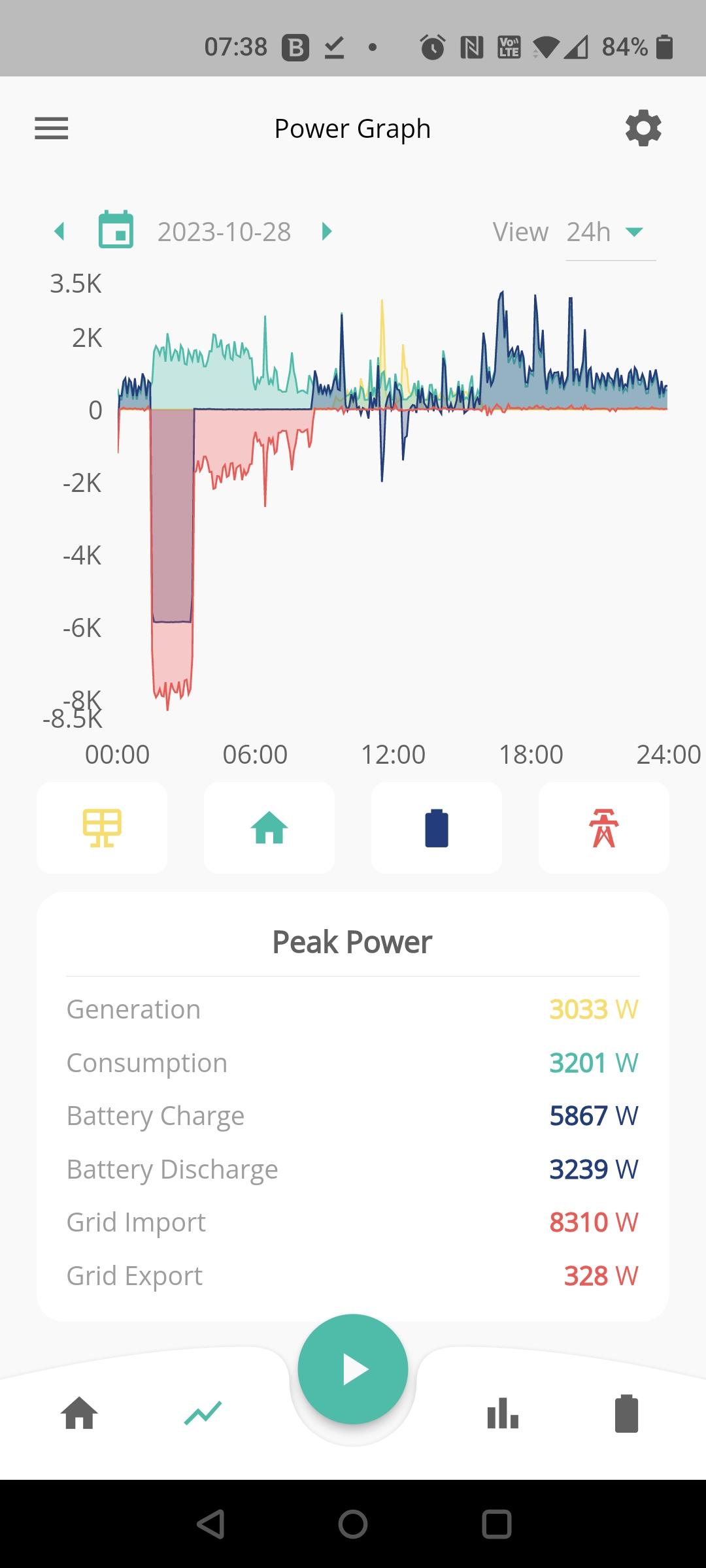

JohnMo Posted October 29, 2023 Author Share Posted October 29, 2023 For those not aware how the battery and time of use tariffs work to together, I have a screenshot from the battery app So the above is 24hr window. In this view the cheap rate period was from 01:30 to 08:30. Below the 0 line is power either being taken from the grid or being added to the battery. Above the line is consumption and solar being generated. Starting on the far left, the blue section starting at midnight is the battery being used to supply the house. At 01:30, the big dark red section dropping down is the battery being charged, the lighter red is the total imported electric for battery charging and supply to the house. Once the battery is fully charged it stays unused until the end of the low tariff window at 08:30. The red wiggly line showing electric being imported, this line stops at 0830. It's a mirror image of the consumption in green above the 0 line. Above the 0 line, the green section is mostly the ASHP running with an electric heater and other background loads. These are all running on cheap rate electric, until 08:30. The remainder of the day is the general house loads bing supplied in blue from the battery. The yellow spikes and green areas are solar either supplying the house or adding charge to the battery. The downward spikes around midday are the battery being charged via solar. 1 Link to comment Share on other sites More sharing options...
SteamyTea Posted October 29, 2023 Share Posted October 29, 2023 (edited) 28 minutes ago, JohnMo said: For those not aware how the battery and time of use tariffs work to together, I have a screenshot from the battery app Can the application show mean import and mean export over a set time period i.e. hours, days, weeks, months, years? Edited October 29, 2023 by SteamyTea Link to comment Share on other sites More sharing options...
JohnMo Posted October 29, 2023 Author Share Posted October 29, 2023 You can get various view of the data to show where electric is going and how it's being used. Not seen any mean values. Link to comment Share on other sites More sharing options...

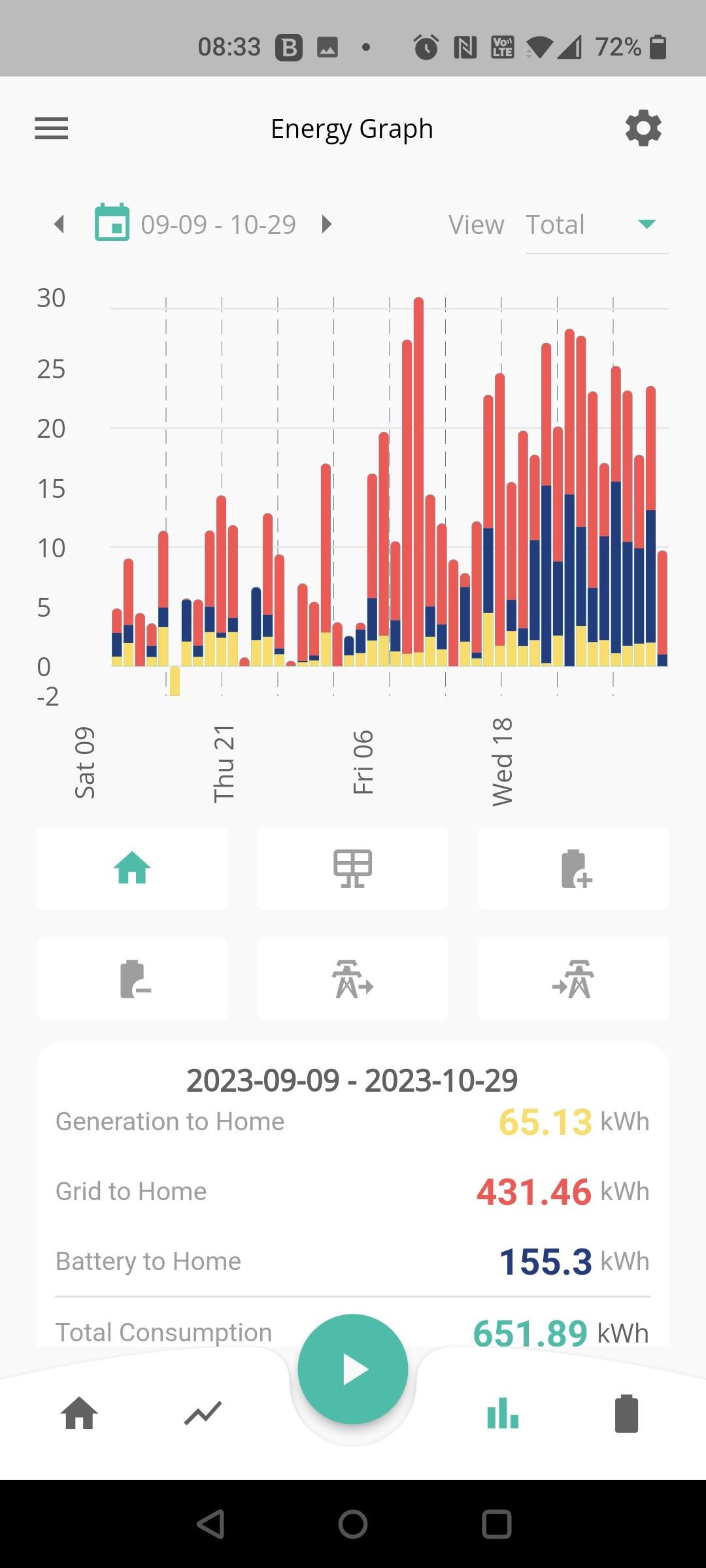

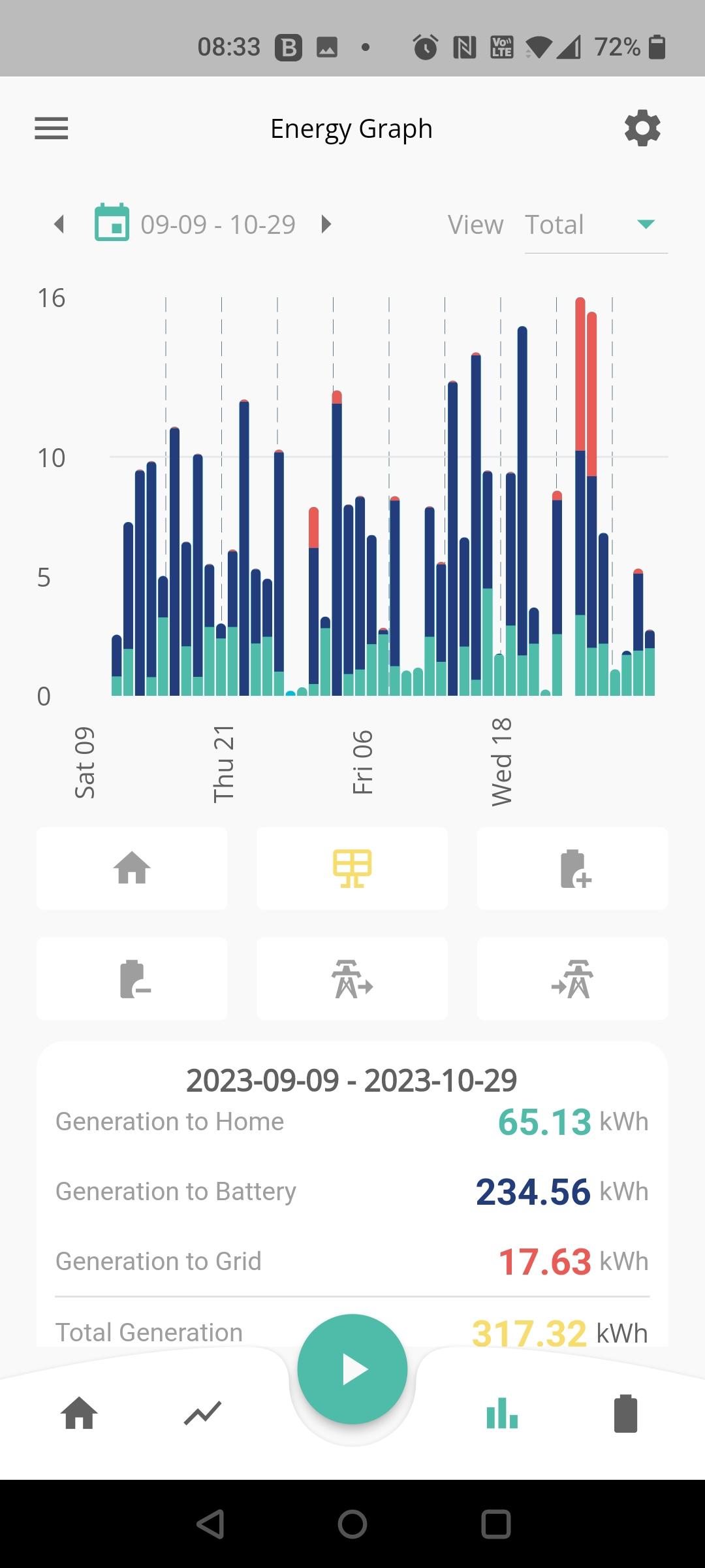

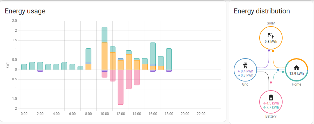

JohnMo Posted November 9, 2023 Author Share Posted November 9, 2023 Just been taking a look on the battery stats and heat pump energy usage. GivTCP set the charge last night to 62% (my defined min for this time of year), 00:30 to 07:30 is E7 period, so during that period the battery does not contribute to the house, everything is taken from the grid. Has been a pretty good solar day, 12.9kWh generated. During the E7 period, we imported 17.55kWh, for charging the battery, running heat pump and other house stuff (MVHR, treatment plant compressor etc). By 2pm the battery is at 100%, solar generation has almost stopped by 3pm and battery starts to discharge to the house. We exported 3.5kWh (this will go to hot water next week) From the ASHP electric meter (last 24hrs) we used 15kWh (last night down to zero, today although sunny didn't go over 6 deg), currently 2 degs outside. Heat pump has just ran for 2.5hrs straight with 2 defrost cycles. After cooking our tea, we have 62% battery still remaining. 4 Link to comment Share on other sites More sharing options...
