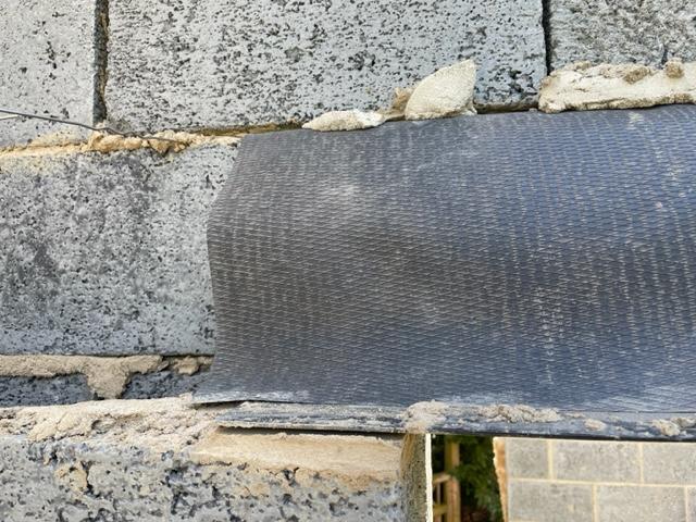

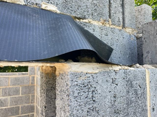

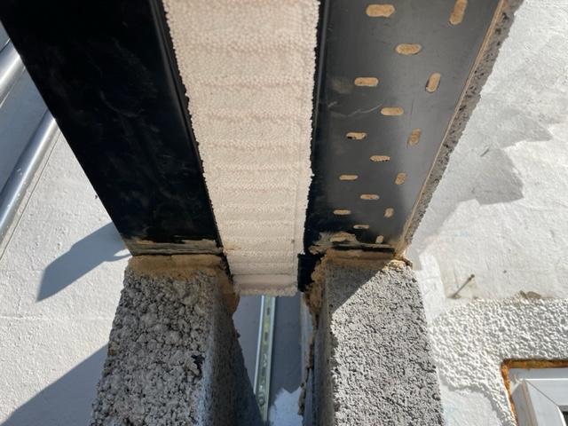

Dave Jones Posted September 3, 2023 Posted September 3, 2023 it may be the odd sizes weren't in stock. As its an outbuilding rules could be more lax. As long as the trays above the lintels are sorted i don't think id be over worried. Post some pictures. 1
Dave Jones Posted September 3, 2023 Posted September 3, 2023 it doesnt look to bad really, they are on top of the trays. Good to keep an eye out but looks tidy job. Much worse can be found on here. Do you have building control monitoring ? 1

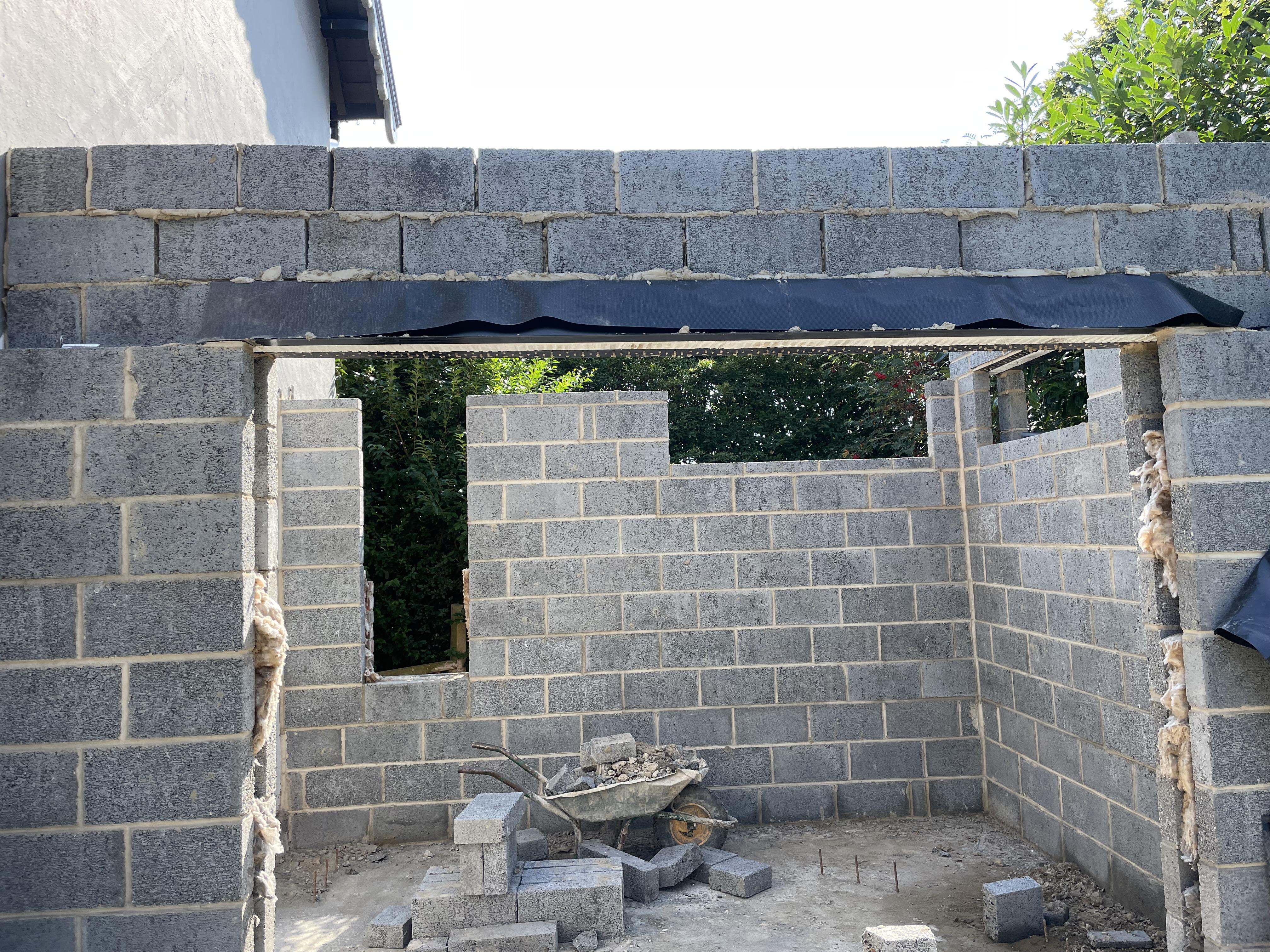

MortarThePoint Posted September 3, 2023 Posted September 3, 2023 (edited) Are you going with a duo pitch roof with the gable furthest from the existing house? What is the distance from the door to the back wall, with the barrow by it? Did you happen to see a code on the Catnic as to which type it is? Edited September 3, 2023 by MortarThePoint 1

MortarThePoint Posted September 3, 2023 Posted September 3, 2023 22 minutes ago, Lintel Woes said: Thanks for the replies I will get the measurements tomorrow and answer your questions. The door is a upvc slider with fixed panels ether side. A rough dimension would be useful. I wanted to get a feeling for the load on the door lintel. Sliders can be pretty unforgiving of lintel sag I think I've heard.
Lintel Woes Posted September 4, 2023 Author Posted September 4, 2023 The external dimensions are 4300 x 3200 and yes the roof will be a dual pitch I.e ridge at the top in the centre. They are putting an I-beam steel in for the ridge. The lintel code is covered up but appears to be 1 block high roughly 210mm and 290mm wide. Ridge height is approx 4300mm

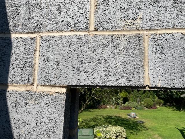

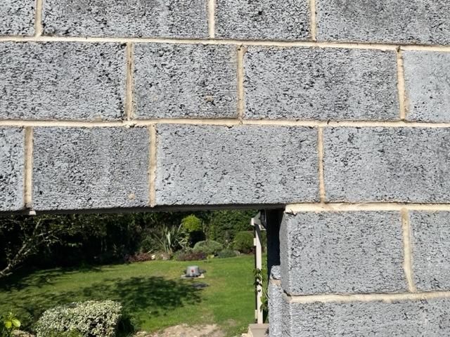

MortarThePoint Posted September 4, 2023 Posted September 4, 2023 (edited) Interesting, I guess you're having a vaulted ceiling hence the ridge steel. That helps lighten the load in the lintel. On plan, the lintel needs to support 0.8m2 of roof per m plus eave overhang. That might be 1.2m2 per m. I think slate is about 35kg/m2, so that's about 50kg/m2 on plan. Perhaps total roof load on lintel is 90kg/m then add snow etc -> conservative 180kg/m (TBC). Blockwork already on there is around 100kg/m. The bearing loads are therefore (180+100)*3 / 2 = 420kgf = 4.2kN per bearing. I think the standard Catnic at 3m has a SWL of 26kN so 8.4kN is well under that, but check. Catnic CG90/100 I'm surprised by your 8mm sag. That's span over 375. It only has 3kN on at the moment which is 10% of max SWL which is likely deflection limited at span over 300 or 0.003*span which is around 10mm. So you should only be seeing about 1mm at this point. Are you sure the floor you are measuring to is flat? What does a 1.8m level look like held under it. I think that if you have 8mm of centre deflection, you'd have about 3mm at each end of a 1.8mm level. That assumes a rotating bearing, otherwise it would be more I guess. Actually, would be good to get a laser level across it and then easier to tell. That bearing would always bug me, but I'm a ruminator by nature. At this point, it's half a day's work to rectify. You don't want to be an open cheque book, but it might smooth it if you cover the cost of the replacement lintel (about £130 I'd guess) if he takes the extra work on the chin. The blocks can be cleaned and relaid. That feels pragmatic to me as you'd be within your rights to just say fix it to him and he pays all. These things can turn ugly, but it can 'keep them honest'. You'll have to gauge the relationship for yourself. Edited September 4, 2023 by MortarThePoint 1
