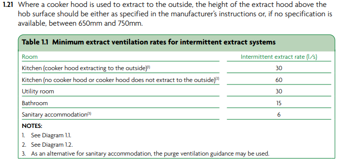

MortarThePoint Posted September 2, 2023 Share Posted September 2, 2023 Building regs require only 30 L/s if an externally venting cooker hood. Cooker hood manufacturers recommend 10 air changers per hour though which for a large room results in a much higher flow. Our kitchen/Diner is going to be 81m3 volume, so that advice would suggest a requirement for 810m3/h = 225 L/s which is 7 times the building regs requirement so seems silly. I am contemplating going smaller than that and having a max flow rate of 500 m3/h = 140 L/s which would be only 6 air changes per hour. Will I regret that or are the cooker hood sellers over egging it? What have others done here? https://assets.publishing.service.gov.uk/government/uploads/system/uploads/attachment_data/file/1045918/ADF1.pdf https://www.faberhoods.co.uk/extraction-rate-calculator/ Link to comment Share on other sites More sharing options...

JohnMo Posted September 2, 2023 Share Posted September 2, 2023 Those rates may apply to a commercial kitchen, but why you would need them in a domestic house is questionable. The further the extractor is away from the hob the less effective it is at taking away the smells and grease, so manufacturer quote stupid flow rates to get around it. 10x kitchen volume is the whole house volume or more every hour. Passivhaus did a test on extract hood flow rates and effectiveness, basically the conclusion was min allowed distance from source to fan was best and required least flow. 1 Link to comment Share on other sites More sharing options...
MortarThePoint Posted September 2, 2023 Author Share Posted September 2, 2023 It feels wrong that there was no upper limit to the flow rate. If you had a cooker hood in a warehouse you'd need a tornado of flow rate. I expected then to have a more appropriate formula for open plan living. Link to comment Share on other sites More sharing options...
Conor Posted September 2, 2023 Share Posted September 2, 2023 (edited) 38 minutes ago, MortarThePoint said: It feels wrong that there was no upper limit to the flow rate. If you had a cooker hood in a warehouse you'd need a tornado of flow rate. I expected then to have a more appropriate formula for open plan living. BCO said it was the actual working area of the kitchen within the open space. We still went with a beast in our last place at 800m³hr. For that flow rate you need mim 150mm ducting and a short run at that. New house, MVHR. Hardly ever use the (recirculating) hob extractor, not really needed. Edited September 2, 2023 by Conor Link to comment Share on other sites More sharing options...
