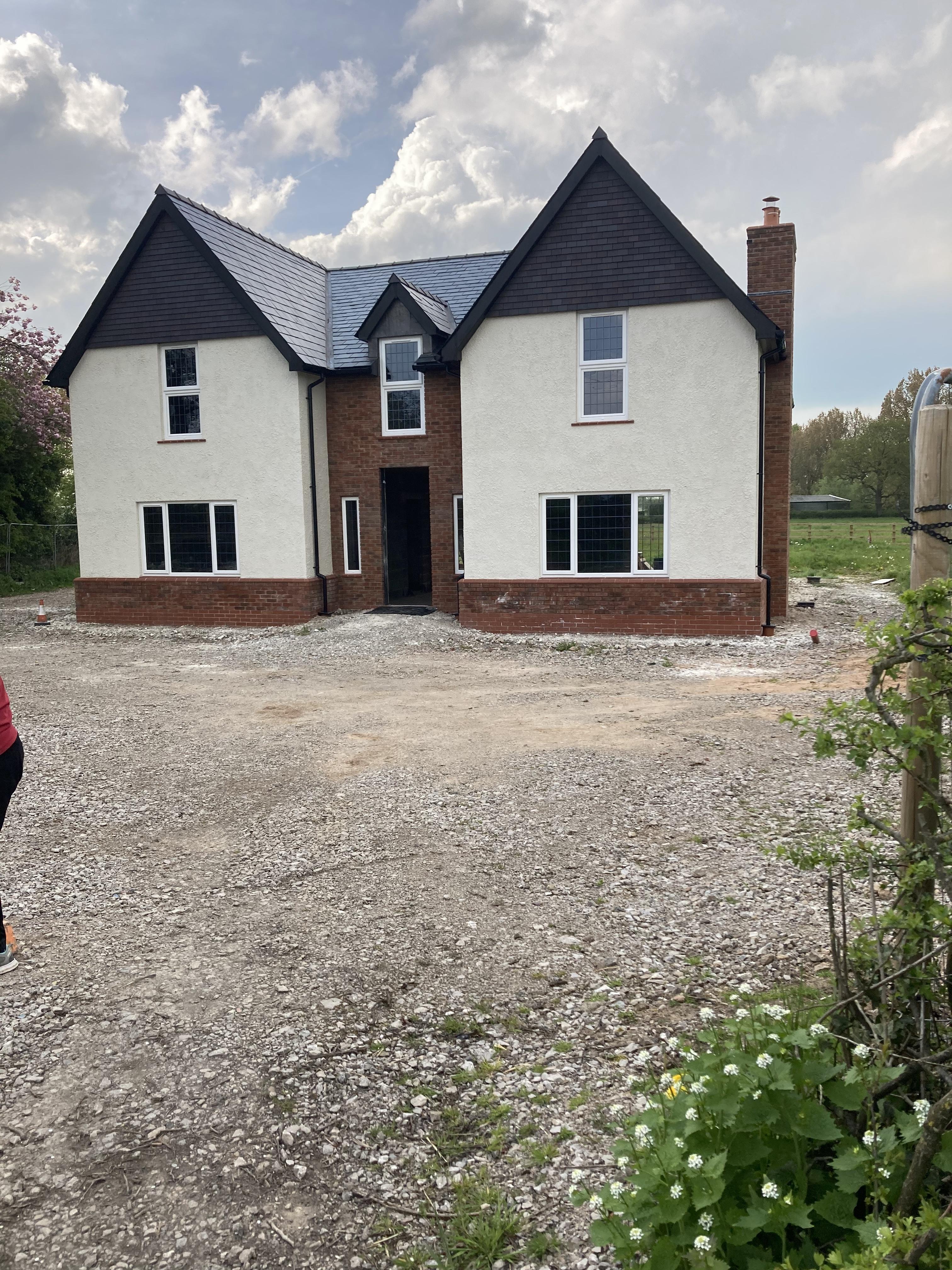

nod Posted August 30, 2023 Posted August 30, 2023 2 hours ago, Field_of_Dreams said: Your correct…the Chinese is 900 cheaper than Spanish at todays price. The point I was making is I would not class Chinese as being cheap as it higher than Spanish was a few years ago…it is just that Spanish is now at a silly price. That makes sense but the supplier I have approached give the same thickness for range for both Spanish and Chinese when comparing. They also meet the same BS standard and are graded S1 W1 T1. This is the one I am looking at https://buyroofslate.co.uk/slate/chinese/polaris-canton-ultra-500x250-chinese-slate/ I slated our first one with Spanish and made the mistake of thinking grade a1 give you a top quality slate It doesn’t It relates to the piro We returned about a 1000 twisted slate Had we used a roofer they would have been throw off the roof This time we were less trusting and Used 600x300 Estilo prime Same grade but a very flare slate with hardly any twists 5-7 mil While it took myself and my wife nearly six week to slate the house and workshop It was far easier than previous on a more complex roof 2
Big Jimbo Posted August 30, 2023 Posted August 30, 2023 @nod Still not an easy job, and looks fab. That front elevation looks great.
