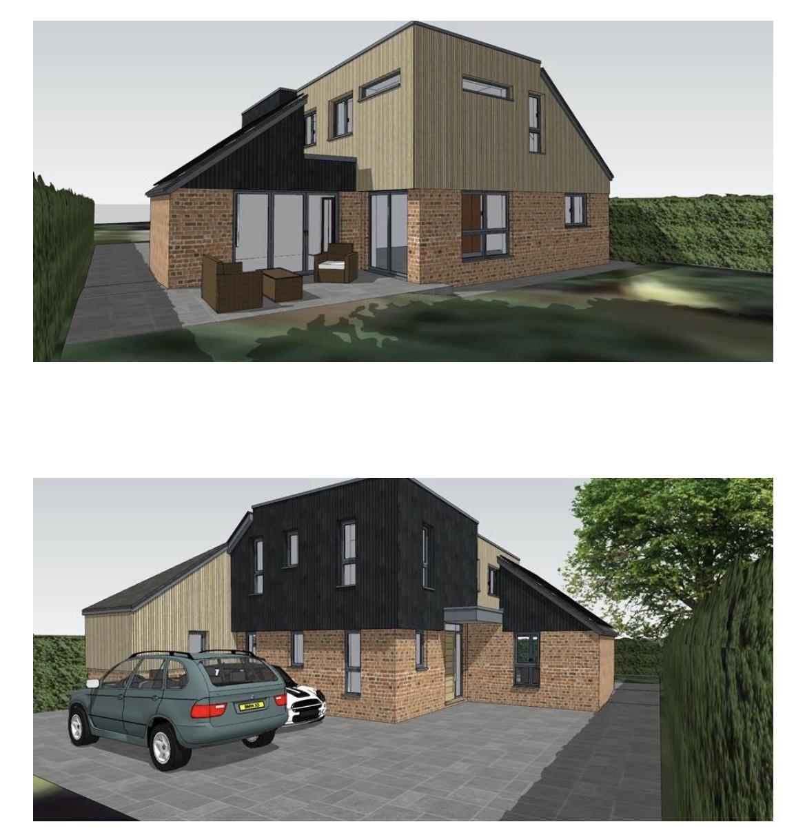

Hi all
hoping to get some cladding inspiration form people. We at the design phase for a 3 bed house and the architect has started looking at externals. We sent some ideas of what we liked and he came up with the below. I really like it and we would use reclaimed (or made to look that way) bricks. I just wondered if anyone has any ideas of what else we could consider?
the design itself is very particular to the site (matching pitch height to Nextdoor, no overlooking windows etc), so it’s the externals we need to figure out now!IMG_3647.thumb.jpeg.3e7177c9eecdad7a7dff97695cf0c9ca.jpeg

I agree. Hardie or Cembrit cement planks have the advantage that they stay looking like they do on day 1 - no colour change/fading (in my experience at least with paler colours). They also have a very low thermal coefficient of expansion (from what I can tell from specs, about 1/3 compared to composite plastic and 1/10 of uPVC. )
