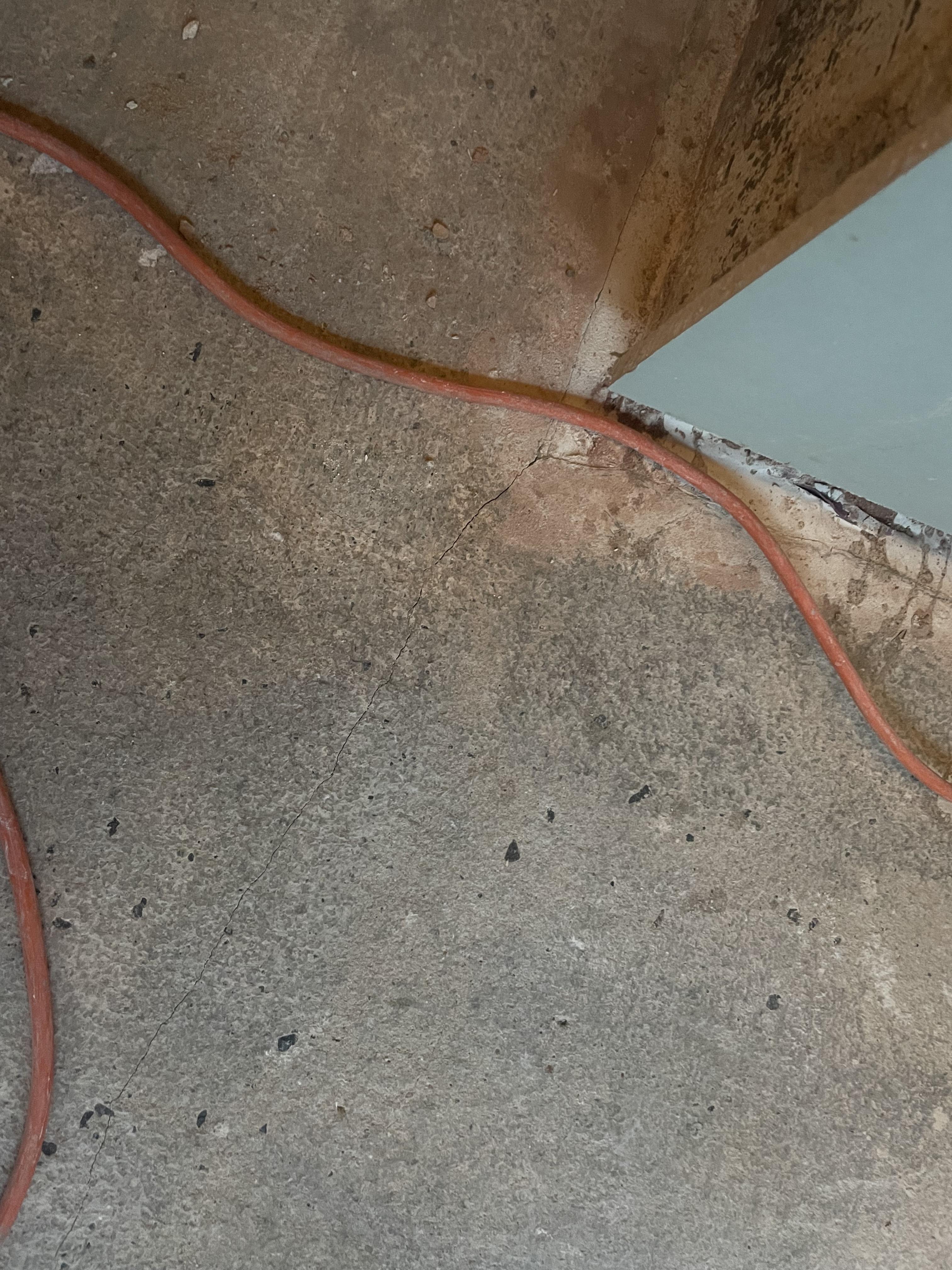

Now, originally, I hadn't even considered any form of decoupling mat. However, the slab has shown some stress fractures.
Slab is 150mm self-leveling concrete with reinforcing mesh and UFH tied to mesh. It's been laid about 6 months ago so is fully dry/cured. Cracks have appeared at doorways and other "jutty out" places, all cracks are <1mm and some are just hairline. However, they appeared at various points in the first 3-4 months (rather than all at once) but seem to have now stopped. The cracks are not linear across a threshold etc. so I can't just lay an expansion joint over it (and frankly trying to avoid any expansion joints as the "doorways" are open plan 2.0m openings.

Considered a  flexible adhesive or equivalent? If its cracked & taken the strain out of the slab it shouldn't move much more?
Wait til @nod replies as he’s the expert. We didn’t use a decoupling mat as it reduces the efficiency of the floor potentially. Ours is a smaller area and no screed cracks but used expansion gaps in the doorways and you don’t notice them if you use good ones (cheap ones looked crappy)
We (only) used flexible adhesive and had cracks propagate through the stone. Only in one place at a doorway but annoying.

If there are cracks, that's what I'd do. Look for one - such as Mapeguard UM 35, Ditra, Durabase CI++ - that can be used as both a decoupling membrane and as a crack-isolation membrane (suitable for bridging minor cracks in the subfloor that's otherwise sound).
I'd also be installing expansion joints at doorways and the recommended intervals. As Jilly says, they don't have to be obvious.

thanks everybody, UM35 it is then!
