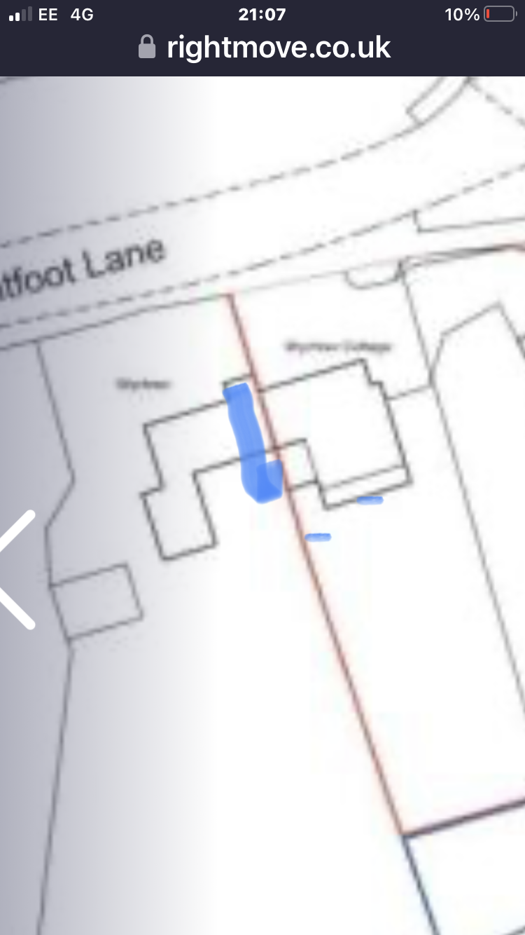

nod Posted August 11, 2023 Posted August 11, 2023 Marked in blue is the origenal tiny cottage attached to the listed farm our previous build is in there garden
