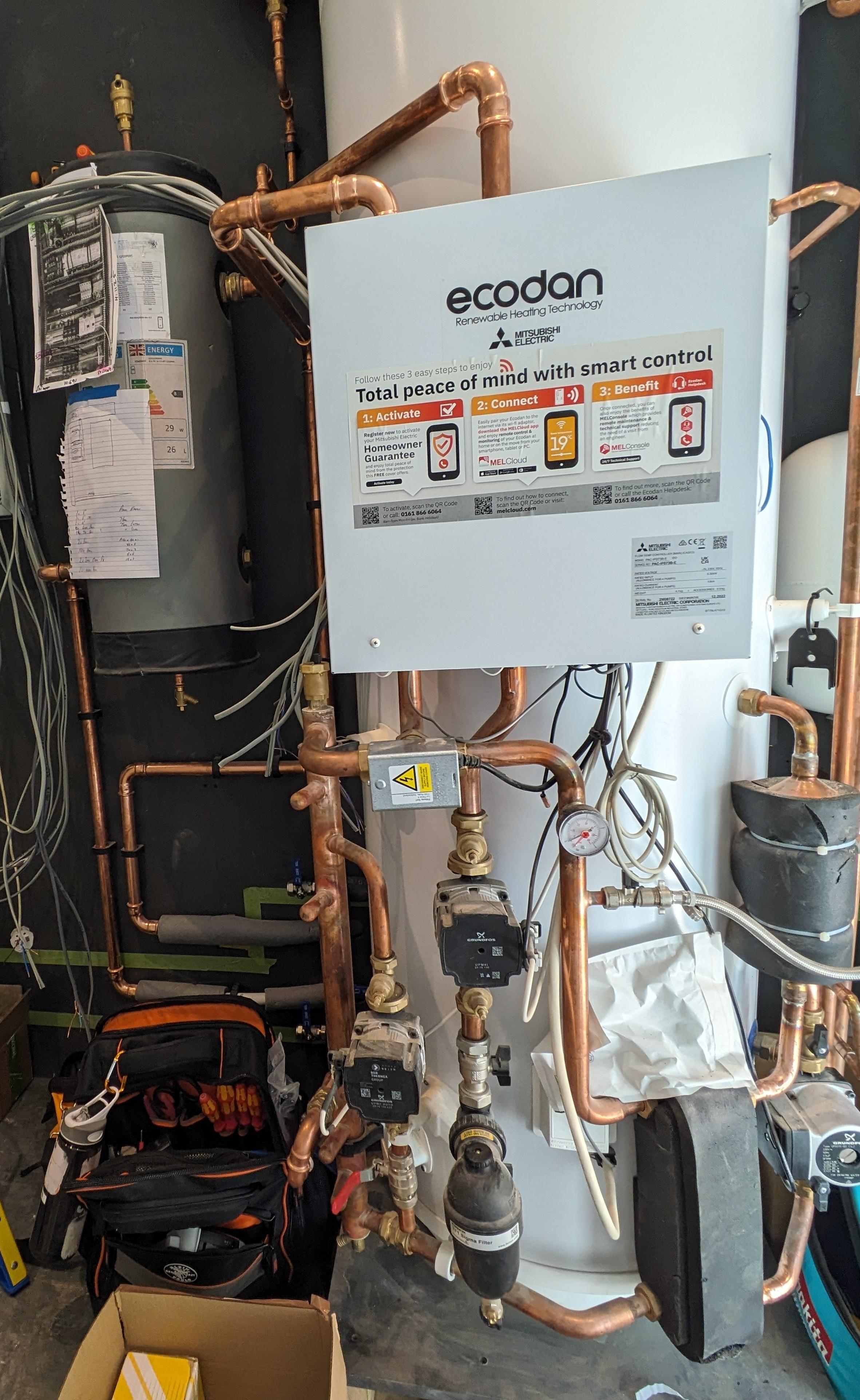

I'm working next to one of this mitsu cylinders today. I'll take a look at see if it's speed controlled, but 99% sure it isn't as the FTC6 does not have any connection for variable speed output.
(It's also a kinda mad system design as it's being used for DHW only (passivehaus, no space heating) yet had a preplumbed cylinder with a couple redundant pumps and diverter valve in circuit. And then the primary side is so tiny (in part because of the PHE) that they've had to add a 50L buffer (volumizer) in series just to meet the manufacturer minimum system volume.  Seems a lot of faff for a DHW only system.)
All that piping just for dhw?  As you say it seems kinda mad, surely a tank with integrated hp is better for this situation.
They'll have plenty of space heating I fear with all the heat leakage through those tank connections no matter how good an insulating job is done on the pipes.
It looks worse than the inside of my airing cupboard which yesterday I was easily convinced should be stripped out in its entirety.  The airing cupboard is the result of successive mods, not a one off design.

I stand corrected, the FTC6 does indeed have a output for controlling primary pump speed, and it is hooked up on the preplumbed cylinder. Marked CNPWM / WH on the motherboard.
The MIs have it on the drawings but don't mention its purpose in the text at all, which is why I've never noticed it or tried to hook it up in my own install.
Yeah other than the buffer tank (and a lot of unrelated loose WIP wiring) this is all the preplumbed cylinder you're looking at here. It is a messy job even if you do want the 2 zones of space heating, but for a DHW only system it is crazy.
Would it not be more sensible to just install a plain DHW HP UVC and sell this complicated mess?
