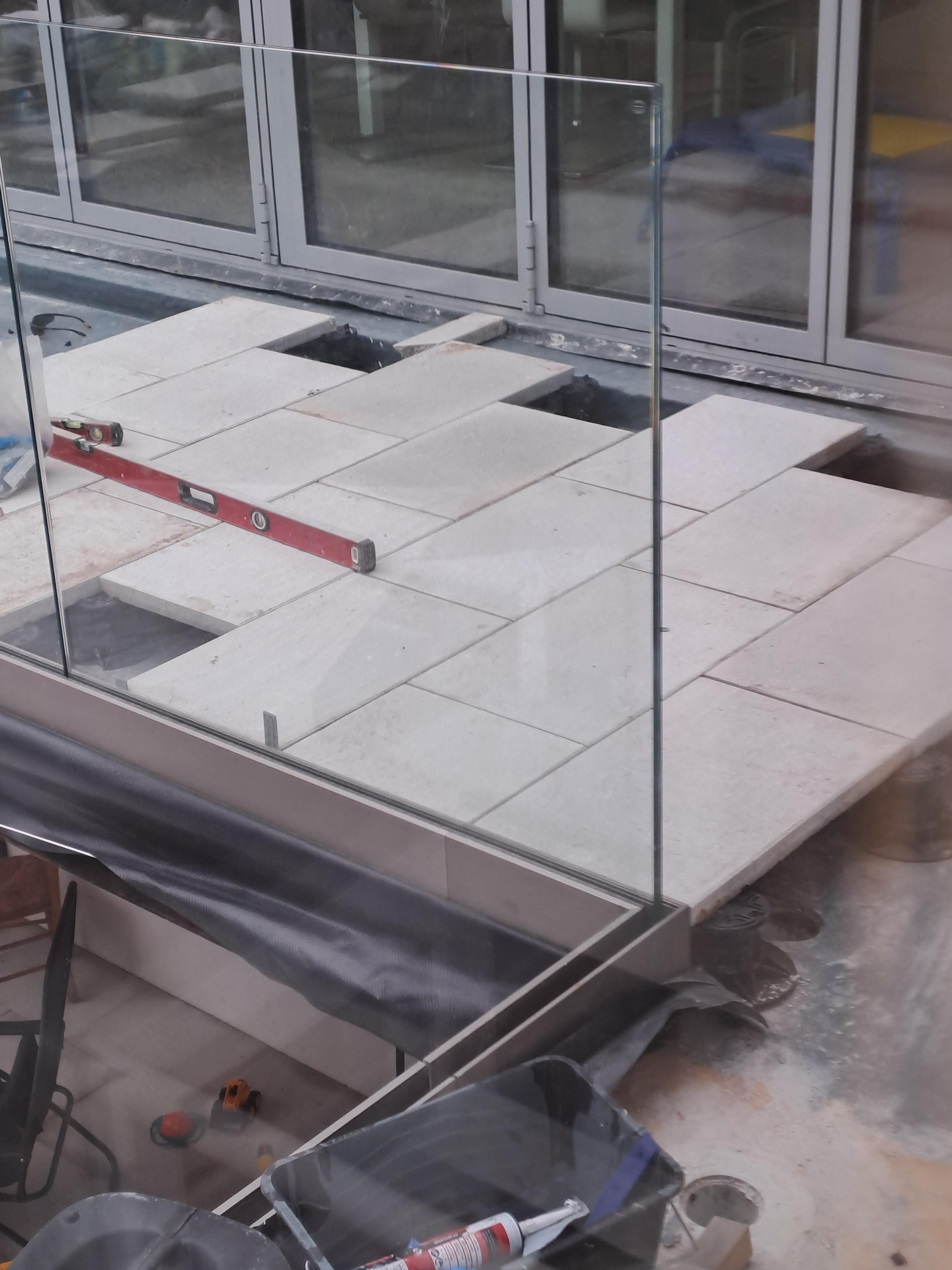

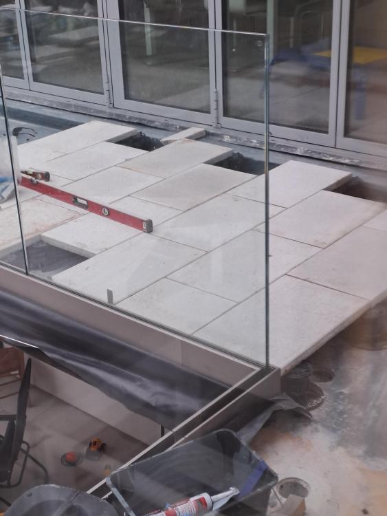

Conor Posted August 9, 2023 Share Posted August 9, 2023 Our SE said the ballustrade channel must be fixed to the steel. So we have full height glass ballustrade on top of the steel, fixed with M14 bolts. Still a work in progress. 1 Link to comment Share on other sites More sharing options...

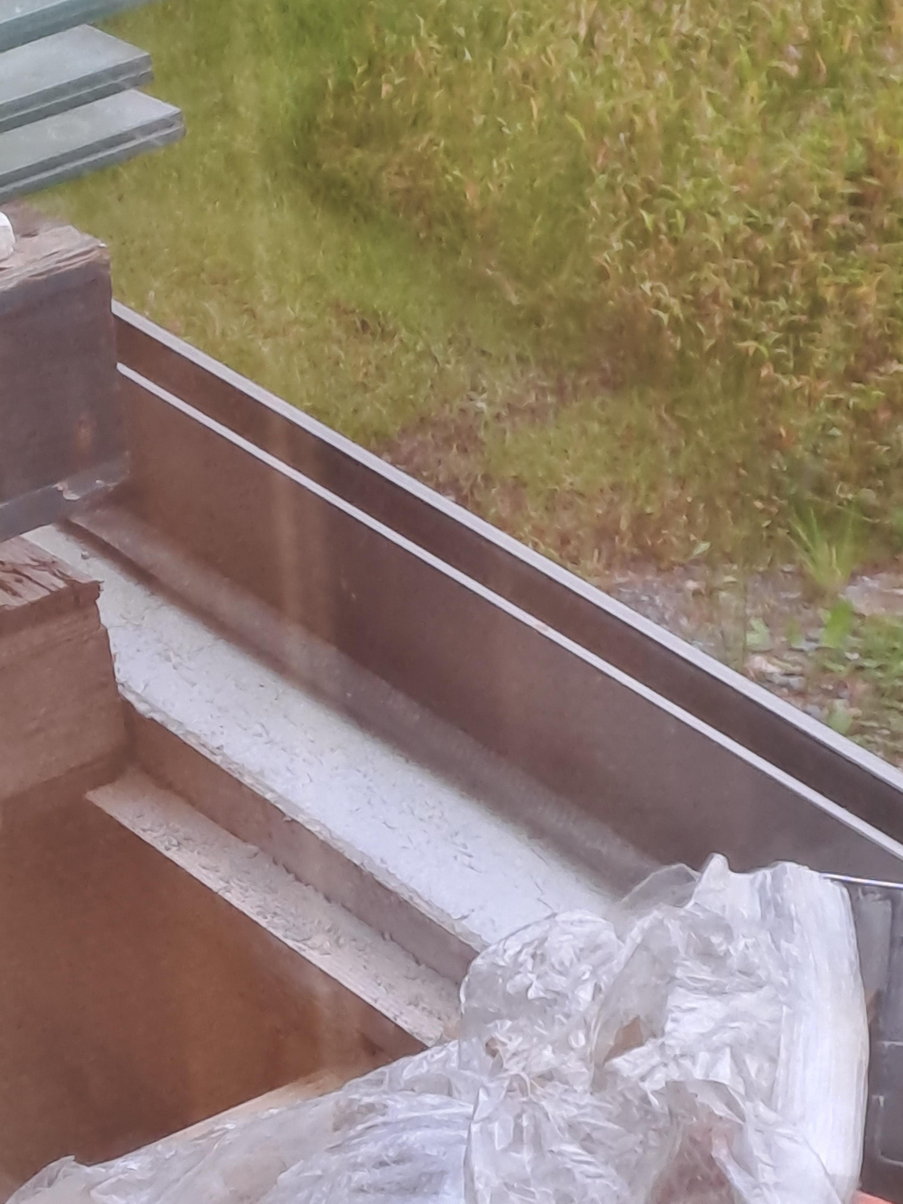

Conor Posted August 9, 2023 Share Posted August 9, 2023 We have a section running over a brick wall. Solution was to cast a 200 x400mm RC head, tied in to the brick wall below with 12mm dowels. Concrete on face will be covered with alu cladding, same as the steel section. Link to comment Share on other sites More sharing options...
