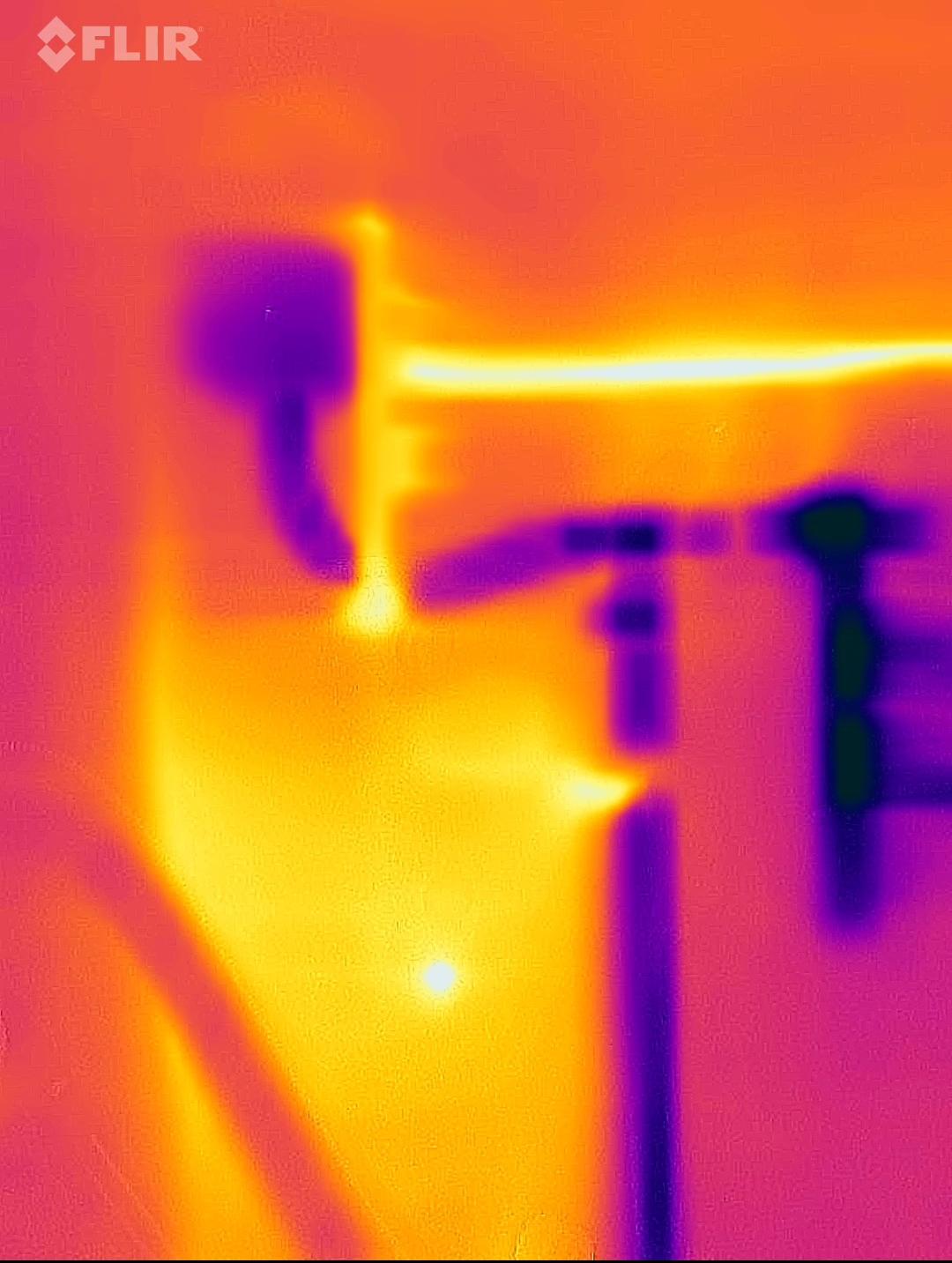

Iceverge Posted August 8, 2023 Share Posted August 8, 2023 On insulating the pipes. We had massively over dimensioned pipes installed originally by the plumber. This resulted in huge amounts of water sitting in the pipes that had to drained out of the tap before any hot water arrived. I initially tried to insulate my way out of this. Adding up to 30mm of pipe insulation in places. Tightly fitted and taped. It made almost zero difference. If you ran a tap and did the same 20 minutes later the water in the pipe had cooled to near room temp resulting in equally long hot water wait times. Far more important I think is to have minimal water in the pipes in the first place as that heat is lost anyway in a few minutes . The cylinder itself and closely connecting pipework(especially copper) looses heat all day, every day. I would take lots of care to insulate any tank fittings, especially copper and make sure nothing can heat via convention other than your hot water manifold. Looking at ours the hottest spots are a Brass blanking plug in the centre. A T+P valve on the right of the tank and a hot water pipe (uninsulated) for the shower in use at the top of shot. This is worst case for the pipe and will only be for 20mins per day. The brass blaming plug and T+P valve will be like this all day. Link to comment Share on other sites More sharing options...
