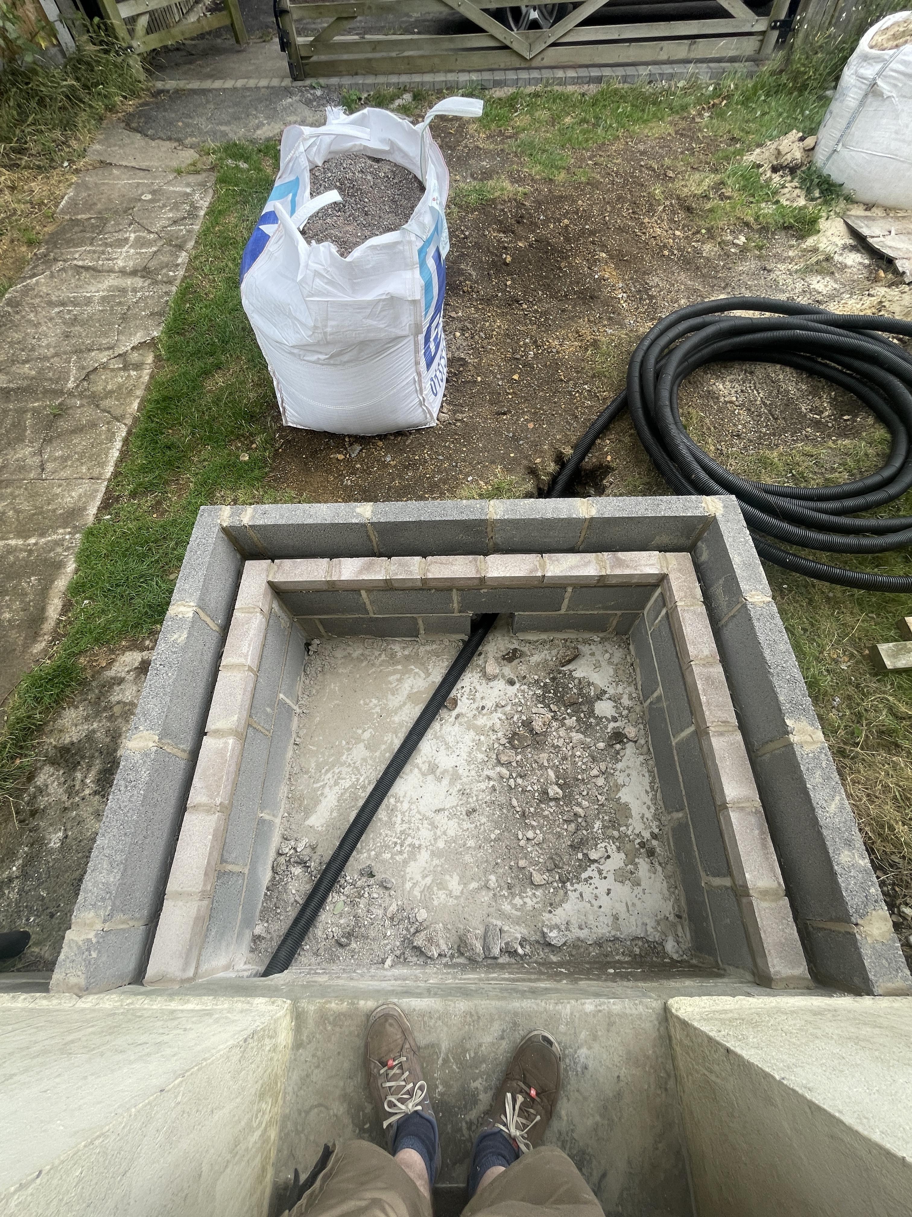

HughF Posted August 4, 2023 Author Posted August 4, 2023 Porch footings were poured a few weeks ago. We’re up to FFL for the porch now. That will give us the air lock for the hallway/main access door. We always planned to move the front door out to be flush with the front of the house. I’ll get a new/better door and fit it properly. As for the front lounge, I guess we can just do what we can. The heat loss is a toss up between ashp flow temp and rad sizing for this room. Wife wants the wall space, I want to put two 600x1500 type 22s on the wall. I think it’s able argument I won’t win. 1

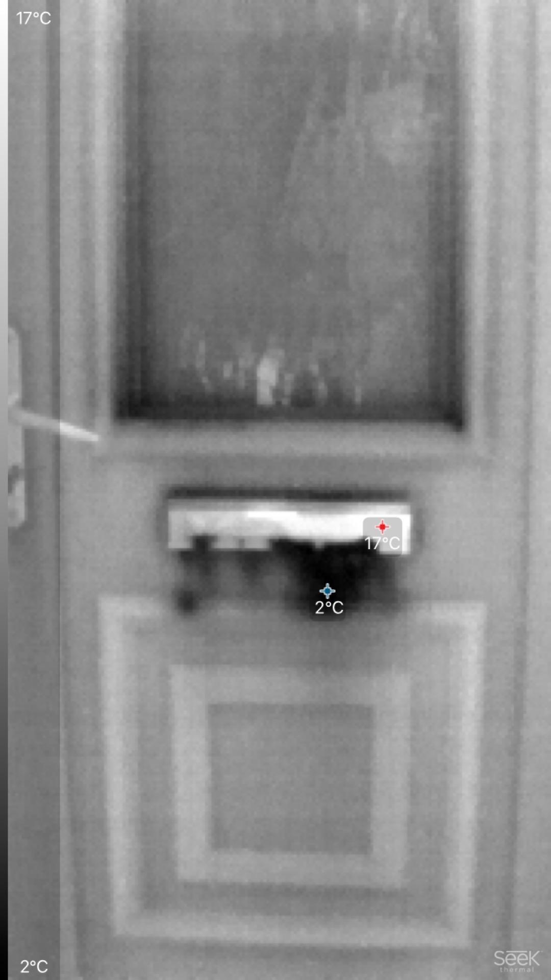

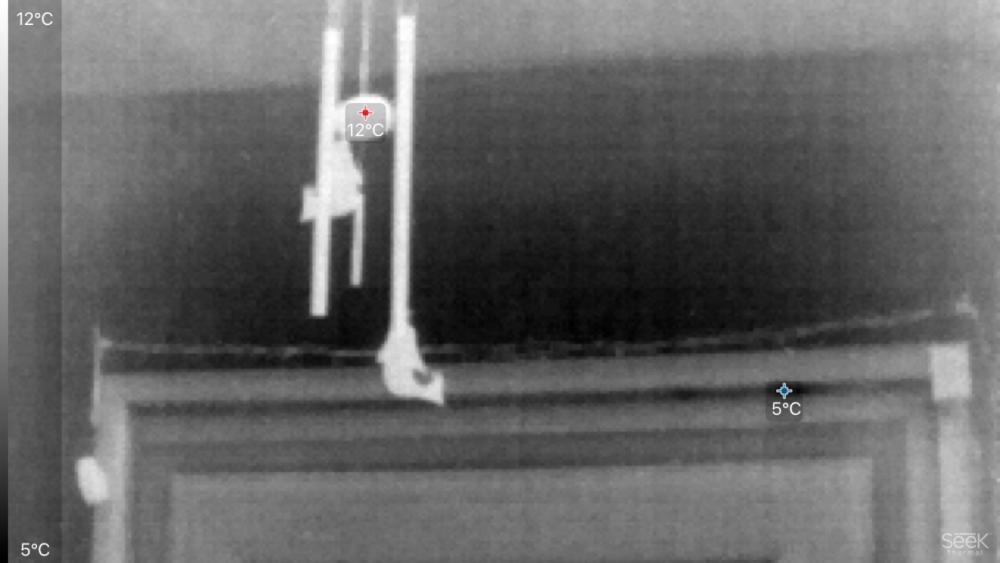

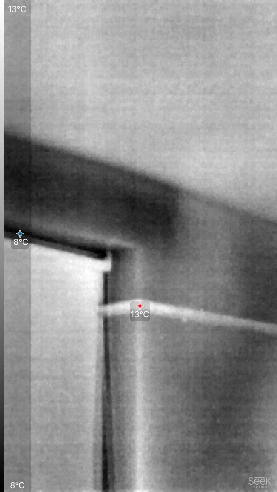

HughF Posted August 4, 2023 Author Posted August 4, 2023 These photos show the single skin blockwork above the front door, the leaks through the letter flap, and the cast in situ boot lintel above that front window. These were taken in January.
