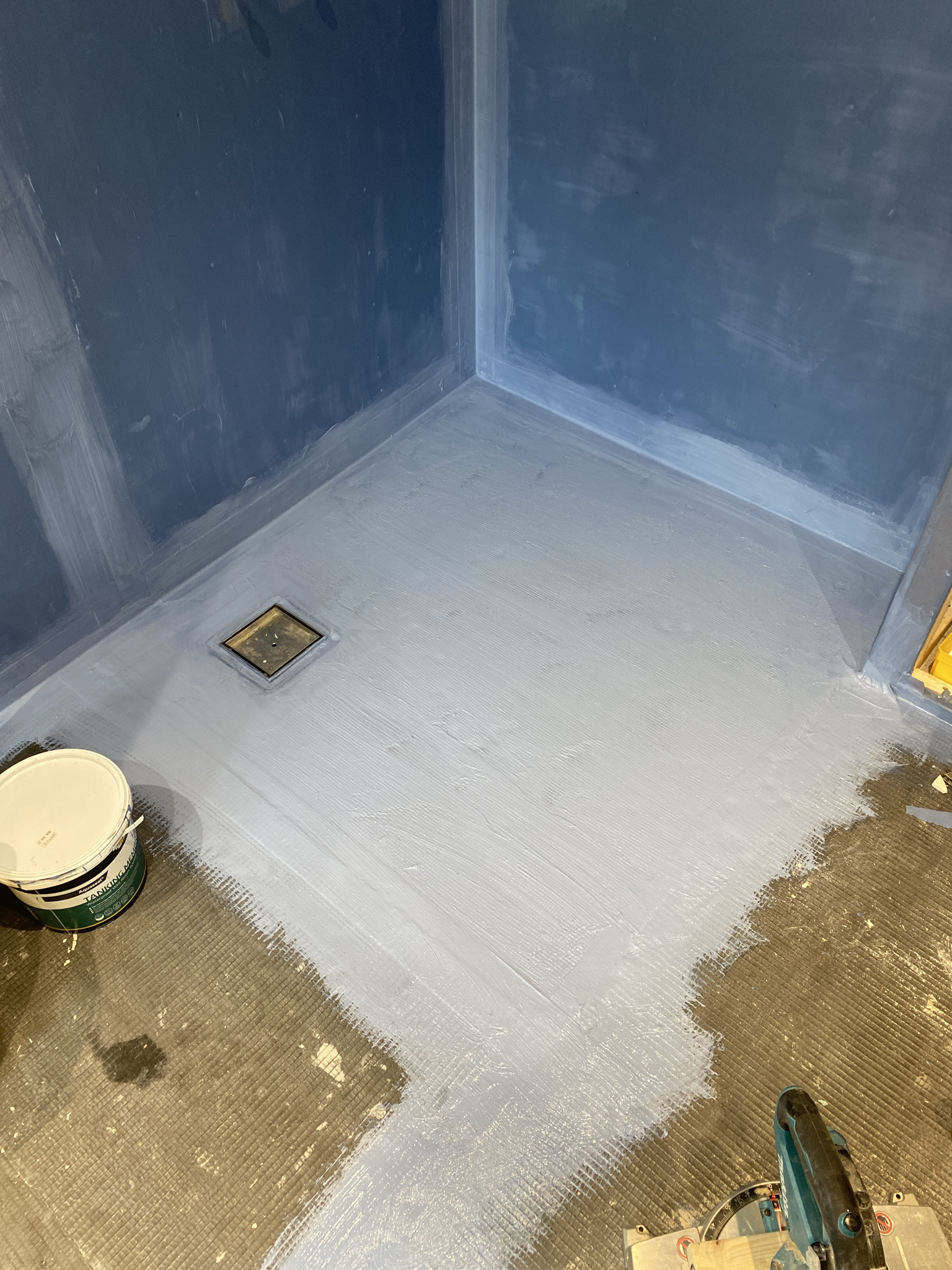

grahamA Posted August 2, 2023 Share Posted August 2, 2023 I'm looking for some advice on what options i have for the floor build up to install a wet underfloor heating system within a shower room. Most underfloor heating within showerrooms / bathrooms seem to be associated with the electric. This isn't the solution i want to use however as I have a lot of free energy in the form of hot water because of the renewable heating system we are putting in. The shower room will be located on the 1st floor and therefore the floor build up with be over existing joists. I would like to keep the floor build up to a minimum. As we are tiling the showeroom I would ideally like a backer board we can install tiles directly onto that also accommodates 12mm/16mm UFH pipes, but can't find many options here. I would also like the shower tray former be able to accommodate UFH pipes but can't seem to find any options for this unless I rout the pipework routes myself within the former? is that even possible? Any advice on what options I have and how I should build up the floor would be much appreciated Thanks Graham Link to comment Share on other sites More sharing options...

Nickfromwales Posted August 3, 2023 Share Posted August 3, 2023 Hi. Most shower trays / wetroom formers are 22mm thick and cannot be 'cut into', however there are very few instances where I've run the electric UTH (under-tile heating) wire into the wet area, as there's very little point tbh. I'm actually installing a Wedi setup atm for a client, and have allowed for the main areas / circulation space to be serviced by the UTH but not the wet area. When the shower is running, you'll only need a couple of degrees to raise the floor (wet) area to where you perceive it as "comfortable" (that has a thousand definitions btw) so I doubt it is worth making this job such a PITA. There's a few solutions for the wet UFH in the bathroom, but I am a fan of (correctly installed) aluminium spreader plates. Then you just install 22mm P5 'weyroc' flooring with ply atop, and tile away. This isn't a very 'reactive' floor heating system as there is a lot for the heat to get through, hence it is very few instances where you see wet UFH in just a bathroom. The economics of just running that on its own for eg would not make much sense but with your circumstances it likely won't matter as you'll likely have the heating 'ticking over' vs on or off? You will defo need this to be on its own manifold with its own thermostatic valve, if there's not UFH elsewhere in the home? If that is the case, you can possibly get away with just having a pump and a TMV at the buffer tank sending tempered water direct to this individual 'zone', but we'd need much more info about the system to advise definitively. If you have this amount of renewable / lo-cost energy available, I'd make like easy and install UTH which you can run over any wetroom former etc. If you install the tiles over insulation tile boards as I am doing here, then the heat up time will be massively reduced and then it can just be timed for set-back operation, switching between comfort and economy temp to make it energy efficient. 1 Link to comment Share on other sites More sharing options...
Nickfromwales Posted August 3, 2023 Share Posted August 3, 2023 That’s 1200mm deep x 1400mm wide total width which will take a cubicle 1200mm return x 1000mm in-fold door. I see no reason to heat that area, given it’s a 1st floor bathroom that will always be at or above ambient, but I have run UTH over them before (at the clients request (insistence)). Most say they barely ever bothered with it tbh, where it was a 1st floor bathroom. Link to comment Share on other sites More sharing options...
