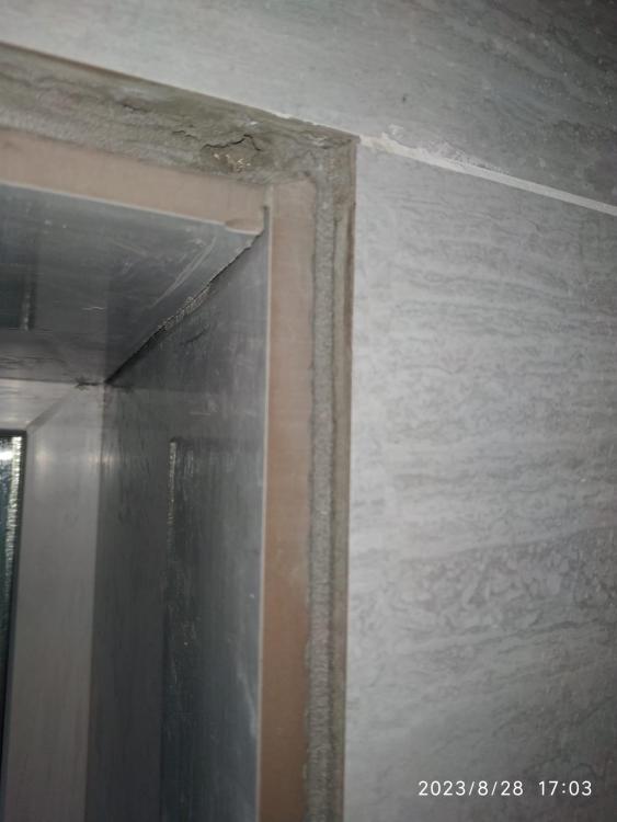

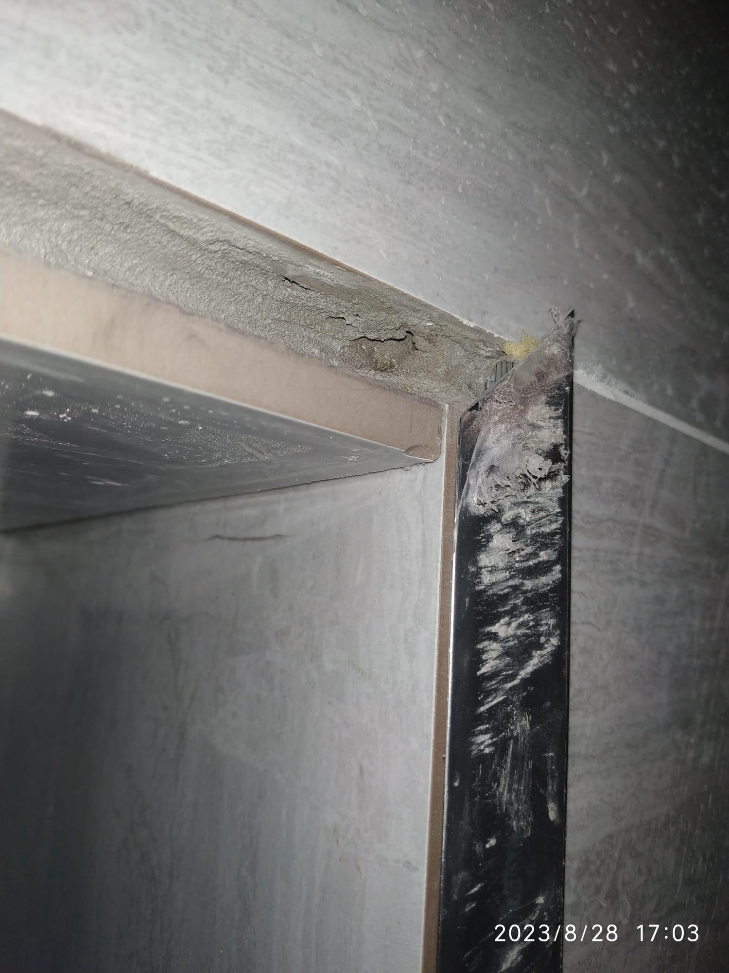

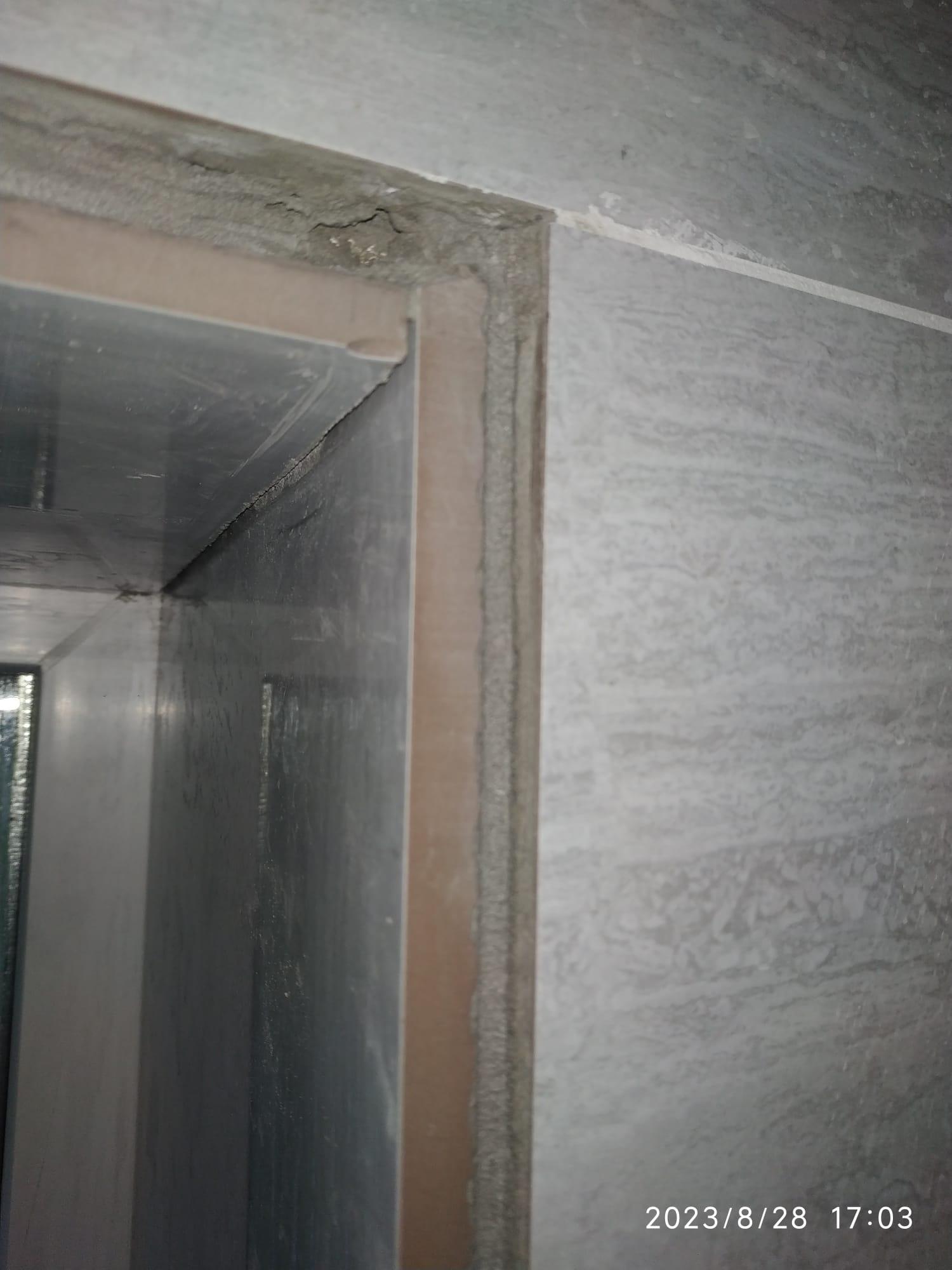

JohnBishop Posted August 16, 2023 Author Posted August 16, 2023 I have installed the tiles around the window however because these trims don't have long enough anchor I was not able to just attach them with tile adhesive. It would be too messy anyway. What is the best to attach these trims? Should I use silicone?
JohnBishop Posted August 28, 2023 Author Posted August 28, 2023 Hi again, I have these threshold trims cut. Can someone tell me how can I attach them?
