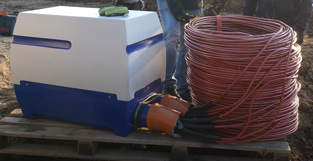

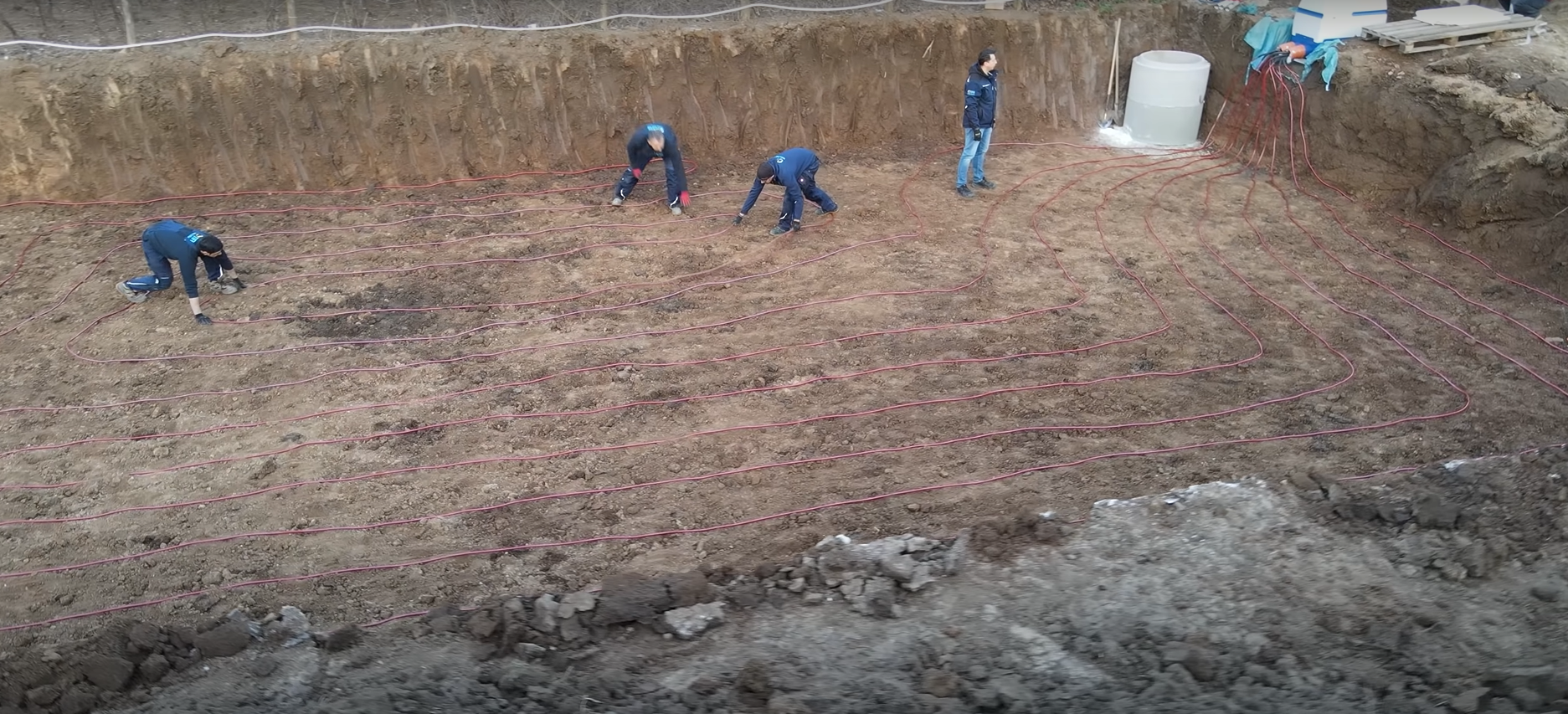

markocosic Posted July 25, 2023 Share Posted July 25, 2023 1 hour ago, HughF said: I'm a member of the Polish 'heat pump open source monitoring' facebook group Link? I'd be tempted to wrap a couple rolls of brake pipe around the hot water tank to see what a 2.5 kW class mini split can do. A better idea might be to keep it all outside. Any idea what this uses as a collector? https://www.heliotherm.com/en/geothermal-heat-pump-direct-expansion.html Link to comment Share on other sites More sharing options...
markocosic Posted July 25, 2023 Share Posted July 25, 2023 6 hours ago, Beelbeebub said: Be nice if it was a simple as a radiator swap. https://e-brgroup.eu/lt/kondicionavimas/2772-dezute-potinkine-su-dangteliu.html Bury those in the walls along with the fridge pipe /drain pies and cable conduit and it's as good as a rad swap. Lift. Undo cable. Unbolt two pipes. Remove old bracket. Bolt on new bracket. Flare pipes on new head to suit existing. Connect wires on new head to existing. Divert condensate drain into box. Job good. Nothing need line up particularly. When everything is surface mounted or rigidly fixed to suit a given head is when waps are hard. @Nickfromwales did you build the man cave yet? Want a couple of those "AC back boxes" bringing back? 55 mm depth suits 45 mm battens and a sheet of plasterboard. Link to comment Share on other sites More sharing options...
DanDee Posted July 25, 2023 Share Posted July 25, 2023 23 minutes ago, markocosic said: Any idea what this uses as a collector? https://www.heliotherm.com/en/geothermal-heat-pump-direct-expansion.html Plastic Coated Copper Pipe 1 Link to comment Share on other sites More sharing options...

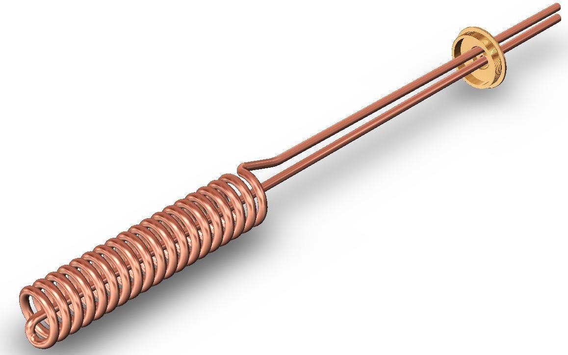

HughF Posted July 26, 2023 Share Posted July 26, 2023 19 hours ago, sharpener said: There's a proprietary device for doing exactly this, mentioned in the Mixergy-lite thread IIRC. Link to comment Share on other sites More sharing options...
JohnMo Posted July 26, 2023 Share Posted July 26, 2023 Is coil size is a bit small? Link to comment Share on other sites More sharing options...
sharpener Posted July 26, 2023 Share Posted July 26, 2023 57 minutes ago, JohnMo said: Is coil size is a bit small? Yes, it struck me that way, there was some earlier discussion (and a link to the Solarcoil website) in this thread but I don't think we found an answer. Link to comment Share on other sites More sharing options...
HughF Posted July 26, 2023 Share Posted July 26, 2023 1 hour ago, JohnMo said: Is coil size is a bit small? On what? Link to comment Share on other sites More sharing options...
JohnMo Posted July 26, 2023 Share Posted July 26, 2023 20 minutes ago, HughF said: On what? On this 2 hours ago, HughF said: Link to comment Share on other sites More sharing options...
HughF Posted July 26, 2023 Share Posted July 26, 2023 (edited) 3 hours ago, JohnMo said: On this As long as you ‘roughly’ replace the surface area of the mini splits internal unit pipework, and position the mid pipe sensor in the correct spot, the EEV will take care of the rest. Or were you thinking I was going to put hot water through it? I wasn’t….. Edited July 26, 2023 by HughF Link to comment Share on other sites More sharing options...
JohnMo Posted July 26, 2023 Share Posted July 26, 2023 25 minutes ago, HughF said: 29 minutes ago, HughF said: As long as you ‘roughly’ replace the surface area of the mini splits internal unit pipework, and position the mid pipe sensor in the correct spot, the EEV will take care of the rest. Or were you thinking I was going to put hot water through it? I wasn’t….. Agreed, but the coil dia looks too big and too short. I thought they small dia and a quite a few meters of pipe? Link to comment Share on other sites More sharing options...
HughF Posted July 26, 2023 Share Posted July 26, 2023 (edited) 8 minutes ago, JohnMo said: Agreed, but the coil dia looks too big and too short. I thought they small dia and a quite a few meters of pipe? Apparently the solarcoil is 10mm tube, which closely matches the 3/8” tube in my indoor unit. I’ve got some dimensions somewhere…. I suppose a dual coil direct cylinder with a pair in series would be a good bet. The biggest issue is gutting the indoor unit of all its required parts, and boxing them up into an enclosure. Mini splits don’t work without the indoor unit being complete and fault free. Edited July 26, 2023 by HughF Link to comment Share on other sites More sharing options...
