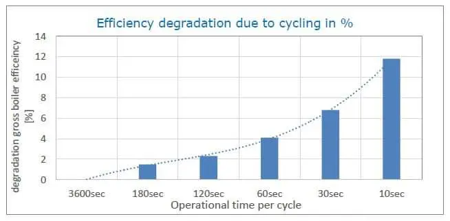

John Carroll Posted 17 hours ago Share Posted 17 hours ago Don't know what your boiler outut is, but based on 26kw then a 50sec off time means (assuming a stat hysteresis like mine of 10C) a average heating demand of 17.6kw. I did a few calcs some time ago for someone who was considering installing a buffer, (he didn't), you might find the attached interesting, you can stick in your own numbers. Also attached is the effect of cycle times on boiler efficiency, its not a awful lot except you have a hughly overrated boiler. Oil Fired Boiler Cycle Times SD Rev0.xlsx Link to comment Share on other sites More sharing options...
