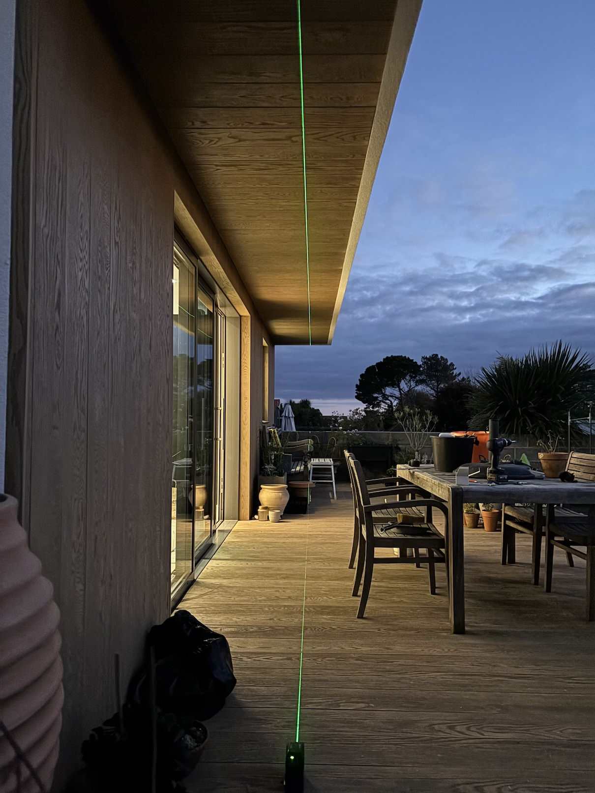

markocosic Posted July 22, 2023 Posted July 22, 2023 We also considered this. Rejected it because it's an invitation for wasps/hornets etc to make home behind the boards; and those little swines will much straight through any membranes (which must now by UV proof) that you have behind there. We used decking on the deck (120*28 mm nominal) and square edge overlapping cladding (145 mm; overlap meant for 10 mm nominal space between boards) on the walls. https://www.statybumedis.lt/lygi-terasa-28x120mm-ab-kat-iki-5proc-c-kl-pusis-impr-giluminiu-budu-ruda74576-1-65886.html https://www.statybumedis.lt/vertikalios-su-5mm-tarpuku-20x96120145mm-c-kl--egle-siurkstus-pav74541-1-60518.html Wound up like this. Decking still to be cleaned/coated. (we were waiting for excess brown dip coat to rinse off and weather a little) Cladding for a tinted acrylic dispersion from Cetol; to keep it "weathered look" rather than they "mmmmm yellow" that it would turn if given only a clear coat.

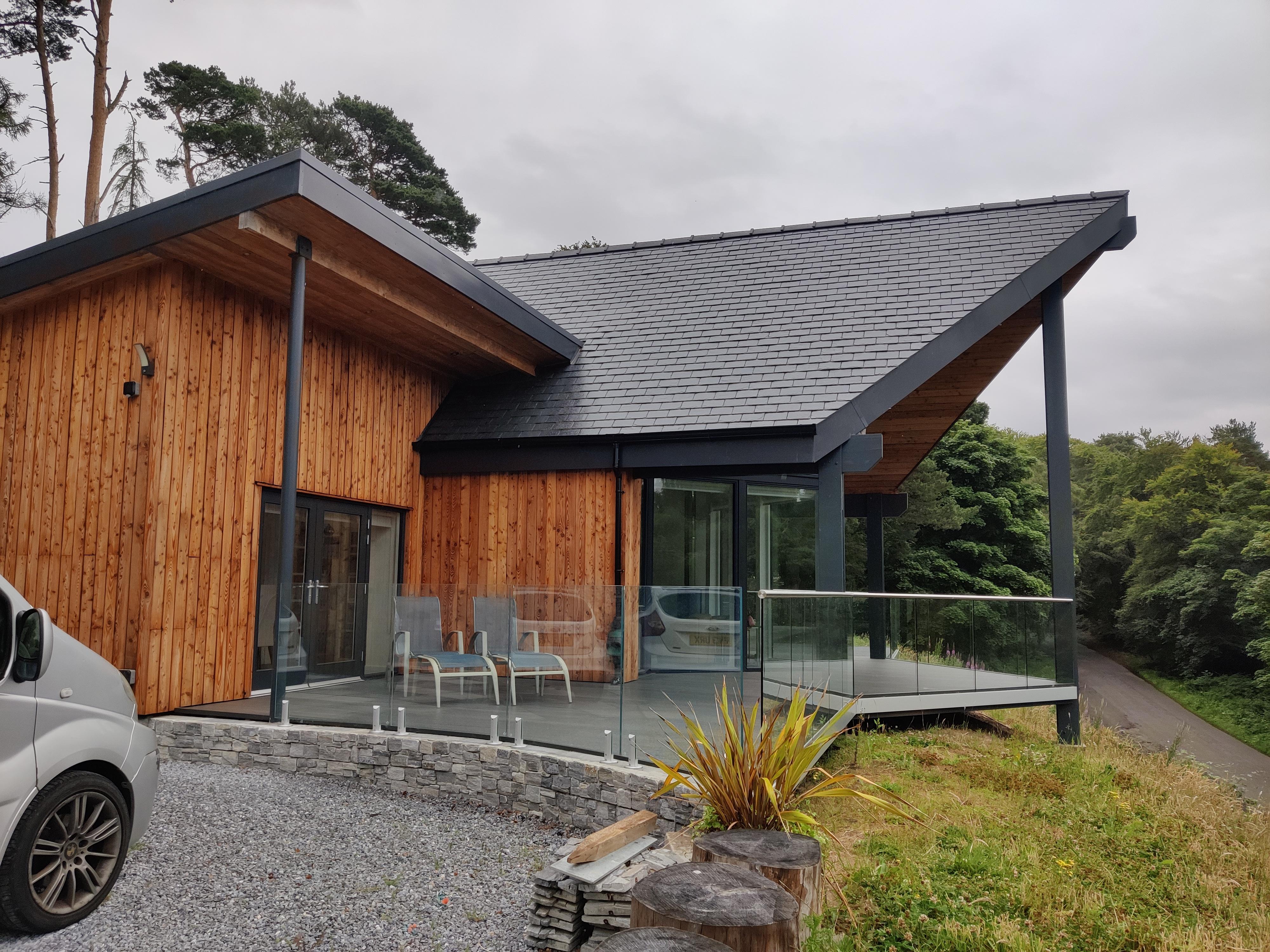

Kelvin Posted July 22, 2023 Posted July 22, 2023 We are doing Scottish Larch board on board cladding and thermopine decking. We’ve had the same debate about which way to run the decking. Haven’t decided yet.

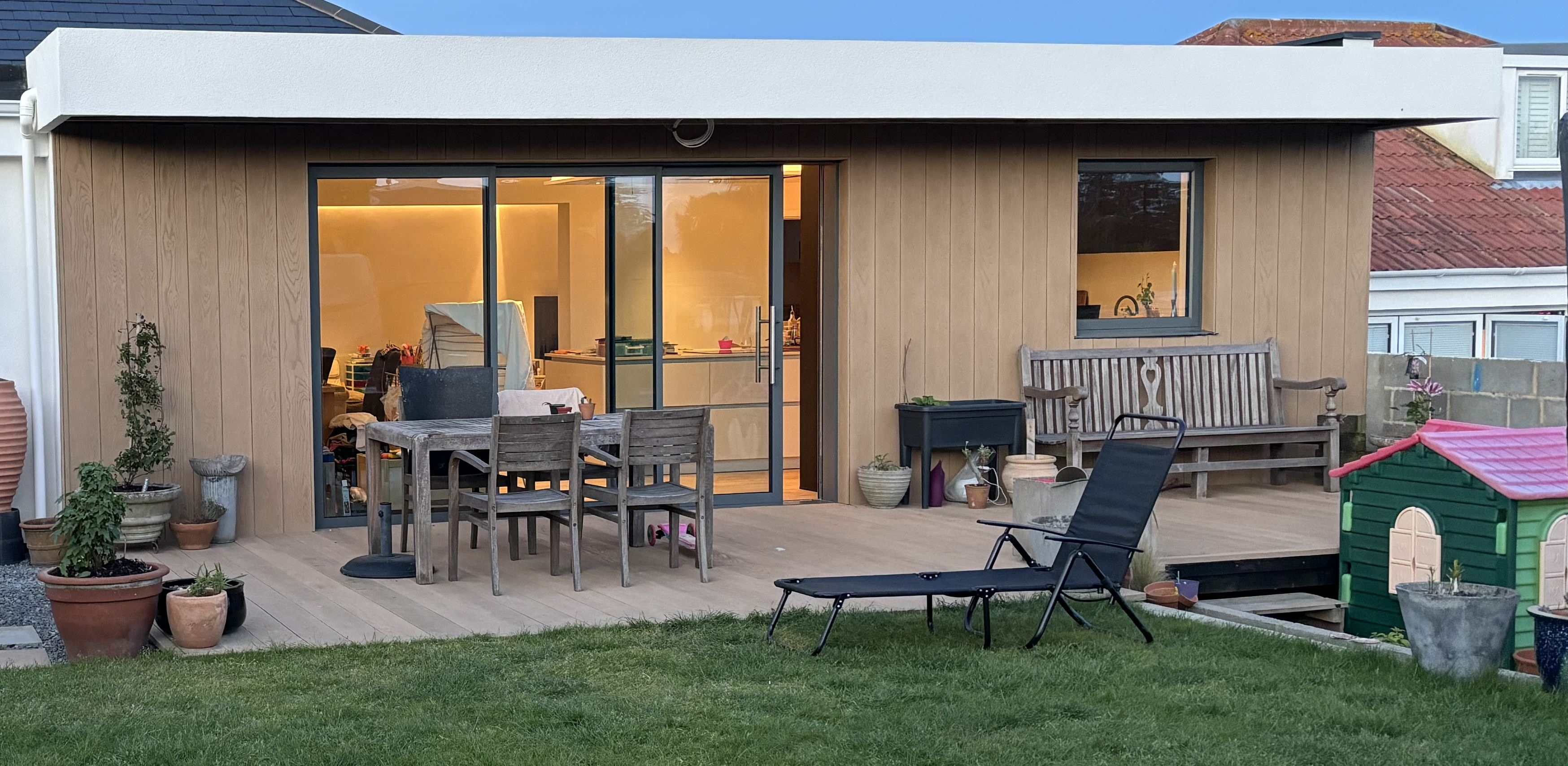

phatboy Posted April 15, 2025 Author Posted April 15, 2025 (edited) 10 hours ago, Great_scot_selfbuild said: @phatboy what did you go for in the end? We're at the stage of investigating cladding options. It'll be composite (for both the vertical cladding and decking). We have considered the Millboard for various reasons, but the cost is off the charts, so may struggle to make the budget work. Interested in what you did if you'd be happy to share? Hi, we did go with Millboard in the end. It was hugely expensive (£8000 including fixings) for both decking and cladding. This is it, in Golden Oak: It is very nice and we are very happy with it. Spent a lot of time fitting it, as any wrong cuts were worth a lot of money! It's unpleasant stuff to work with, the resin dust is very itchy. But the results are very good, and it doesn't expand or contract in changing weather. Edited April 15, 2025 by phatboy 1 1
