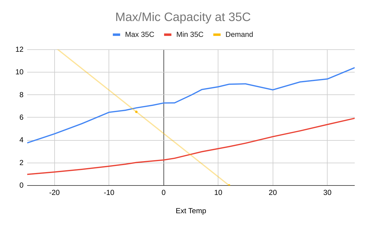

Beelbeebub Posted July 29, 2023 Author Share Posted July 29, 2023 I redrew the common capacity vs demand graph using the figures for the 5kw york and a made up house thay uses 6kw at -5 and 0 from 12C. as you can see there is a significant "zone" below about 5C where the demand is less than the minimum, and we are likely to spend more time between 5 and 12C than below 5C. What is the issue with cycling? I know it is bad, but why? Is it wear on the pump? is it efficiency? How does the short cycling affect efficiency? Link to comment Share on other sites More sharing options...
JamesPa Posted July 29, 2023 Share Posted July 29, 2023 25 minutes ago, Beelbeebub said: I redrew the common capacity vs demand graph using the figures for the 5kw york and a made up house thay uses 6kw at -5 and 0 from 12C. as you can see there is a significant "zone" below about 5C where the demand is less than the minimum, and we are likely to spend more time between 5 and 12C than below 5C. What is the issue with cycling? I know it is bad, but why? Is it wear on the pump? is it efficiency? How does the short cycling affect efficiency? Start up losses, wear, and it means you are running at a higher ft than is really needed. Link to comment Share on other sites More sharing options...
DanDee Posted July 29, 2023 Share Posted July 29, 2023 (edited) 37 minutes ago, Beelbeebub said: I redrew the common capacity vs demand graph using the figures for the 5kw york and a made up house thay uses 6kw at -5 and 0 from 12C. as you can see there is a significant "zone" below about 5C where the demand is less than the minimum, and we are likely to spend more time between 5 and 12C than below 5C. What is the issue with cycling? I know it is bad, but why? Is it wear on the pump? is it efficiency? How does the short cycling affect efficiency? The issue with the hp cycling uncontrolled is to many unnecessary start stops(wear). Depending on the HP it can have an effect on efficiency or not. I cannot tell you exactly what and how, but some HP's are running efficiently only after the initial 5-10 minutes, other from the start. Some are unable to modulate efficiently such that every start soon triggers a stop and then a restart (forever). Such my conclusion that is better to control this with a fixed low temp and a thermostat. to keep it simple, let it run at 35 flow unless bellow 0C outside(random numbers) good COP but too many starts on panasonic Mitsu 6kW good COP on UFH without DHW, but is never able to modulate down to 3kW just goes berserk triggering start stops but very good output when needed Mitsu 14kW left on it's own, it's either cycling it's brain out or not, random. Edited July 29, 2023 by DanDee Link to comment Share on other sites More sharing options...
Beelbeebub Posted July 29, 2023 Author Share Posted July 29, 2023 (edited) 29 minutes ago, JamesPa said: Start up losses, wear, and it means you are running at a higher ft than is really needed. I'd be interested in the "wear" bit. I wonder what mechanism is causing the accelerated wear? The only one I can think of is lubricant starvation at startup, but that shouldn't be an issue if the thing only shut down recently. WRT efficiency, I can imagine there are some losses related to ramping up to operating minimum speed and the time taken to build pressure. But ultimately the issue is "is the (S)COP better than 3.5¹?. Is chasing the last few % of efficency worth pushing up the cost with large buffers and complex setup Vs just fitting a box outside. Gas boilers cycle quite a bit in shoulder months. Theoretically it increases wear (thermal cycling) and reduces efficency but nobody cares because slapping a box on the wall is much cheaper and simpler than lots of complex calculations, a box on the wall and a load of gubbins. The HP above (Panasonic) seems to be cycling like mad and still hitting well over 4 on the COP. At that point, I'd say it's fine. ¹ Or whatever the financial break even point is Edited July 29, 2023 by Beelbeebub Link to comment Share on other sites More sharing options...
JamesPa Posted July 29, 2023 Share Posted July 29, 2023 (edited) 47 minutes ago, Beelbeebub said: But ultimately the issue is "is the (S)COP better than 3.5¹?. Is chasing the last few % of efficency worth pushing up the cost with large buffers and complex setup Vs just fitting a box outside. My conclusion is this: If it's sized correctly and has a decent modulation then no. If it's well oversized then the installer will put in a badly set up buffer costing even more to run. Some of the more innovative installers have clearly come to the same conclusion. Edited July 29, 2023 by JamesPa Link to comment Share on other sites More sharing options...
Beelbeebub Posted July 29, 2023 Author Share Posted July 29, 2023 27 minutes ago, JamesPa said: My conclusion is this: If it's sized correctly and has a decent modulation then no. If it's well oversized then the installer will put in a badly set up buffer costing even more to run. Some of the more innovative installers have clearly come to the same conclusion. What's interesting is the range I looked at had the same lower bound for the 5, 7 and 9 kw units. Your oversize issues will be no worse if you had a 5 or 9kw unit. The step up to the next size (12-16kw) does step the lower limit up. I wonder how many problem installs are related to oversize Vs undersize?. Link to comment Share on other sites More sharing options...
