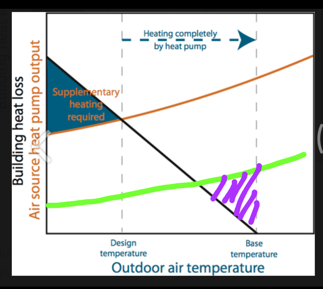

Beelbeebub Posted July 28, 2023 Author Posted July 28, 2023 Basically this diagram, where green is lower limit and purple the "cycling zone"

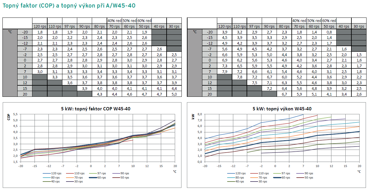

JamesPa Posted July 28, 2023 Posted July 28, 2023 (edited) On 28/07/2023 at 19:12, Beelbeebub said: But shouldn't we be taking the minimum at a higher temp? After all that is when you actually will need to modulate down. Expand Yes. The interesting figure (at least to me) is max at -2 (or whatever your design min is) vs min at (say) 12. Above (say) 12 you are going to be on-off heating anyway, or more likely daytime heating only which will help with the numbers. So with the graph you present above 6.5:2.2 (120rps @ -2 vs 30rps @ 12, about 3:1 which seems quite common for the better models (at least those that bother telling you). Of course if the pump is massively oversized much of the available modulation ratio will be used up at the lower end, which is where buffers come in with all the problems they bring, and right-sizing is preferable. Its a pity that there isn't a requirement to specify modulation ratio in a useful way. Edited July 28, 2023 by JamesPa

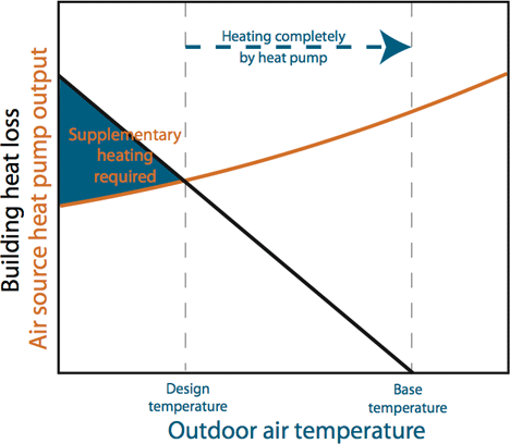

JohnMo Posted July 28, 2023 Posted July 28, 2023 Heat pumps are rated and sold to suit the supplier. They always produce loads of heat when it's warm, which diminishes as the OAT drops. This is why they (MCS and others) say size for 99.6% of the year. So you are not oversizing. Oversizing is never an issue when it's cold, but is an issue when it's normal winter temps sort of around 5 to 10 degs. You need way less heat, but your heat pump is producing way to much power even at min turn down.

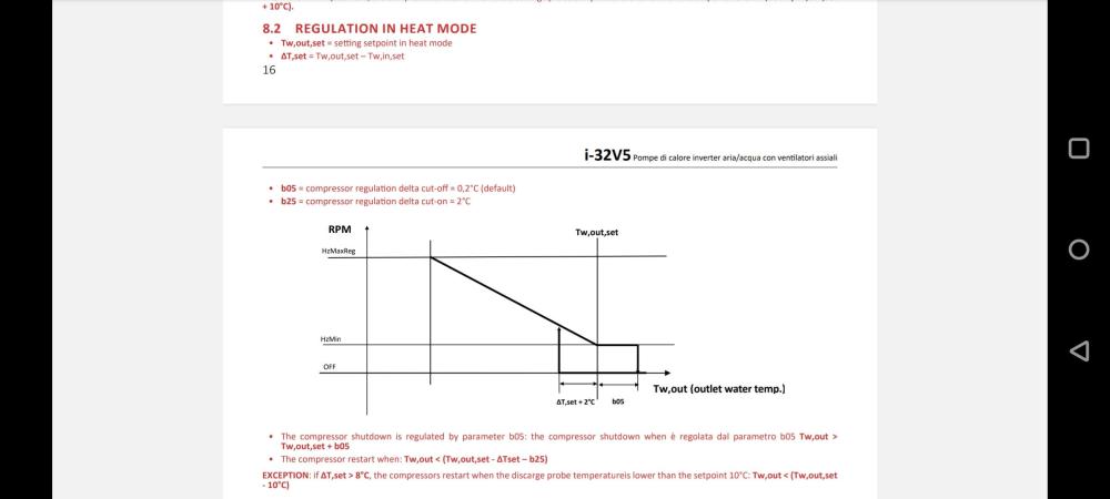

DanDee Posted July 29, 2023 Posted July 29, 2023 Did anyone looked into the fact that once the heat requirement is under the minimum output of the HP, it shouldn't be allowed to try and weather compensate, but just be controlled as a boiler, on a fixed low flow temp? This part of the automation seems to work great only when the output/requirement can match, for the rest of the time it just starts and stops every 5(random number) minutes.
