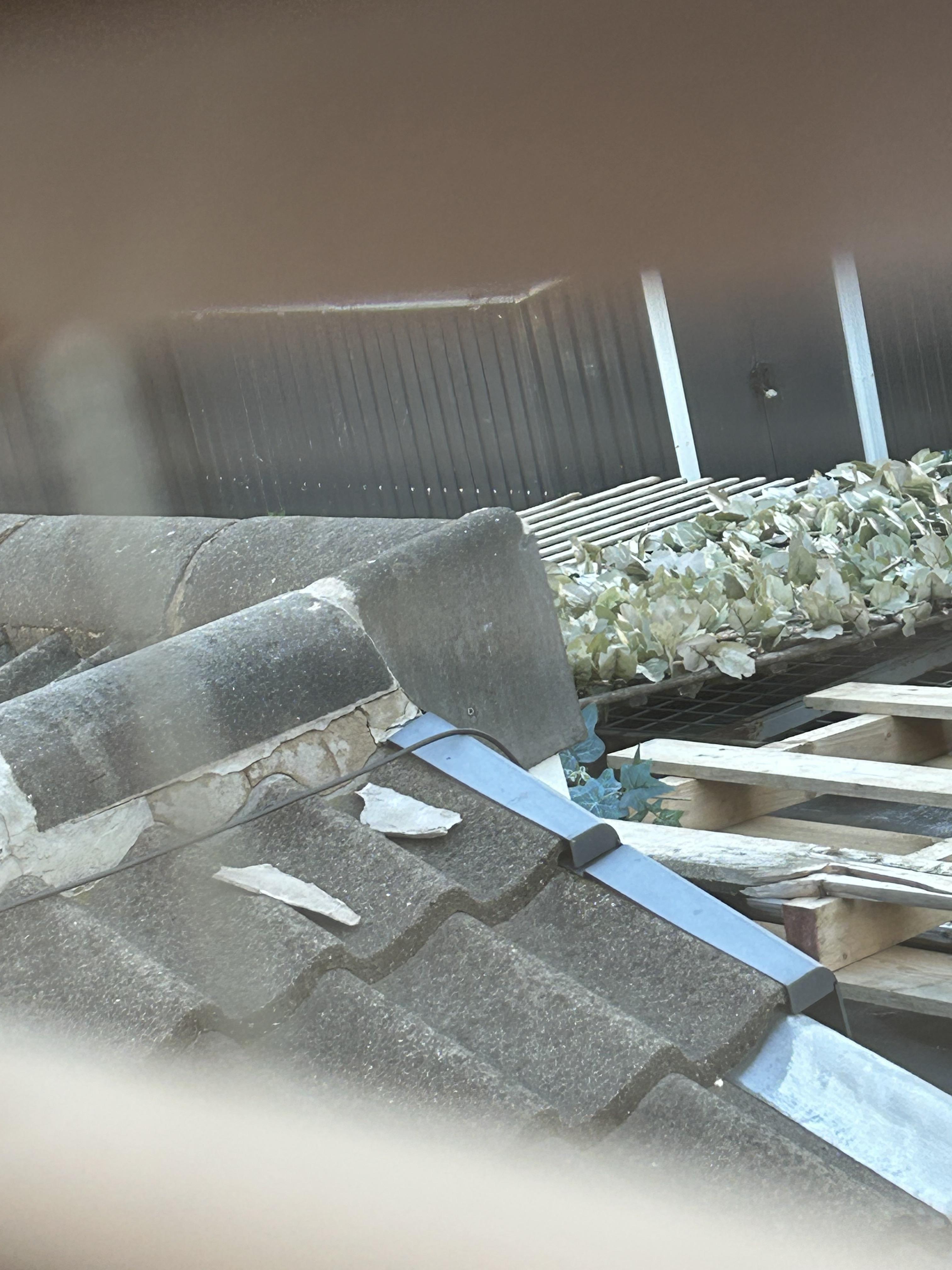

Help Posted July 12, 2023 Share Posted July 12, 2023 Can somebody advise on the extent of this damage please? Im sorry I don’t have the first clue about roofing but wondering what would need to be done to repair and what are the risks if left? thank you Link to comment Share on other sites More sharing options...
ProDave Posted July 12, 2023 Share Posted July 12, 2023 Can you post a clearer picture showing the context and what are you concerned about? I am not understanding what I see there, some roofing,some pallets and some unidentifiable material? Link to comment Share on other sites More sharing options...
Help Posted July 12, 2023 Author Share Posted July 12, 2023 26 minutes ago, ProDave said: Can you post a clearer picture showing the context and what are you concerned about? I am not understanding what I see there, some roofing,some pallets and some unidentifiable material? Sorry can do tomorrow. I am concerned about the area where it has chipped away leaving the area exposed Link to comment Share on other sites More sharing options...
TonyT Posted July 12, 2023 Share Posted July 12, 2023 Broken mortar on the ridge tile? Link to comment Share on other sites More sharing options...
markc Posted July 12, 2023 Share Posted July 12, 2023 25 minutes ago, Help said: Sorry can do tomorrow. I am concerned about the area where it has chipped away leaving the area exposed Where what has “chipped” away? If you mean the two flakes of cement then this is just a bit of over pointing Link to comment Share on other sites More sharing options...
twice round the block Posted July 13, 2023 Share Posted July 13, 2023 Someone jointed up the gaps between the ridge tiles at some stage and also pointed up the haunched sides where the ridge tiles meet the roof tiles. As this was a thin skim of mortar a tiny amount has now seperated. Nothing to worry about. 1 Link to comment Share on other sites More sharing options...
