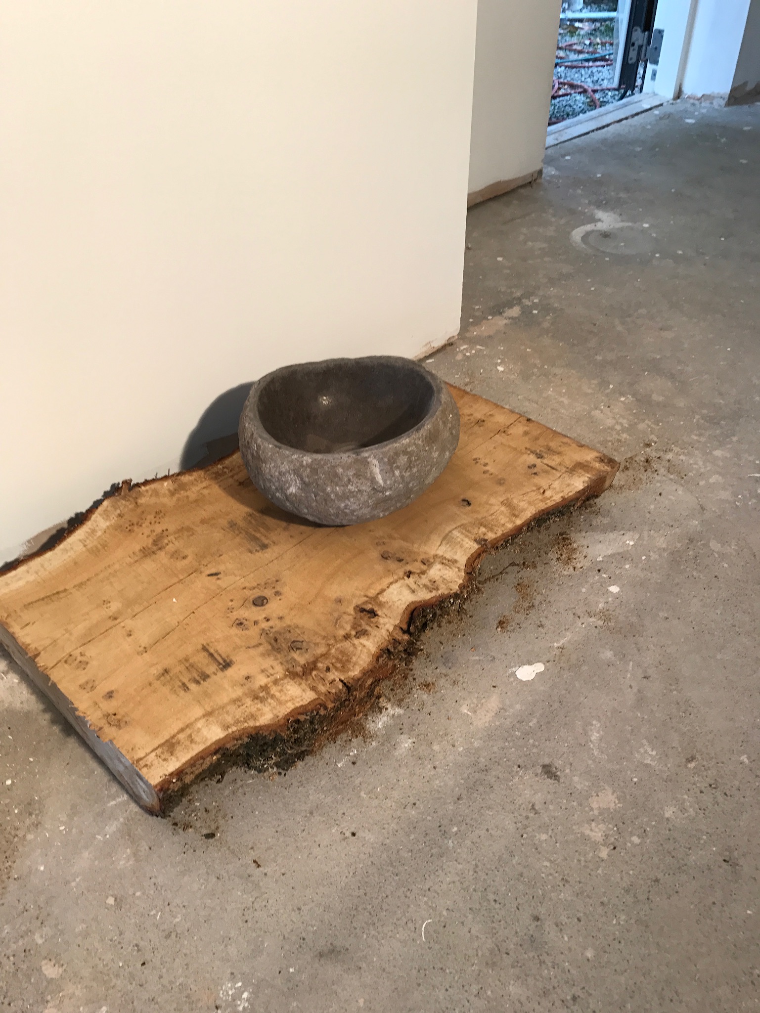

Lesgrandepotato Posted August 19, 2017 Share Posted August 19, 2017 So we have an under the stairs WC but it has no natural light. We are about to fit the stairs and I had a little google... seems we could fit a glazed panel into the floor and give a view down onto the sink and timber shelf as a cheeky little view point whilst not showing off the main event in the room. does anyone know anything about these? Seems to be 25.5mm think so just layed in on some mastic and carpeted round. Link to comment Share on other sites More sharing options...
Nickfromwales Posted August 19, 2017 Share Posted August 19, 2017 Maybe a lightly frosted one ? Sounds like a good idea to get some natural light, if there's enough available to make it worthwhile? Nice pic of some random wood and a bowl btw ? Link to comment Share on other sites More sharing options...
Lesgrandepotato Posted August 19, 2017 Author Share Posted August 19, 2017 That's the sink and shelf in under stairs khazi.. that's what I want to see through the floor... just needs a good tight sight line to make it work I think. WC is on the far wall here just behind the glazed facade. Should be light enough I hope! Link to comment Share on other sites More sharing options...
Nickfromwales Posted August 19, 2017 Share Posted August 19, 2017 Ah, the rustic look . A tin of yacht varnish over that should make it look a $million and make it waterproof. 1 Link to comment Share on other sites More sharing options...
