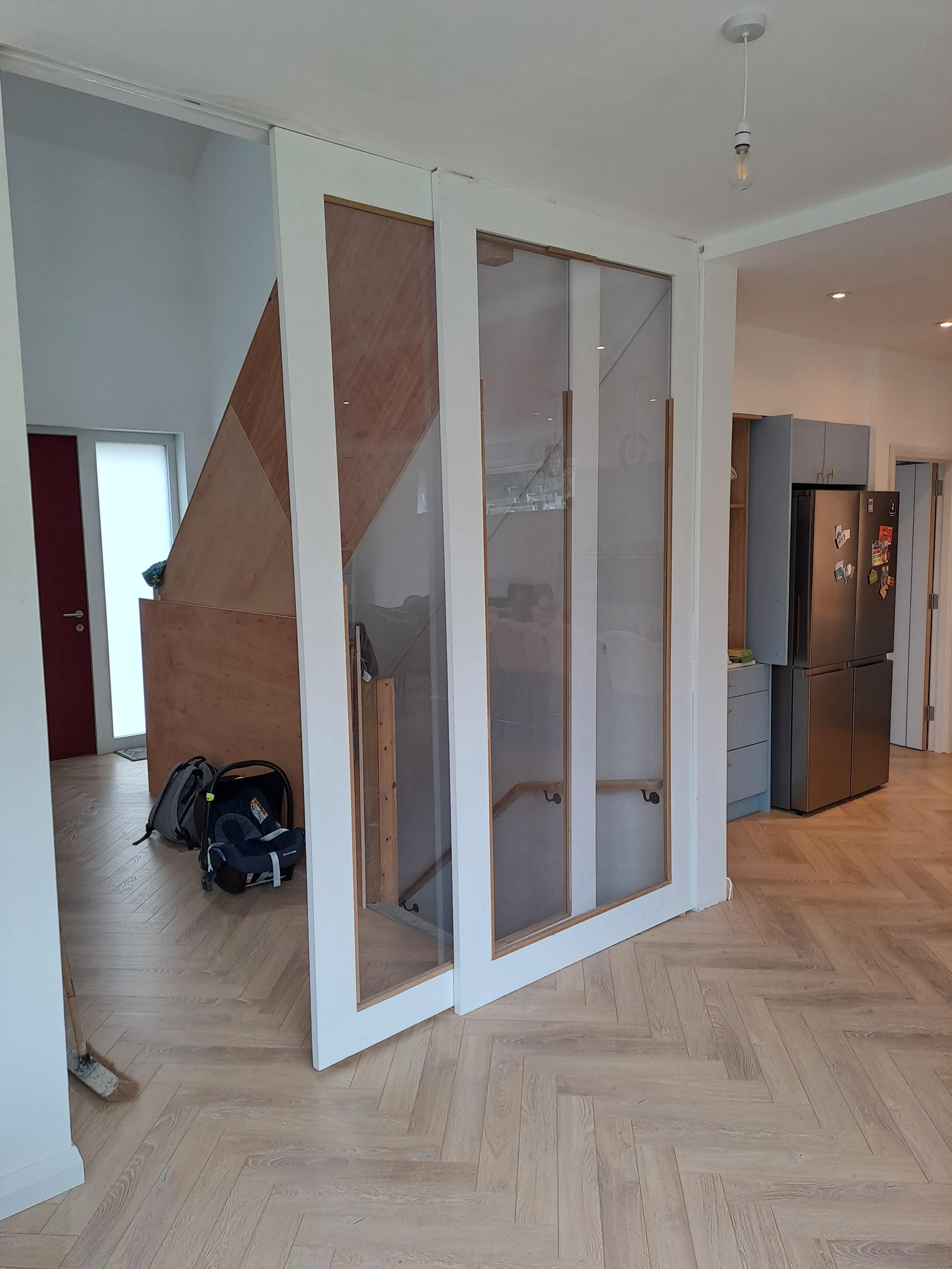

Conor Posted July 12, 2023 Posted July 12, 2023 14 hours ago, Sophiae said: Yes it’s an open plan. If it makes any difference there is no gas in the property. It’s all electric. I don’t have a TV or a kettle, it would be something to cook on and the oven, along with the fridge/freezer and washing machine. Other than that phone chargers and that’s about it I think. Only just noticed this. Effectively means you've no hallway and all that space is considered kitchen. All other rooms will need their own escape routes. Our design was very similar, so we put up internal sliding doors between the kitchen and hall to show kitchen closed off from rest of building. They are never closed 😀 1 1
Sophiae Posted July 12, 2023 Author Posted July 12, 2023 2 hours ago, Conor said: Only just noticed this. Effectively means you've no hallway and all that space is considered kitchen. All other rooms will need their own escape routes. Our design was very similar, so we put up internal sliding doors between the kitchen and hall to show kitchen closed off from rest of building. They are never closed 😀 Any chance you have a picture to show me?
Conor Posted July 14, 2023 Posted July 14, 2023 On 12/07/2023 at 11:25, Sophiae said: Any chance you have a picture to show me? Obviously not finished. One panel fixed, other is a top hung slider. Rarely closed.
